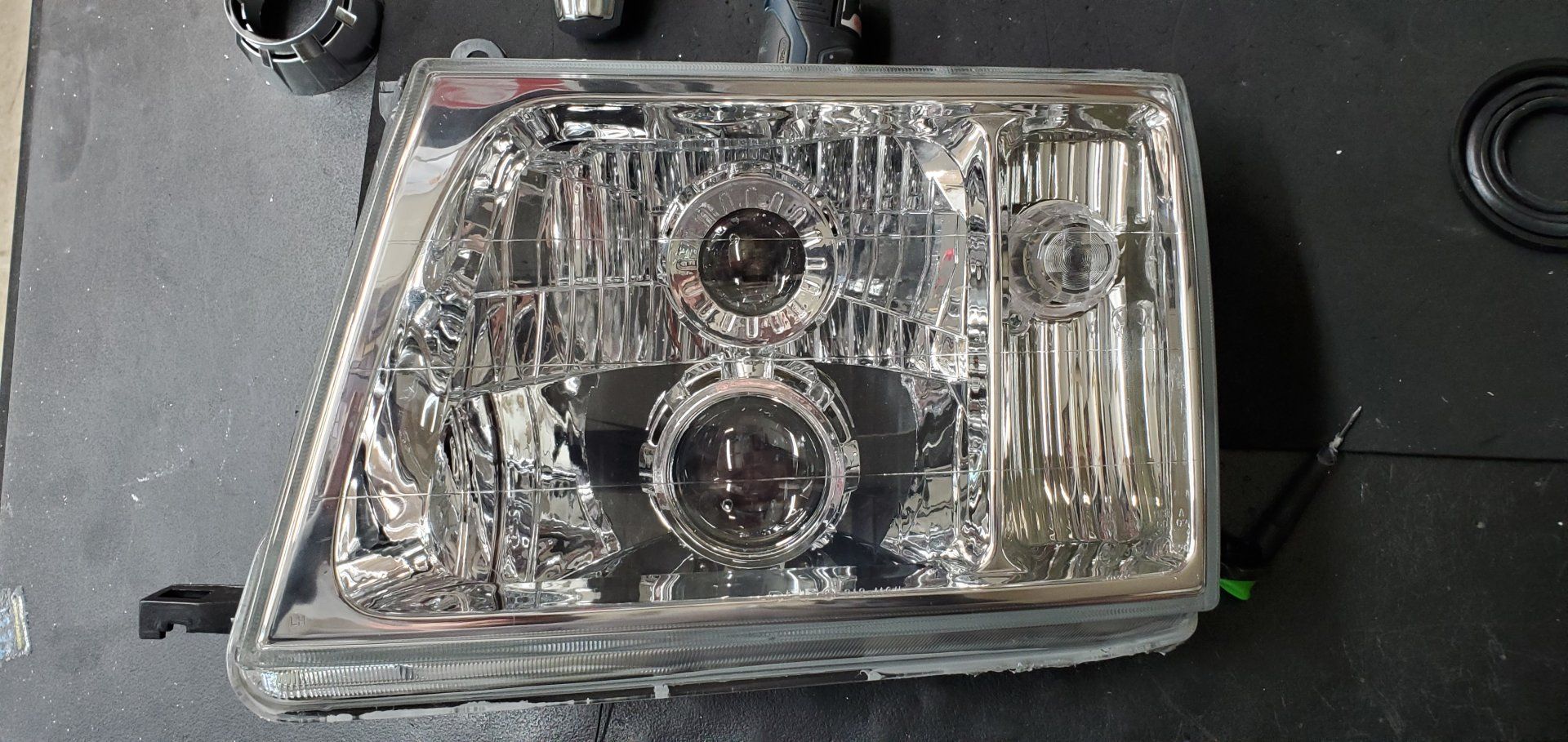

Alright- went with a quad projector setup as well. The reason I didn't go with the one piece light is because I think it looks out of sorts on the 1998-2002 models and I wanted it to look OEM as possible. Plus I like having glass lenses rather than plastic. The bottom projector is a lo and hi beam bi-xenon, and the upper projector will be an additional hi beam. I am not running DRL's.
I've got 2 chips on glass headlights during 4 years of ownership, not sure glass is the best choice because of that. Otherwise looks cleaner than plastic

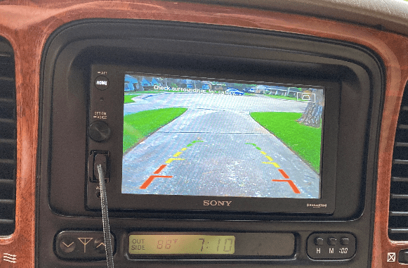

I was getting annoyed with our one 100 series without a backup camera, so I finally got around to getting the backup camera installed in the old LX.
Installed one of these, that is supposed to be made specifically for a 100 series :
It seems that the 100 series license plate light openings are smaller in China, the Chinesium shrinks in transit, or their rulers are mis-marked, because the fit into the lift gate was "sloppy" (read hanging on by a thread). I added a little VHB tape, and it's probably not coming out any time soon.
I was disappointed with the fit, but otherwise it is working just fine with the recently installed Sony headunit.

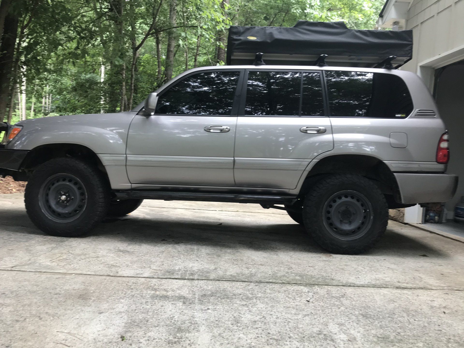

Shout out to my man @Wermz who installed my Ironman Foam Cell Pro lift. Took some sorting and tweaking, had to get the proper springs. The Ironman 0-440 were too wimpy so we put in some 2863’s I had in the garage. Also got a little crazy and put in some 30mm coil spring spacers, Dobinson UCA’s, OEM CV’s, 555 ball joints, extended sway bar links, sway bar bushings and other stuff I’m forgetting.
The truck rides awesome, better than it ever has. #BigCityOffroad

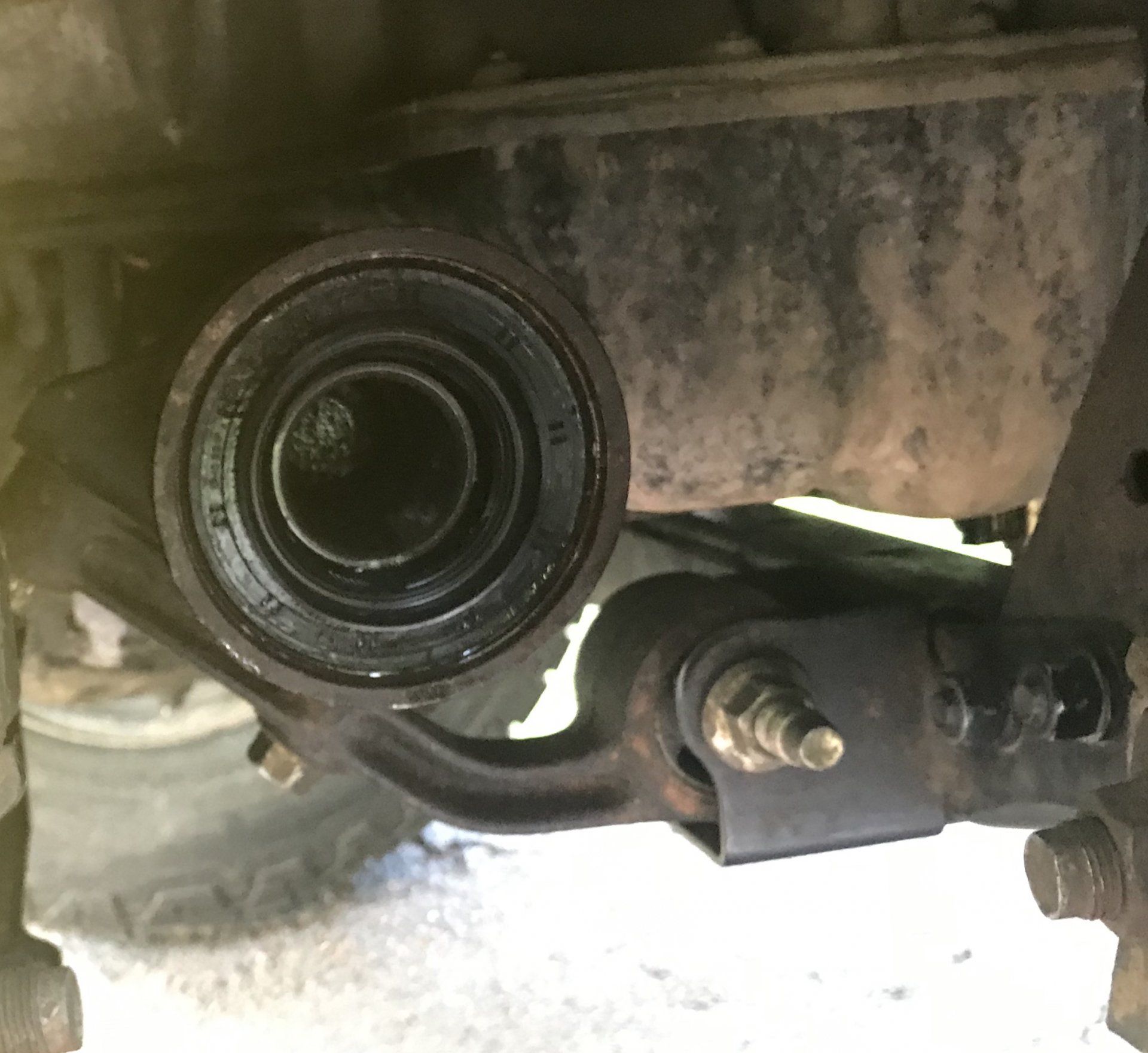

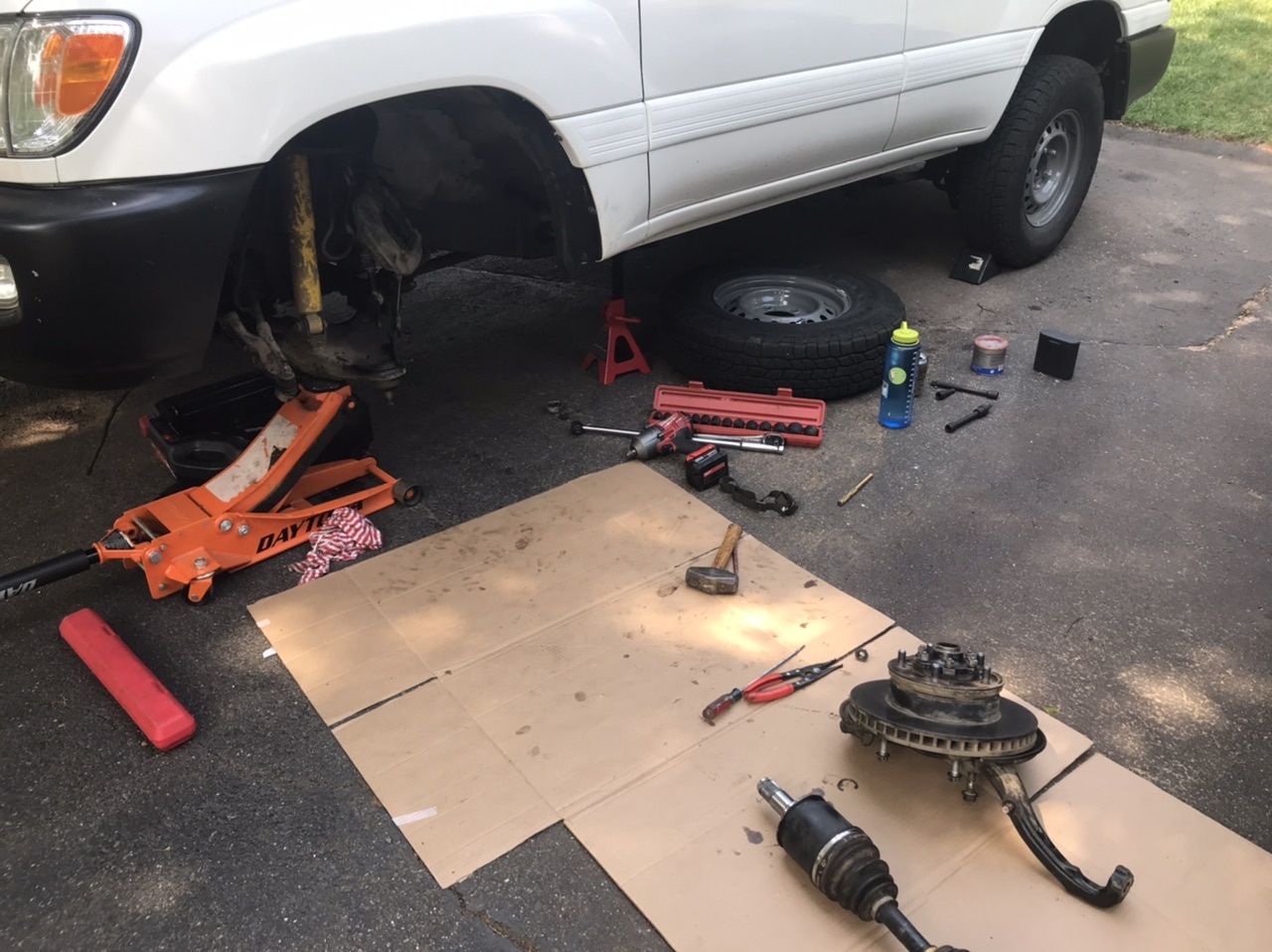

Replaced the driver’s side axle seal....which I just replaced but apparently got whopper-jawed or damaged in the process of putting it in too far and then trying to pull it out without hurting it....
Getting pretty good at pulling the knuckle and axles...
Hoping this one is leak free!
