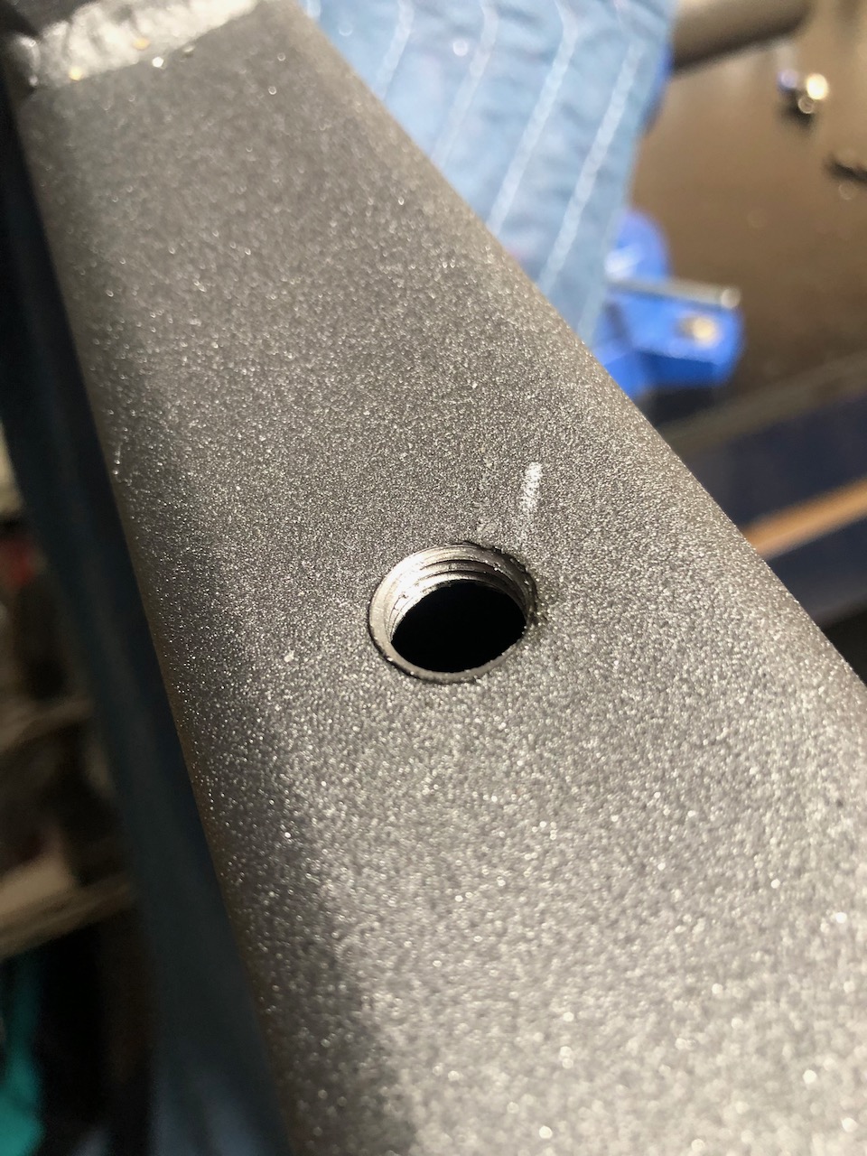

Drilled and tapped

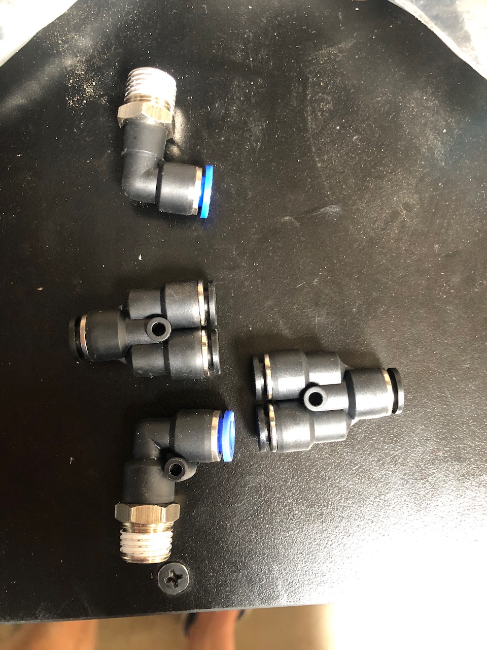

Mapped out the air line plan using bits from Amazon...front of vehicle and compressor/coupler to the right of the picture, slider "air tanks" at top and bottom, line out to rear 1 gallon tank and additional coupler to the left

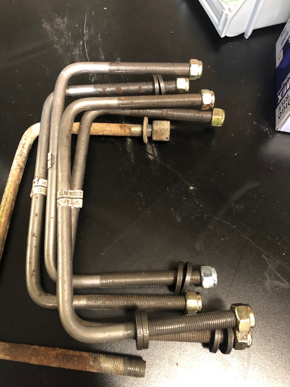

Incidentally, had to hack off a few of the old u-bolts to remove the sliders, so had a local spring shop make up some replacements.
