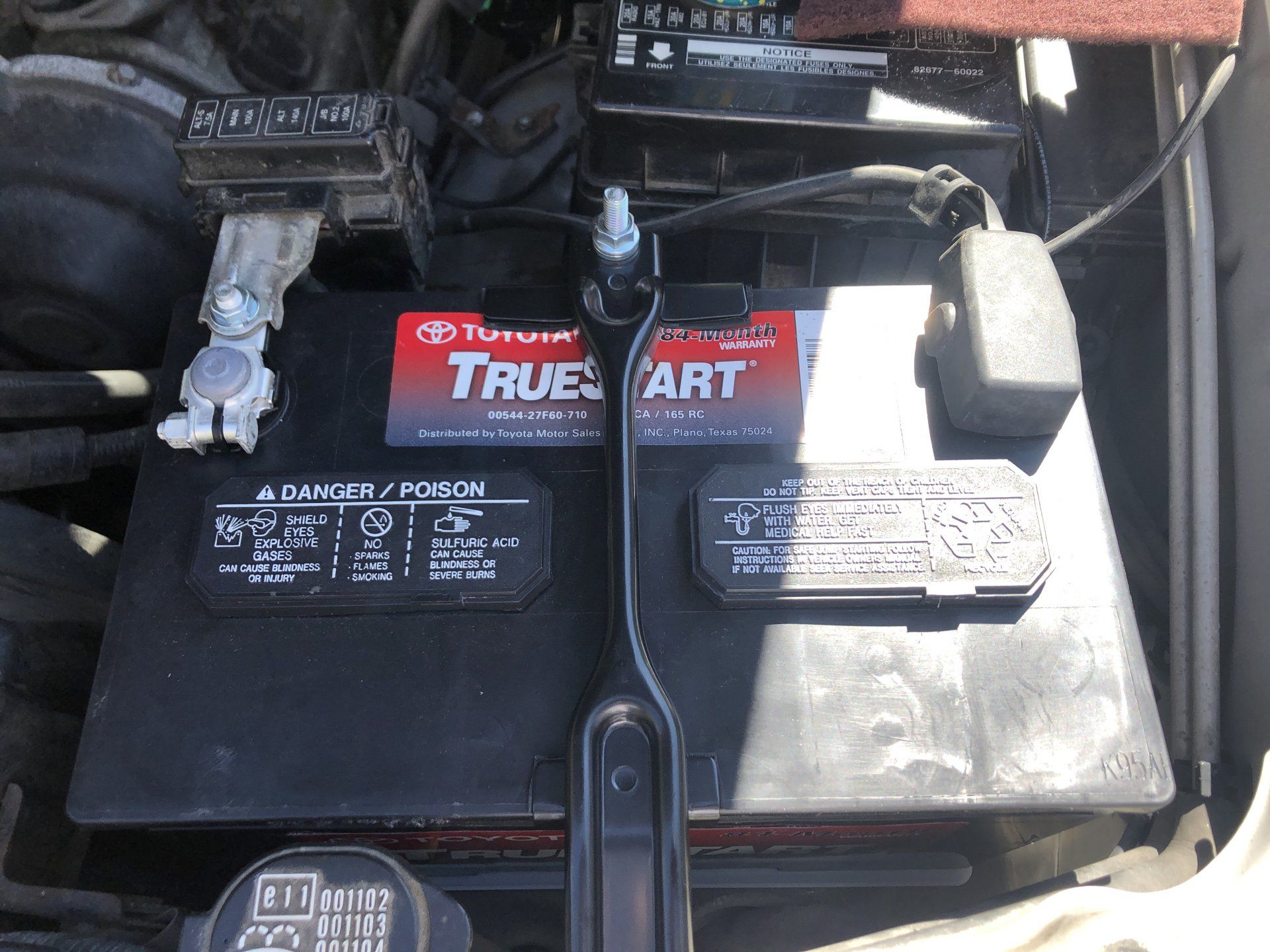

Now the fun part. I went to back it off of this pad and it started fine, rolled about 15 feet back ( and up an incline) and it stalled. Turns over, but will not start.
I thought weak battery so I replaced.

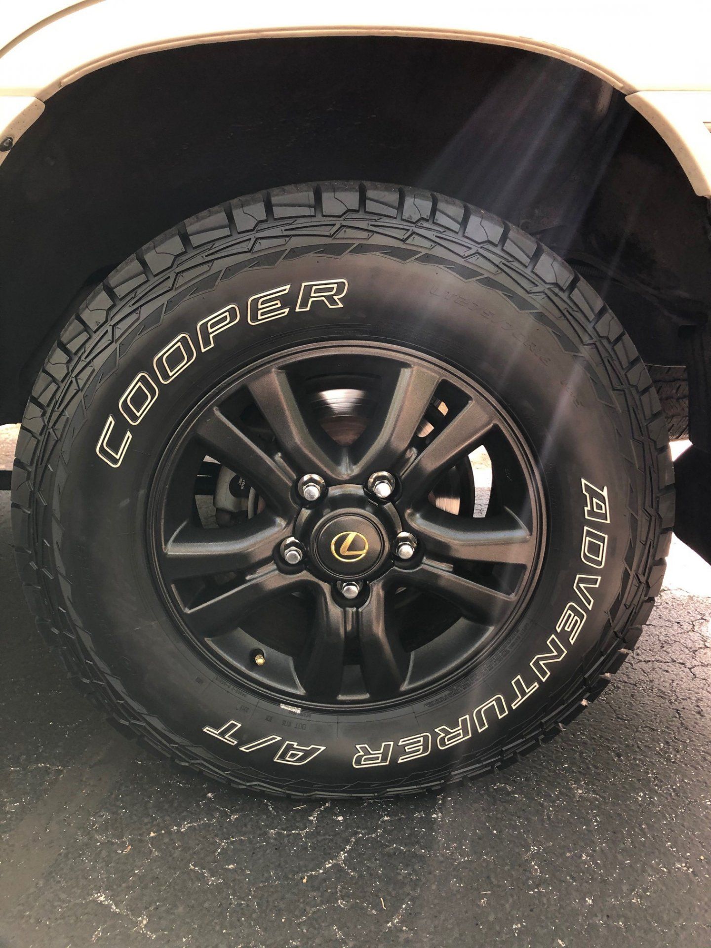

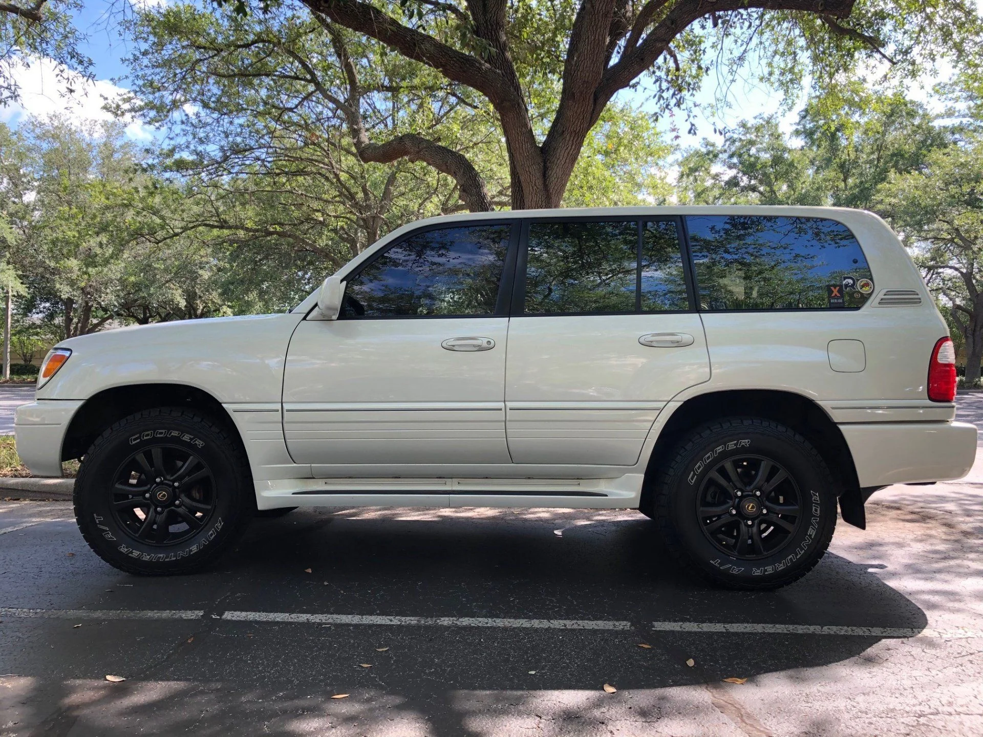

Those black rhino wheels looks sick!!! Debating if I really want to deal with buying the oem Steelies and deal with getting them powder coated or just scoop these

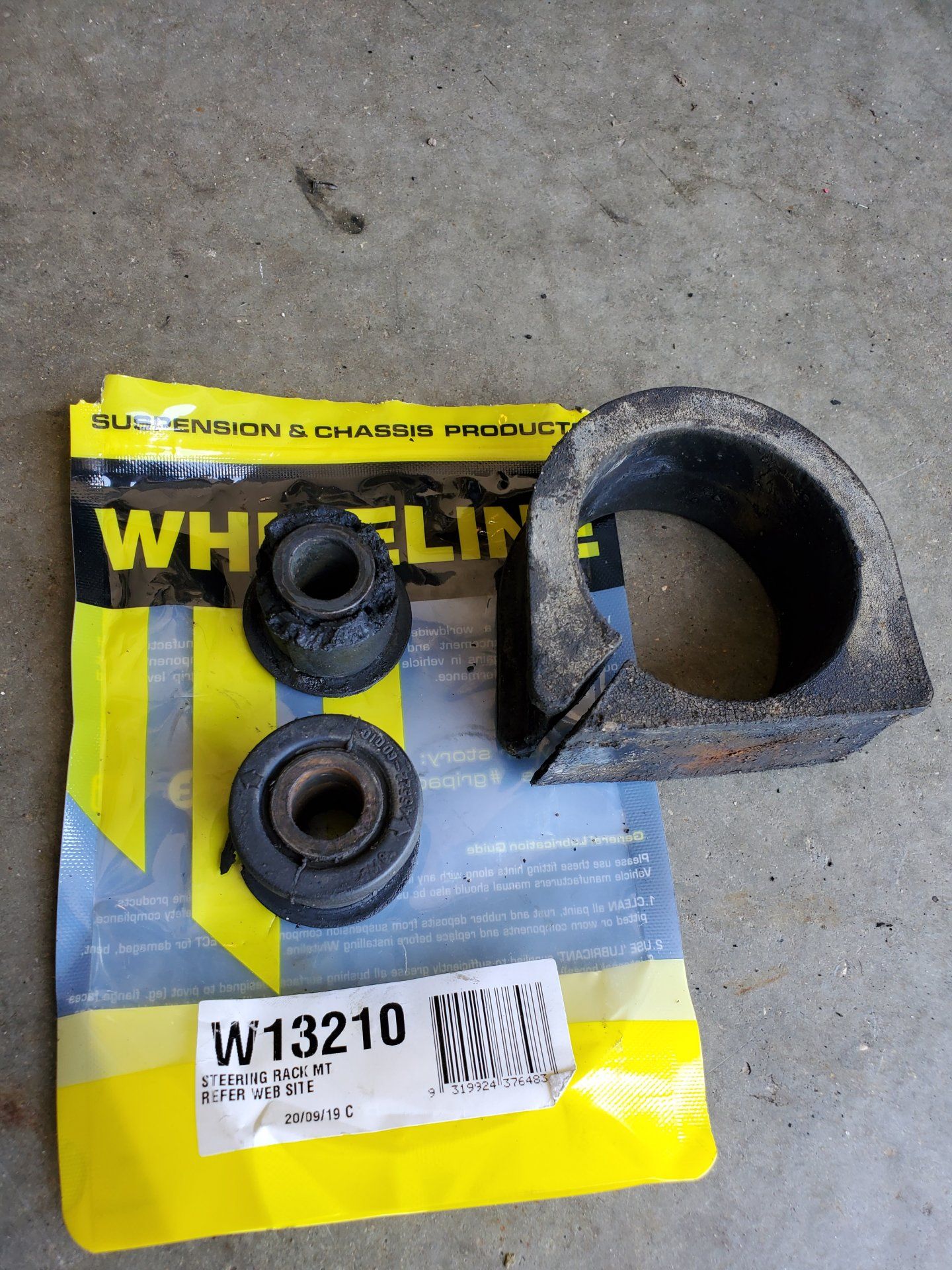

Finally replaced the steering rack bushings with Whiteline polyurethane ones. 260K miles and the rear bushing was still mostly ok. The big D bushing was compressed but still in one piece. The front small bushing was positively knackered. It was allowing the steering rack to move about and was the source of my clunk every time I came to full stop. A short test drive confirmed that steering is much more firm (no more meandering) and clunk is gone!
Thanks @Pucker5 , I have been happy with them. I like the spacing and the black and gunmetal tie nicely with the body and trim. They are heavy, but so are steelies.

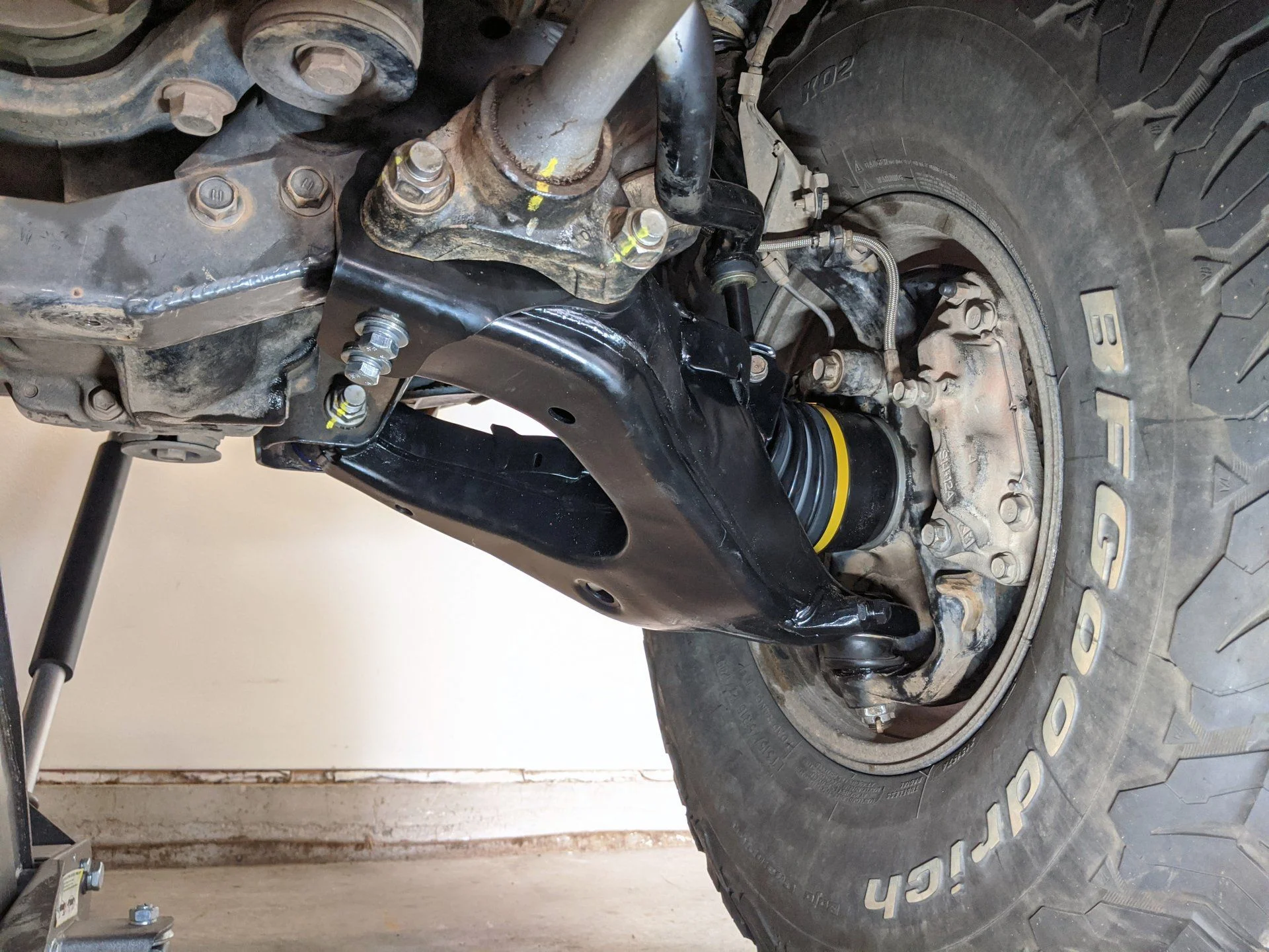

Progress! Got the new bushings in, axle in and everything reassembled and torqued to spec. That was a lot of work! Its going to be rainy the next few days, so I'm going to take my time working on the driver's side.
The hardest part of reassembling everything was getting the LCA connected to the frame. The new poly bushings are very tough and I had to coax the arm into its correct position with a second floor jack with a few 2x4s stacked on it. Getting the new axle in was quite easy; I used the 2x4/hammer method to seat the inboard c-clip, then gave it a good solid shove with my hands and it popped right in. Putting the knuckle into the axle and upper/lower ball joints was a pain just due to how heavy everything is.

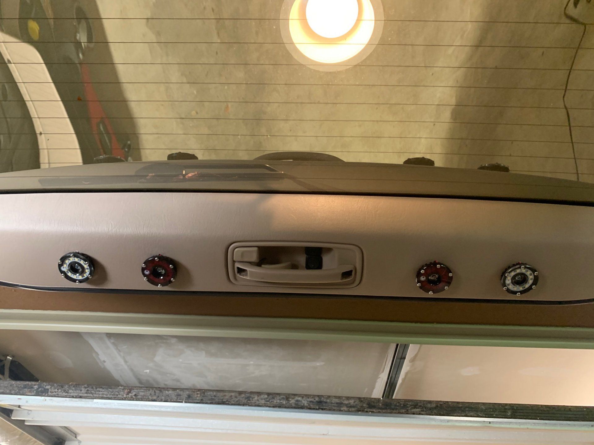

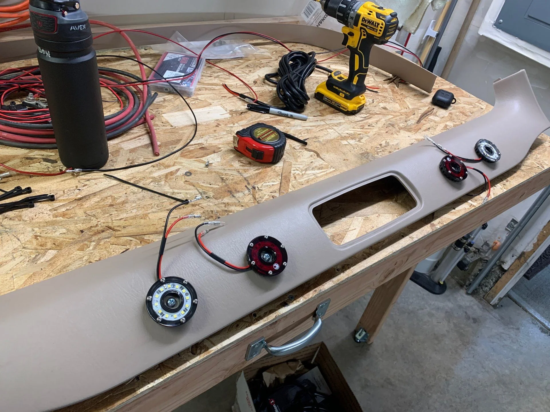

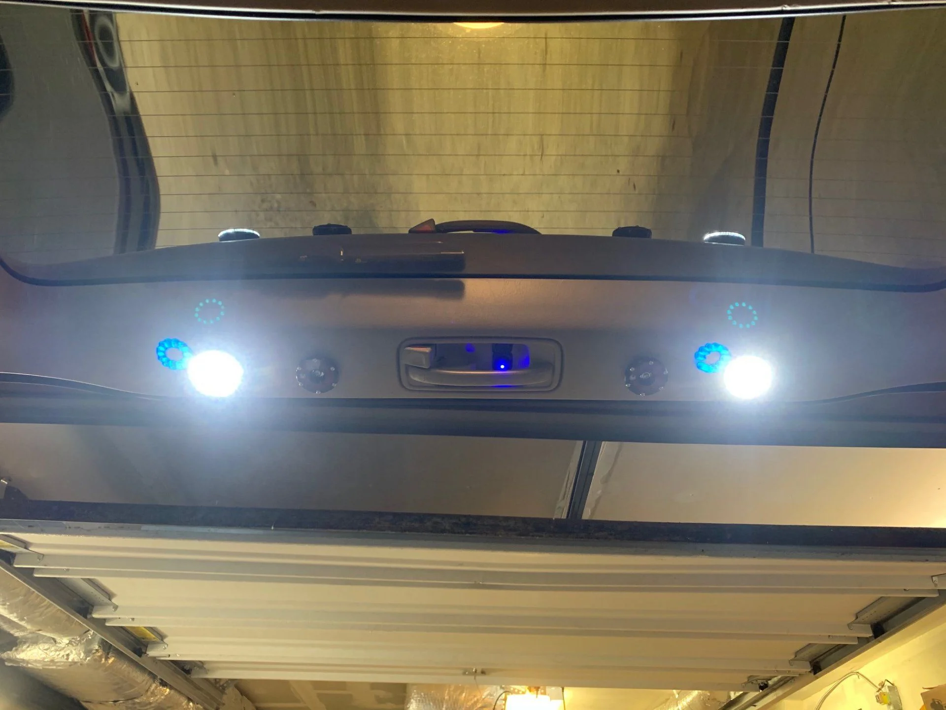

Installed some additional lighting on the rear hatch to see in to the rear cargo area and tailgate.

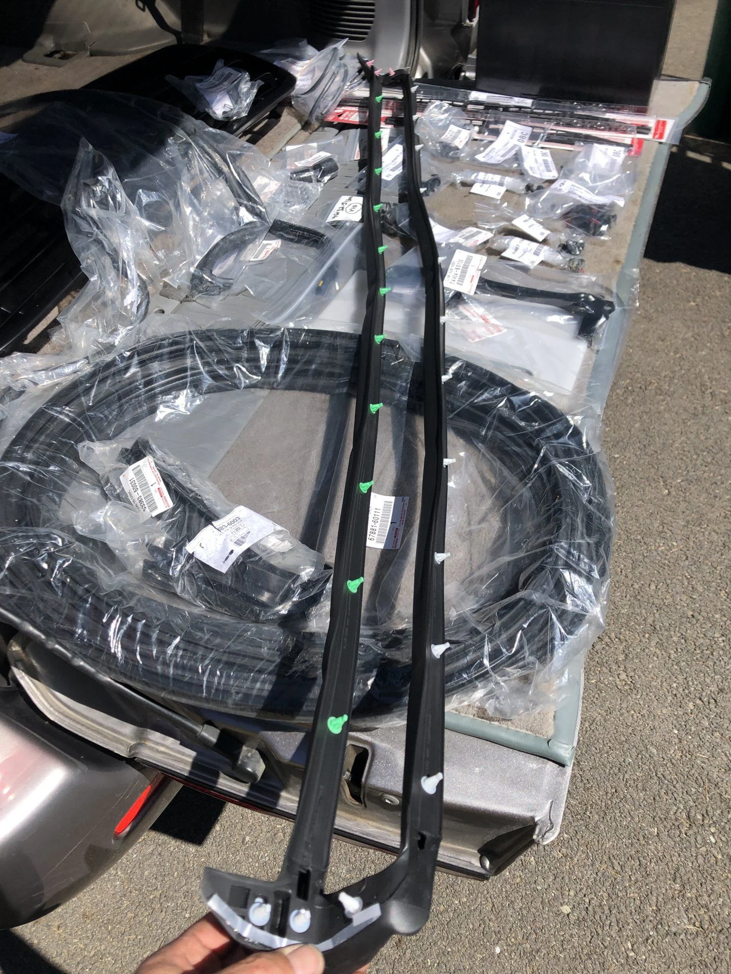

I priced out some door surround foam once and that stuff was close to the price of gold. You’ve got quite the investment there.

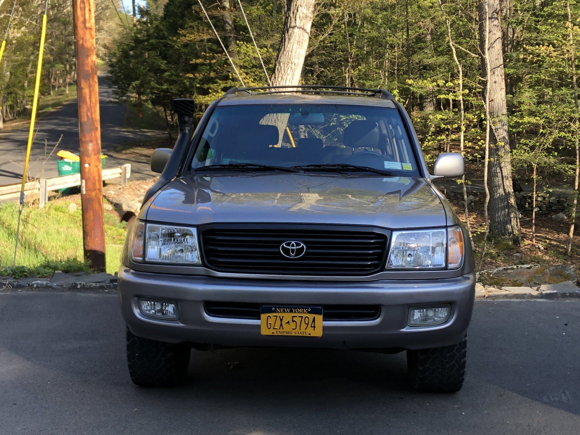

Best mod so far is clearly the snorkel... 😜
I’m really interested to see if you’ll go 285 or 295 on those 16’s that are crossing the country. Come on 295s... Toyo makes them!... AT3s?

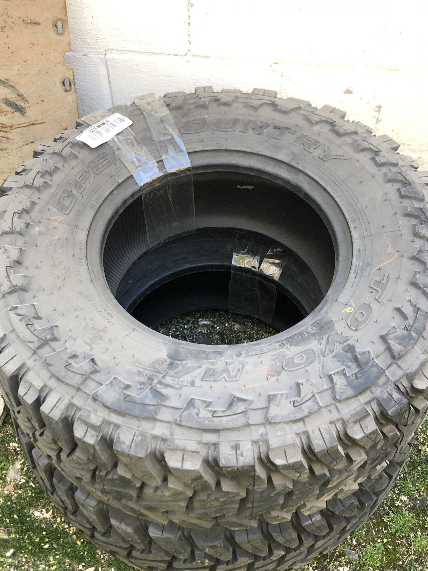

She’s getting new Toyo MTs.
