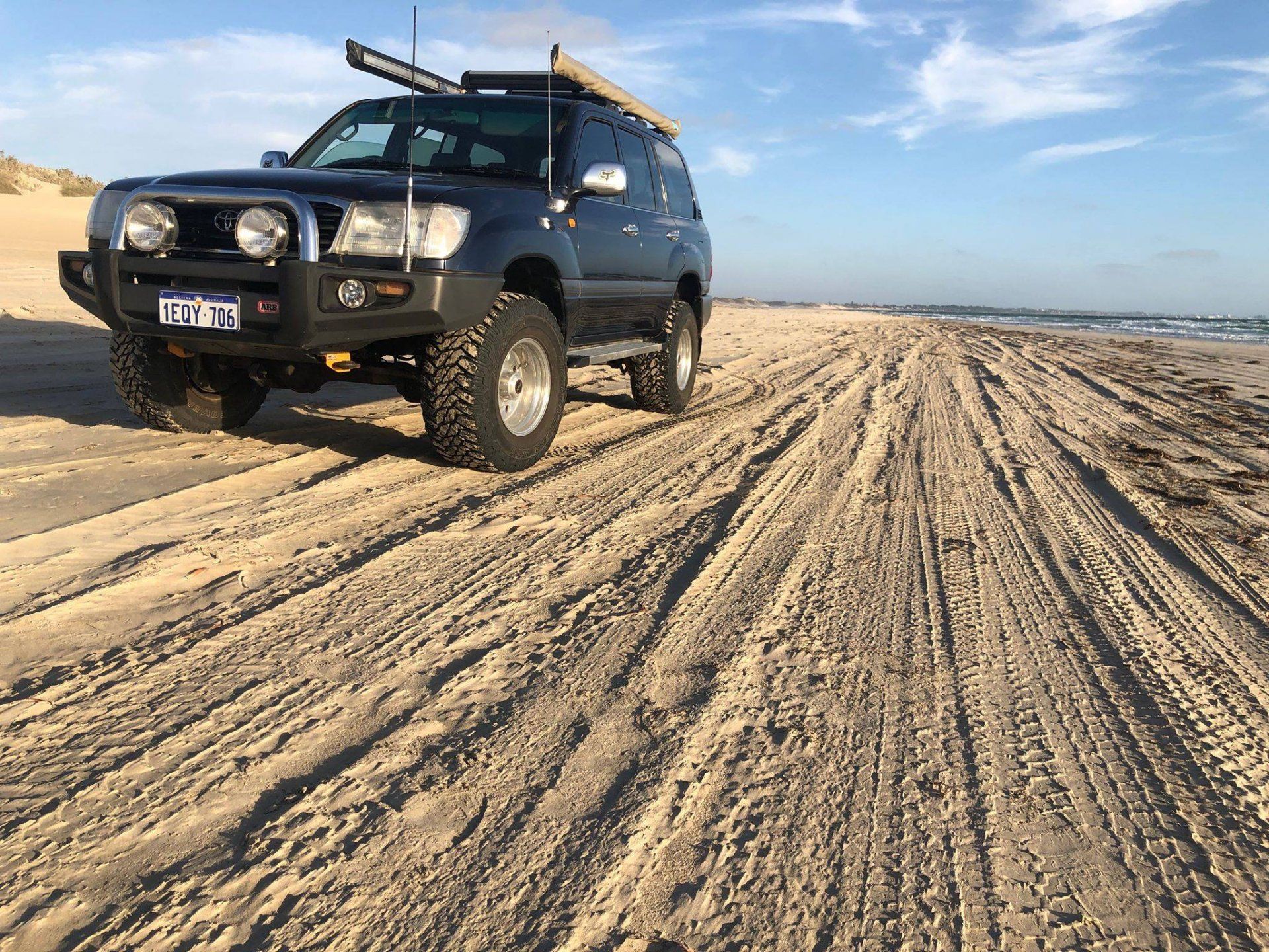

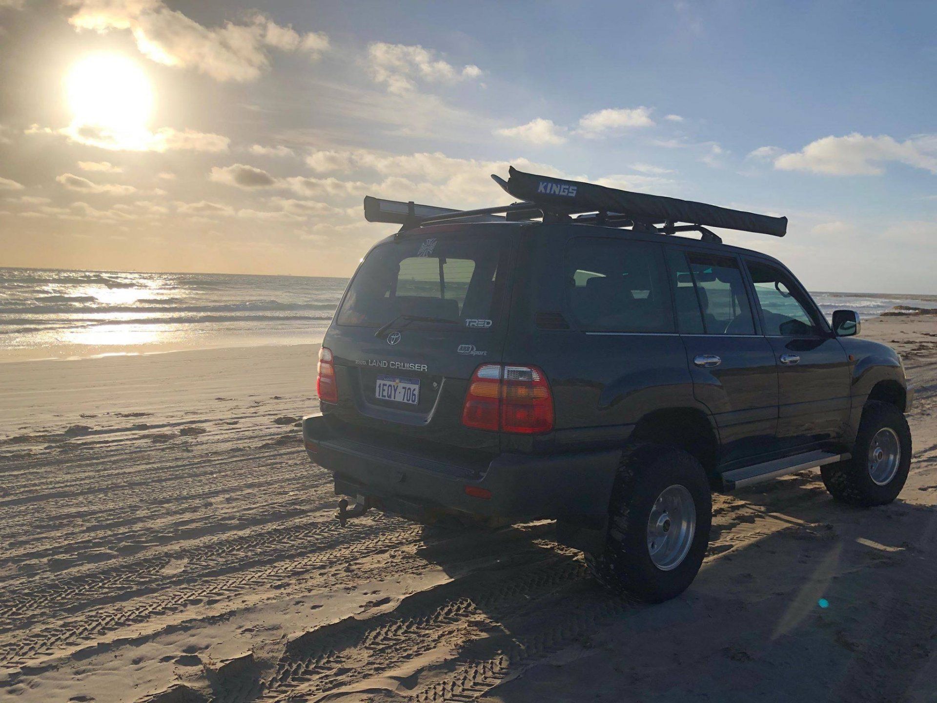

Getting 315/75/16 's Cooper SST PRO's but paranoid they wont fit. Currently it has 305/70/16 's . so 33 inch to 35 inch I think
Currently has about 2 1/2 inch lift and is a FZJ105R front live axle. So thinking I will be ok for clearance. :)
Feel free to comment if you have done this already on this setup. 80 series has similar front setup
Here's the difference on a tire size calculator.
Cheers for reply. Yeah looked at that , looked at an Australian version of that comparison tool also. Also looked at speedometre differences compared to stock.
Below are pics of the current (older) Cooper SST PRO 305/70/16 's
I made the quick measurements around the tyre and I think I will be fine. If not it will be very close. SPrings in front look to be the only thing to be in the way, but I take it a normal turn would never turn that far anyway,
Works out as 23 mm diameter and 5mm each side width. Even with the 305/70/16 currently bald I think it will be fine. Will add pics to here after its done Tuesday morning. Maybe it will help someone else with similar mod/s going up a size.

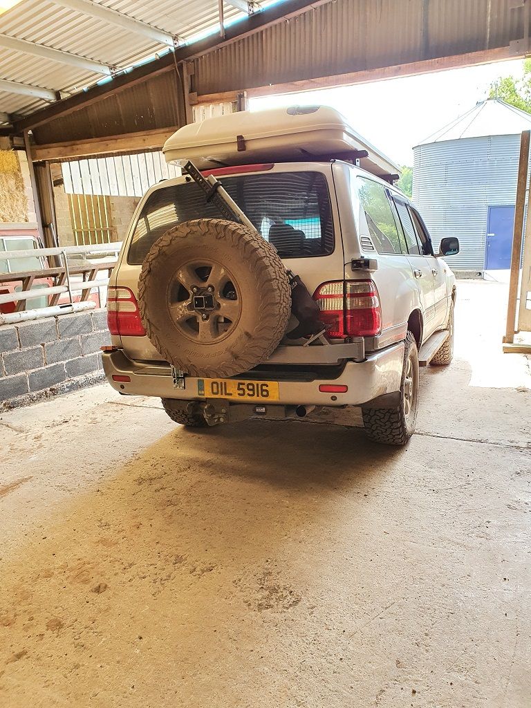

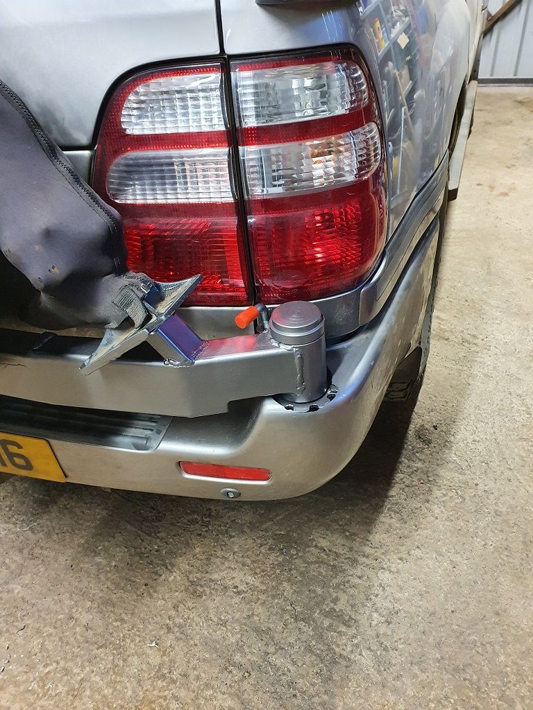

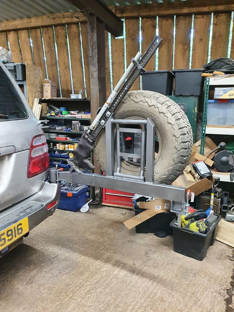

I made a pretty substantial support piece under the bumper cover for the pivot to mount to. It's a tight space to get something rigid enough into.
Wild! The finished product looks amazing! You should sell this!
You’re gonna love the 315 width aired down on the sand. Post a pic when installed
Can't wait until tommorrow . Might take em down the beach for the pics :)
