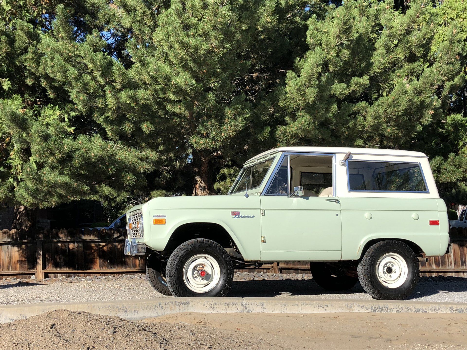

Ha! I didn’t see that in the background until after posting. Truthfully, the LC doesn’t see much garage time bc of the Bronco(s). It’s a ‘71 I bought off the original owner 3.5yrs ago. Original paint, originally sold in town, 110k miles now, and upgraded to era correct disc brakes and PS (current project).View attachment 2288487View attachment 2288488
She is a beauty, you're a lucky man. Love those things.

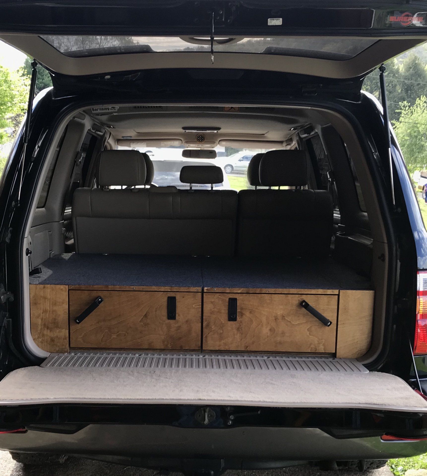

My cargo drawer/sleep platform is 99% finished. Just need to decide on a trim piece for the top edge and attach the rear flaps to bridge the gap between the box and seats when folded. If I'd known how nice it was going to look as is, I'd taken better care fitting the face trim above the drawers. Overall I'm super pleased with the finished (almost) product.
Plenty of room for tool bag and jumper cables. Each drawer is 36"x18x8.25".

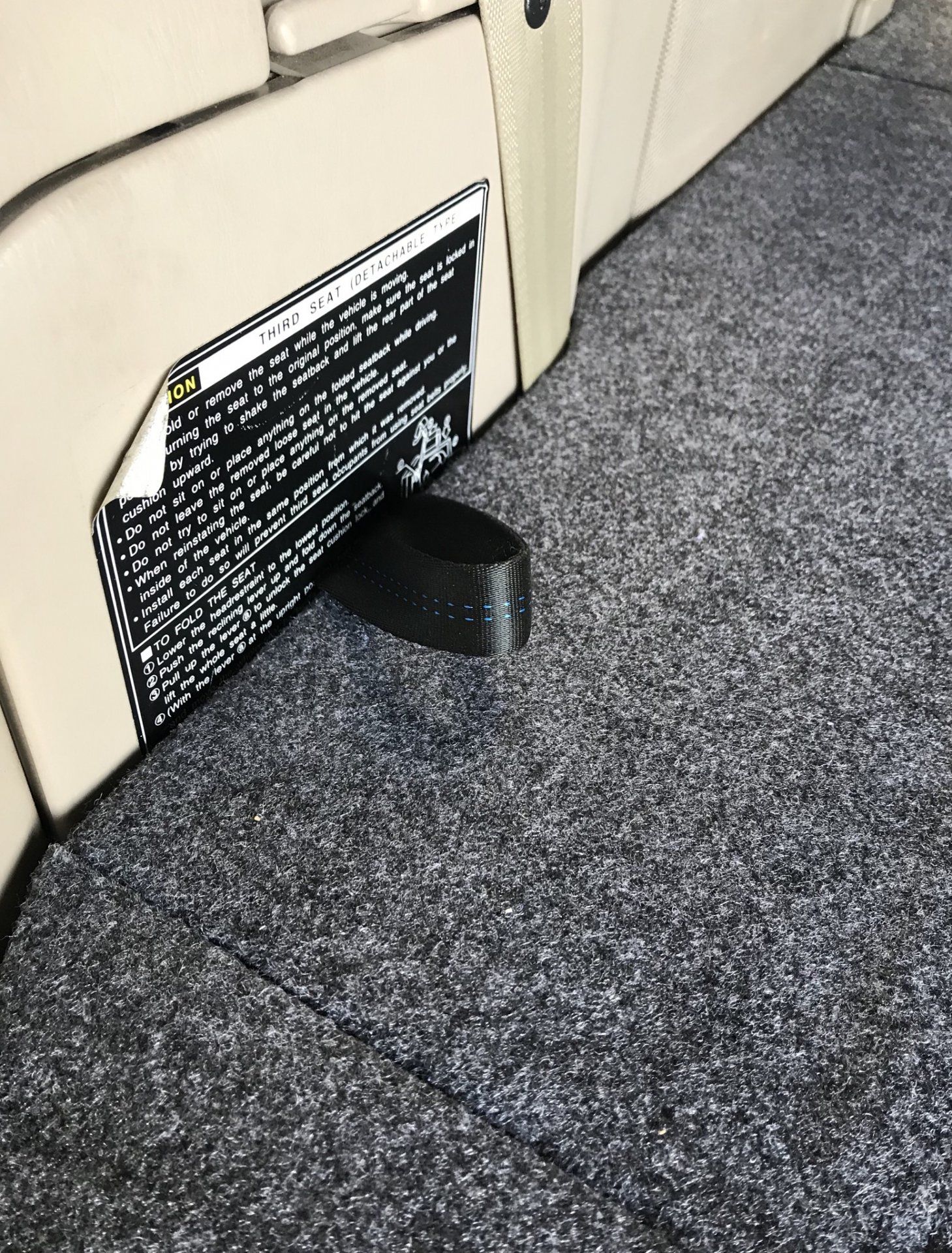

Used some old climbing runner material as pulls for the side wings.

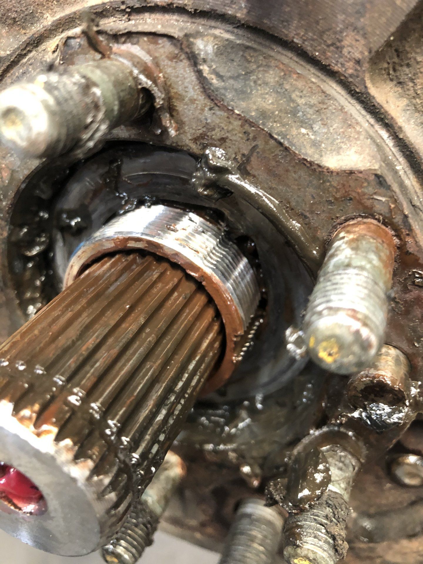

I finally got around to replacing my rack bushings with WhiteLine bushings. Can say the steering is noticeably firmer. Also, while we’re slow at work, I was able to put the cruiser on a rack and tackle the front wheel bearings. All I can say is that I’m highly disappointed in the previous repair made prior to my ownership. The lock washer on the drivers side was put on incorrectly, and the passenger side was completely loose. Silicone was used in place of a drive flange gasket, leaving the cone wedges stuck more so than normal. Thankfully Cruiser Outfitters has everything I needed.

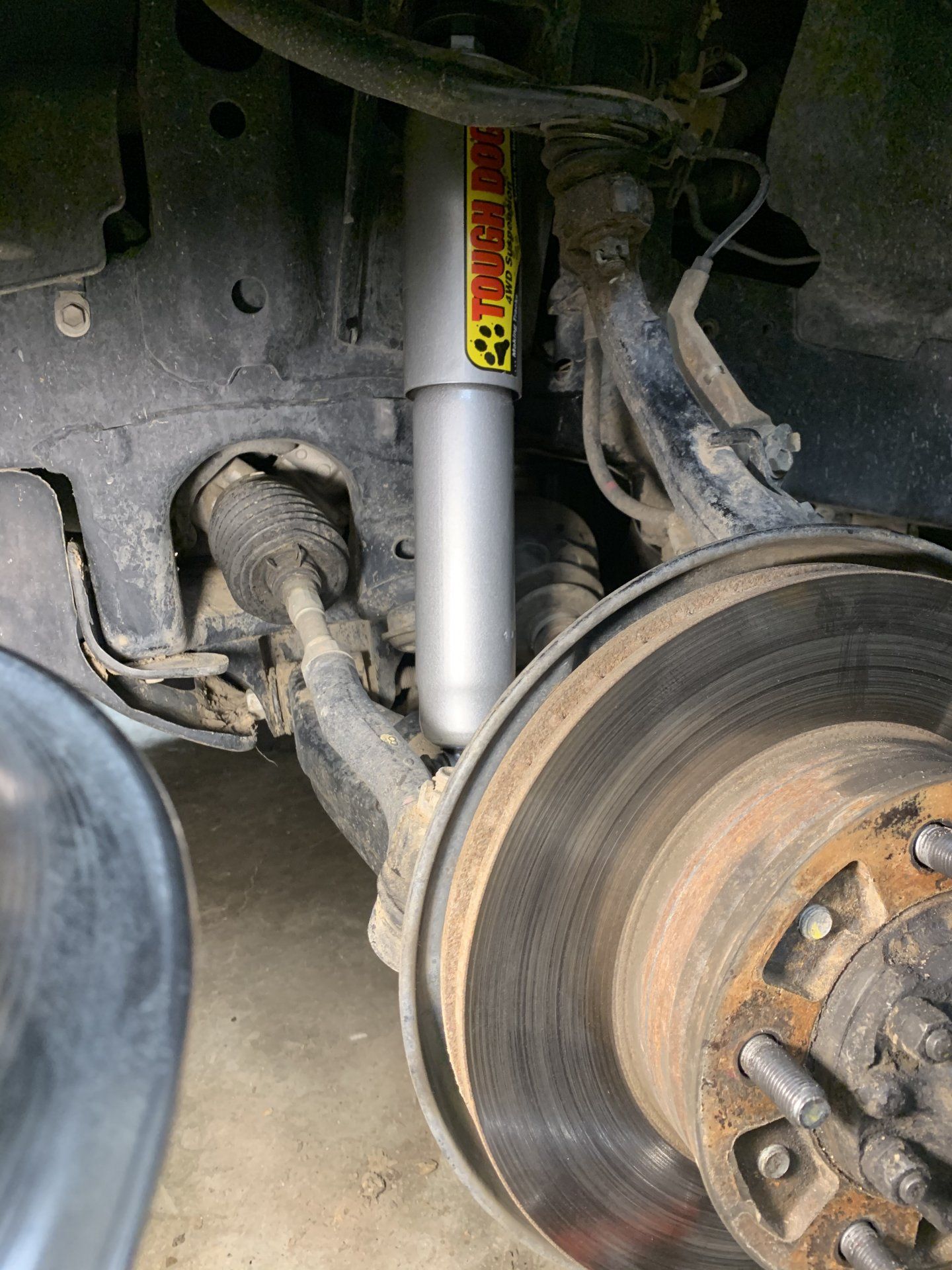

Picked up my Ironman lift kit... have everything I need to complete my suspension. Before I start installing everything, does anyone have any experience with failing tie rod ends? What are the symptoms? Doing the ball joints and don't want to miss anything.

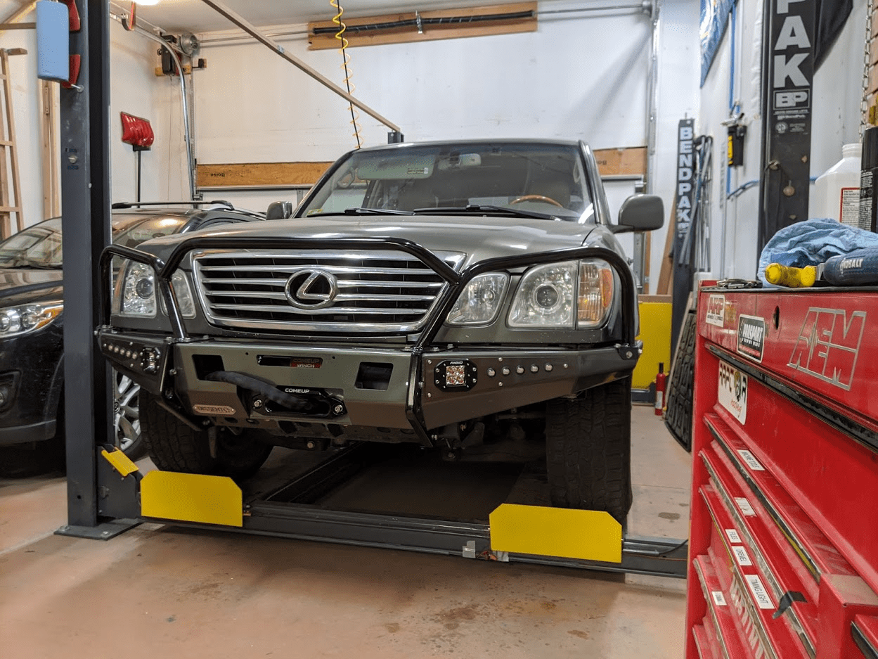

After watching some Plasti dip videos, I'm considering using regular spray paint. Lots of curves and grooves on the grill so I used lots of tape. Tape must be pulled while Plasti dip is wet, or else it will tear off.
Or I might use a razor blade to cut the edges before I peel. Anyone try that?
Actually, my plastidip peeled fine without any razor blade action, and after the product has dried. Separated perfectly and predictably at the transition between trim and paint. Almost like magic.
That said, skipping the glossifier was probably a bad move on my part, as it has not held up well on the chrome on my LX470 grill. I'll be removing it to recoat with paint.
