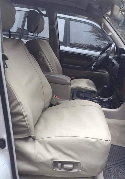

Installed a set of SOR Tuff Duck seat covers in the front row of our old LX.
Comparing the to the SOR Tuff Duck seat covers, to the Wet Okole seat covers, that we installed about 2.5 years ago in my son's vehicle.
The Tuff Duck covers:​
Were a much easier install.​
Are a less "tailored" fit and less visually appealing than the Wet Okole.​
Feel more comfortable to me, than the neoprene of the Wet Okole.​
I like the look. I am considering these since I am not particularly crazy about leather.

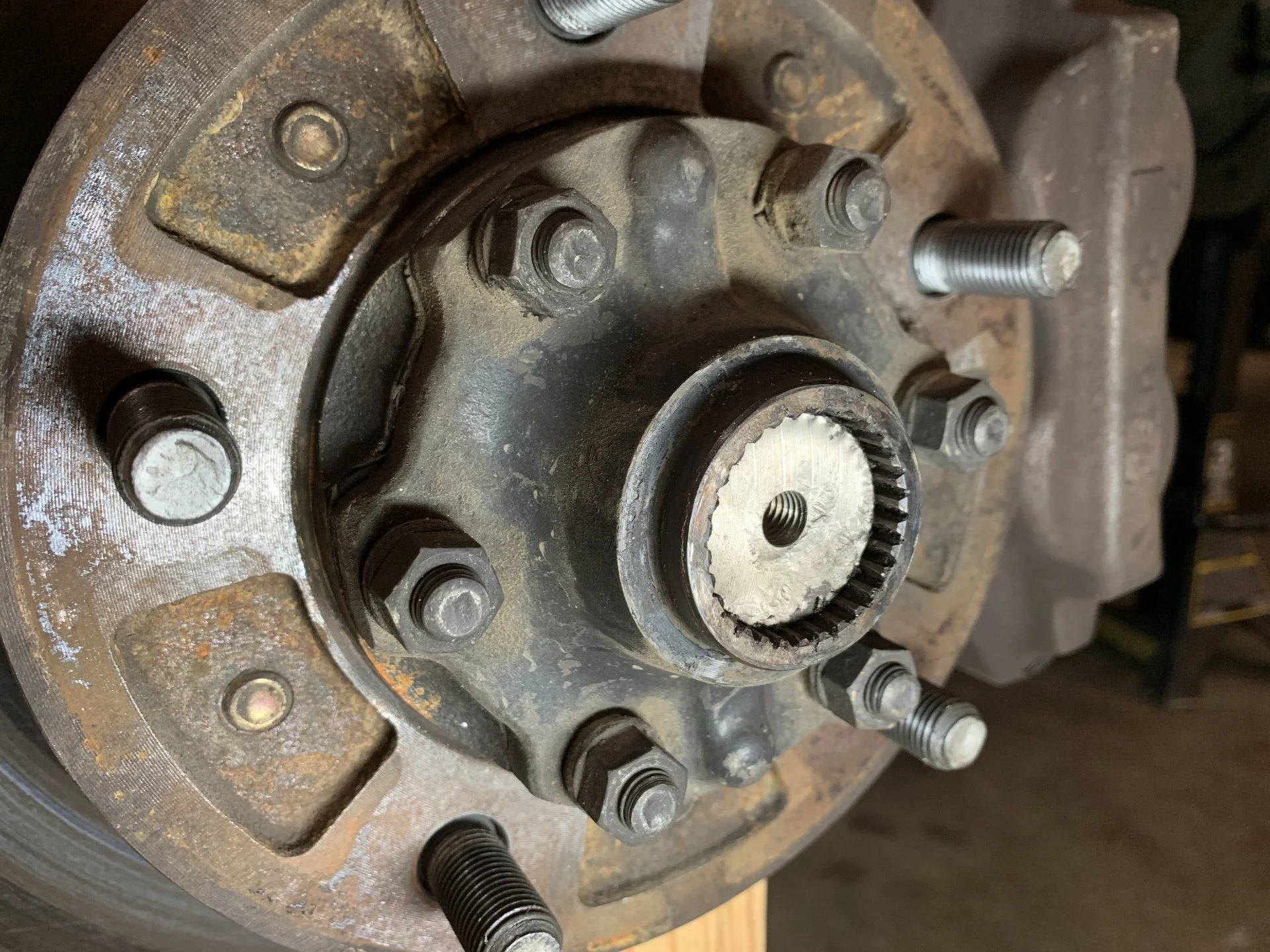

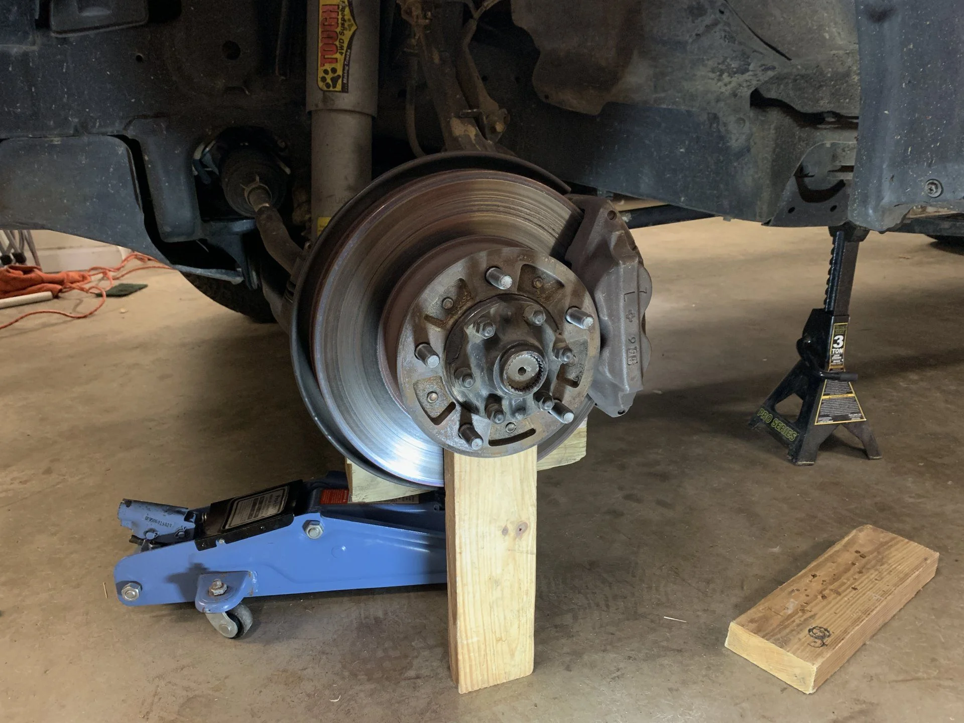

@TheForger, Your C-clip does not control your hub and rotor moving in and out, that is controlled by the two huge spindle nuts shown below. I would wager that the clunk was your CV moving in and out of the hub slapping the back side of it. I would triple check the spindle nuts on the front side and the seals and surfaces on the back side for damage. cruiser outfitters stocks everything you need including drilled and slotted rotors, that is where I got mine.
As said before, there is no way that c-clip coming off is the cause of the play or rotor wear. They may have been caused by the same yet-to-be diagnosed issue, but they are not directly related. Can't be. My guess is that the problem is now masked temporarily because of the new brake pads you just installed.
Are your caliper mounting bolts loose? Are the rotor to hub bolts loose? How are you checking for play in the wheel bearings and ball joints? You say the wheel bearings "don't have really any play in them." Not sure exactly what that means, but any play in the bearings is too much.
@TheForger I have been bitten by this dumb front hub design quite badly just as of last month.
As you have said yourself the C-clip ain't got nothing to do with the brakes or the play in hub. I'd take a look at the rotor mounting bolts. The calipers on these trucks are pretty strong and will hold the rotor (heck even the whole wheel sometimes) in place. Once the pads start wearing out you might see this again.
Well...looks like y’all are right. After a day trip to the Ouachita Mtns yesterday I came home and started hearing a whirring noise. Popped the dust cover to inspect and sure enough the c clip was off and the axle was recessed into the hub by about an inch. I will be tearing into the hub this evening to inspect the axle nuts & bearings.
Sorry to see that. I'm in the process of replacing flanges and CV axles here in Conway. I have an extra flange if you need it. Sometime when You have time, 'll ask how you like the Tough Dogs.
