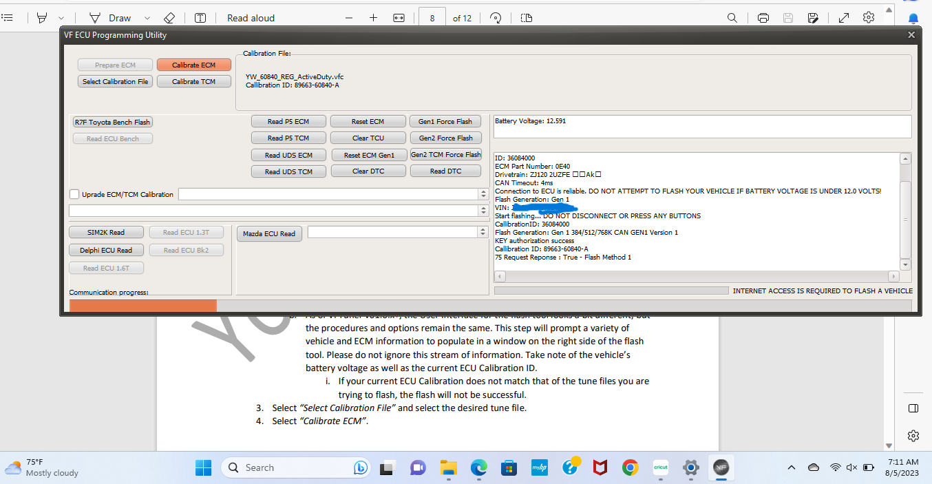

You can go back to the stock tune at any time. It takes <15 minutes to tune one with a Windows laptop. Not as easy as something like a Cobb access port for a Subie, as it requires VF Tuner - which you get a single-vehicle license for with the tune - and the laptop - but it's super-easy overall. Probably less work than having to lean down under the dash to plug in or unplug the PC.

Also, do you load the tune through a OBD connected to the PC?
I've an email out to them regarding a tune for the GX, did you notice better throttle response with it? I know they work on the mid range tq/hp from what I could find and people seem happy with it.
Throttle response was about the same, but the 2UZ-FE in my GX had pretty good throttle response to begin with (I think the throttle mapping in the 1UR is totally different). I noticed sizeable increases in overall midrange power - the GX really runs very very well now and pulls our camper great. Passing on a two lane road is also fairly impressive on it. I also have the exhaust mods that aren't available for a 460 that probably compounded the effects of the tune.
Yes, you use an OBDII to USB adapter connected to the Windows laptop. I bought this version of the tune so I could change the tune at any time myself. They also have a network of folks who will meet you in a parking lot to install the tune but I had zero interest in that. They gave me 2 different regular octane tunes and two different premium fuel tunes. I'm using the most aggressive 87 octane tune - I may try the 93 at some point but the GX runs so good now I'm not sure it's worth the extra $0.50/gallon to get more out of it.
Again - your experience on a stock 460 may vary, but it was a good investment for my modified 470.

I was worried about bricking my ECU as well, but was pretty surprised with how painless it was. For my specific application it was a good upgrade - but again I don't have a 460 so I'm not sure how well it is/is not worth it. We have zero smog testing down here in the Ozarks and a pretty minimal biennial safety inspection so it's not really an issue in my area.
