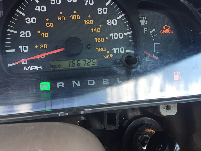

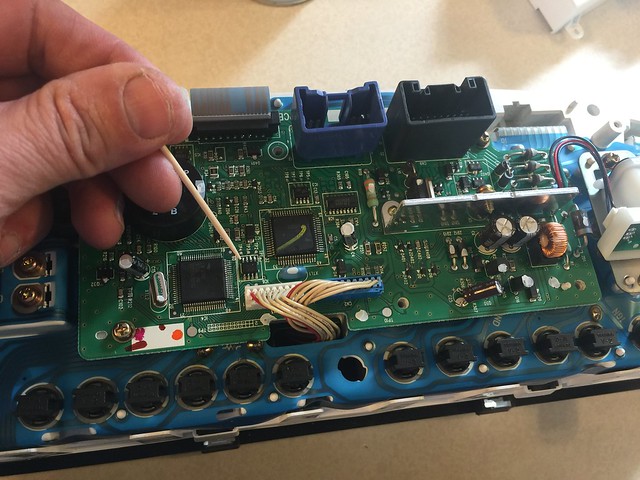

Awhile back I fried a circuit board in my combination meter (aka instrument cluster). I bought a used one soon after and swapped that circuit board. Unbeknownst to me, the odometer data was held in a tiny chip on that board. My truck with 167k miles then showed over 200k. So, I promptly put the bad circuit board back in while I researched how to go about fixing the odometer problem.

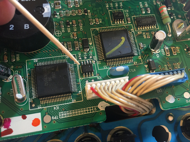

Long story short... Today I finally swapped the chip from the original & bad circuit board to the new-used circuit board. I used a hot air/soldering iron rework station to remove and reinstall the smd chip.
There's the tiny chip. And my odo showing the correct miles.
Your check engine lights on :flipoff2:
You are much braver than me taking on swapping that chip. I'd be afraid I'd destroy something.
@jynx I knew someone would say something about that. The CEL is on in his picture becuase I had just turned the truck to on and didn't start it. But, if I drove it for any length of time, my transmission would blow fluid and the CEL would come back on.
@jason in tn, it is low on gas. But it's not been driven in a month. It's cheaper that way!

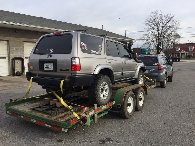

I dropped the 4Runner off at Matt's Transmission in Murfreesboro. I had to leave it with all of those Heeps, Hummers, Chevys, Fords, and Dodges. At least it will be back up and running soon.
Left Behind
@ugamurph the like was because it is gonna be fixed soon, not cause it's busted. ;)
