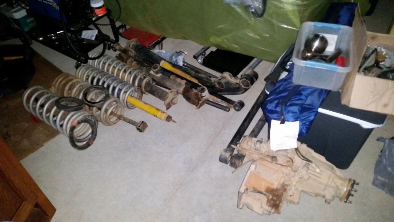

I did get the 4runner unloaded tonight, finally...
Grabbed a quick pic of the haul, gonna try to get a better one this weekend.
For the time being we will just be cleaning and painting parts, prepping things for install later this year after.

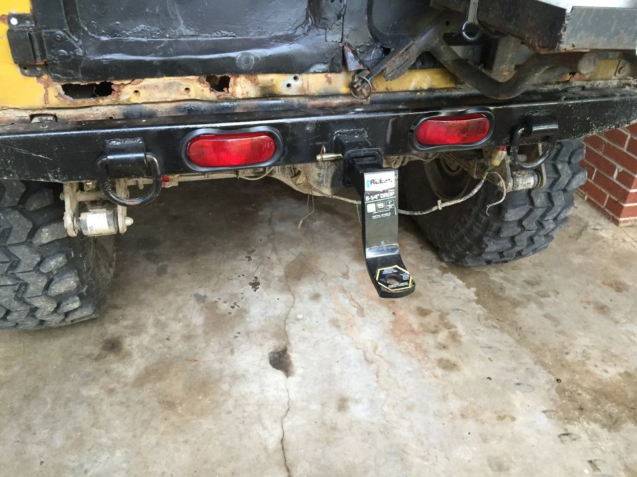

installed ram horn manifolds and had new exhaust built for the 40. so quiet now and hopfully a bit cooler on the feet! also installed new 4" pipe from turbo out on the old tow rig.
Good job Andy. However, you do know that a creeper will not work on Roger's trailer at 60MPH right?
