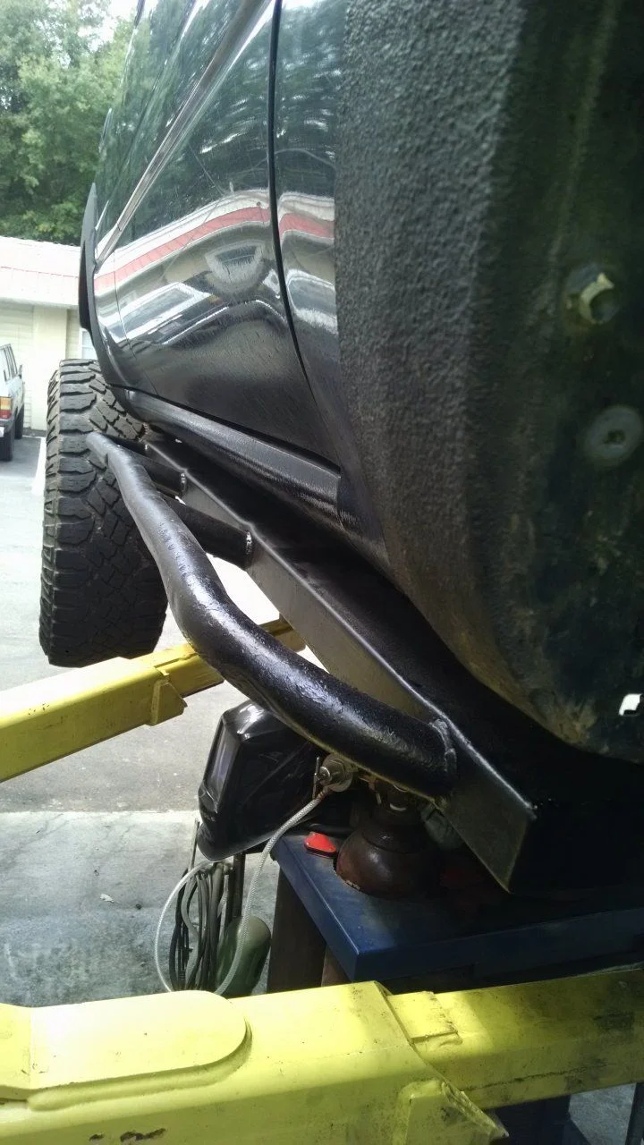

...Update...I was able to find a local guy to me to do it. I called 5 or 6 body shops and they all refused to weld on a frame. Weird.
I'd cut those guys off as close to frame as possible. Take some pics of the mounting points and methods and take with you for a guide if someone is helping that's unfamiliar with their use. I would add gussets to the existing design but they obviously lived up well tested.
Find a tube diameter that's ID matches the OD of the outriggers and sleeve, drill and rosette weld to length desired. You may have to make them round again in places :lol:
You could make them bolt on at that point by adding plates with gussets to the ends and then going u bolts or bolts and backing plates. It would likely be more work for the fabricator though
Yeah, I'm planning to take lots of pictures before I cut them off. Then try to get it as close to the frame as possible. I'll go from there once I see what I have to work with. If the local guy doesn't feel comfortable with it I'll wait until I can get it in to Marshall.
I really have no need to make them bolt on. If I ever need to get to the exhaust and the slider is in the way, I'll just cut them off again. I have no intention to ever sell my 80, so not really worried about it looking perfect. It's pretty beat on already and has a some rust creeping in. My hope is that within 2 years it will be dedicated to trails and I'll something else to use as my DD. After that point, I would probably just part it out, if ever needed.
The well loved sliders from The Rasin will live on in the Blue Whale. Thanks Onur @beno !

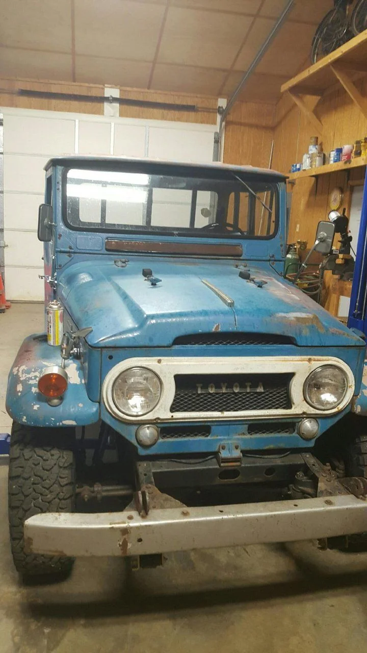

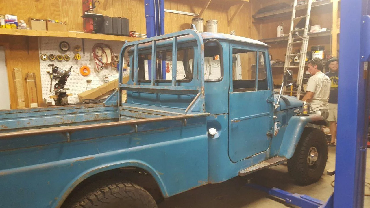

....they are trying to figure out how to get a 60 or 62 now. They sent me these pics from where they are staying in Wahalla...a tree house owned by one of the band members from Need to Breathe and this is sitting in the barn....1965 FJ45. He is needing some help with parts/repairs so naturally we have directed him to @Trollhole !

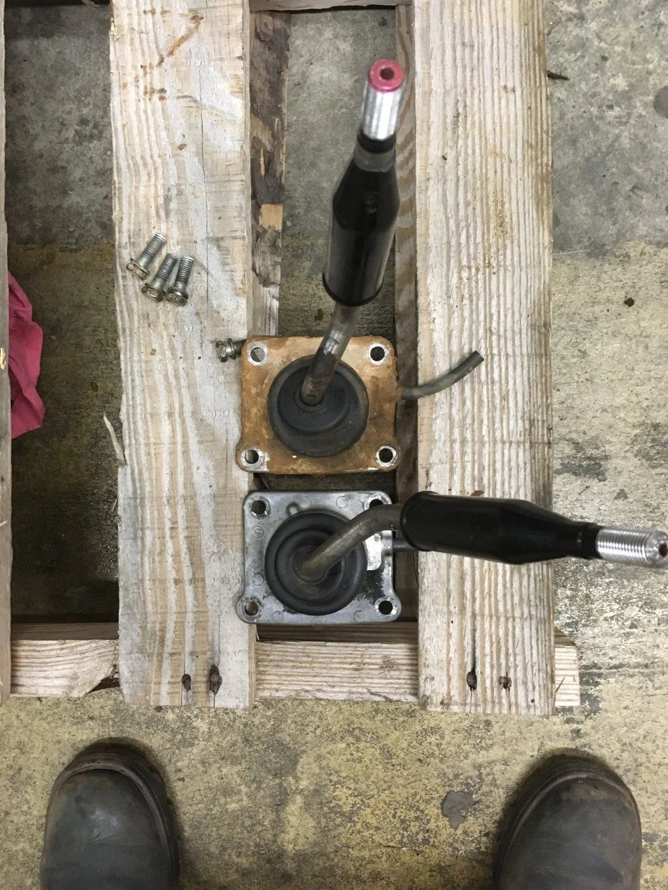

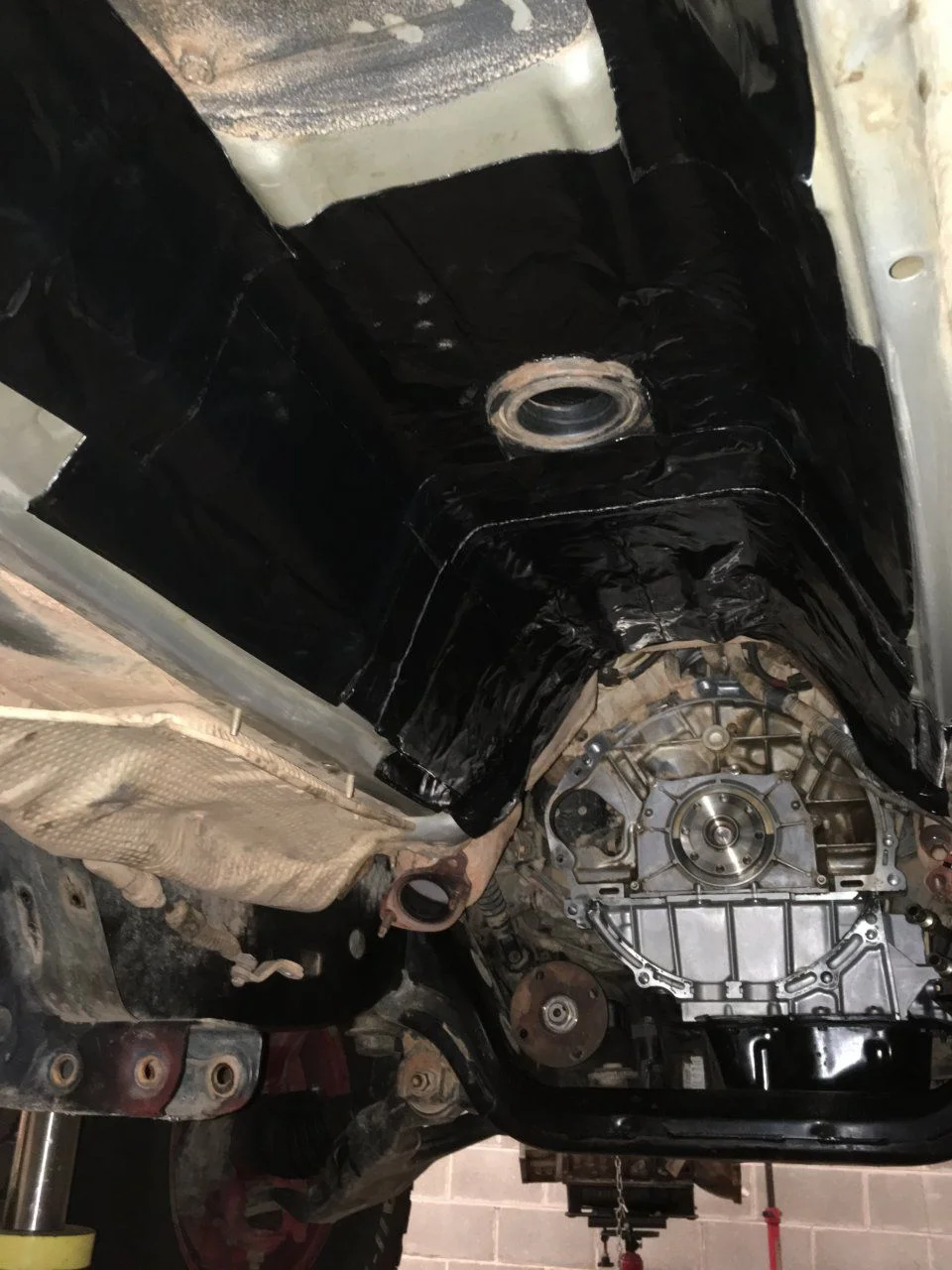

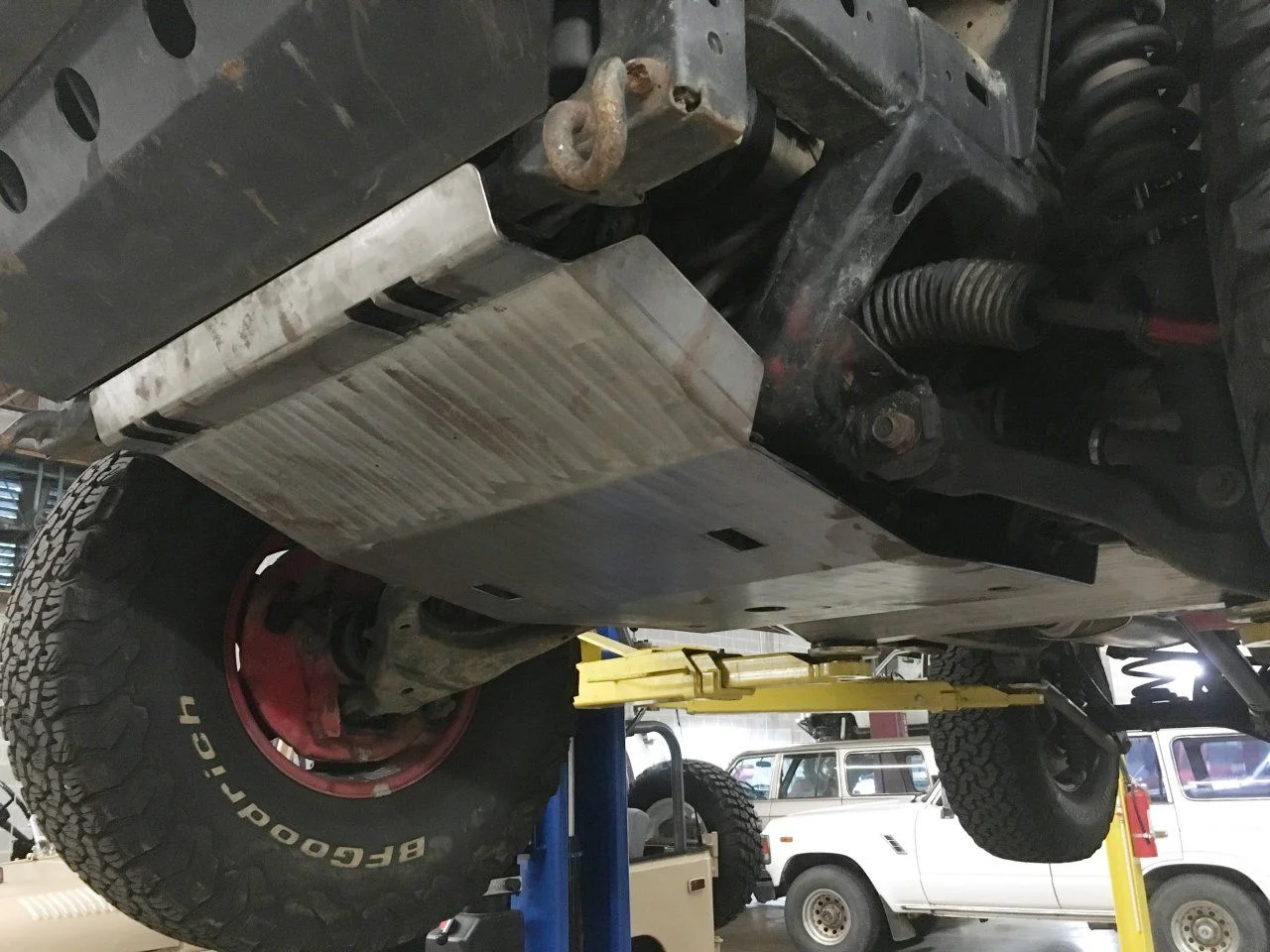

OK, not necessarily "this week" more like what have you done since OTMT...for those following along... a recap - Rear caliper siezed up while in 4Hi, diff was low on fluid because I left out two bolts on the side cover of the e-locker actuator (toasted the pinion bearings), t-case grenaded, rear main seal has been leaking a while...

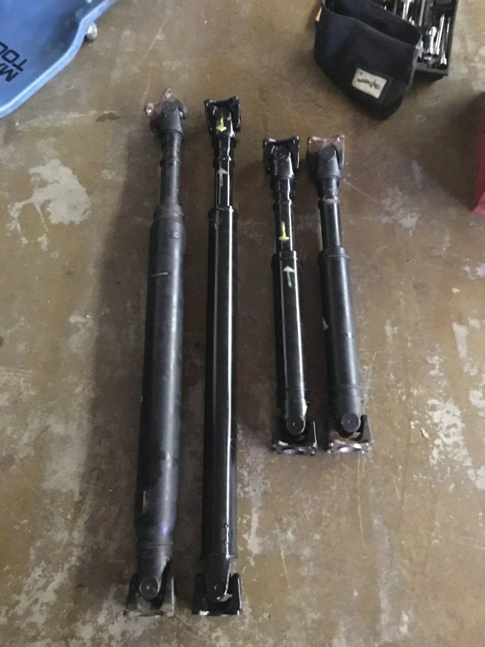

Over the last 5-6 weeks roughly in this order...I've replaced the rear diff with ECGS,removed the exhaust and cracked a few studs in the process, removed the tcase & trans, replaced the rear main seal, replaced the motor mounts, added heat/sound deadener to the tranny tunnel, reinstalled the transmission, replaced the rear calipers, soft lines and hardlines, wrastled with the exhaust (wasted half a Saturday), replaced the tcase with one from a wrecked FJC, discovered the shifter on the new tcase was bent (used old shift lever), had the exhaust rebuilt, had the drive shafts rebuilt (rear one got thicker wall tubing, but smaller overall diameter), replaced old engine/trans skids, reshaped my gas skid, installed brand new forward gas tank strap, fashioned new studs (sheared off too) on the rear gas tank strap since the one I ordered is still on back order (somebody in Japan needs to get busy), installed the gas tank skid
A lot of ground covered in 6 weekends. Kudos to ACC for letting me use a lift for that long. Just in time for Southern Cruiser Crawl this week, whew, cutting it close huh Carswell?!
