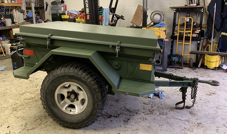

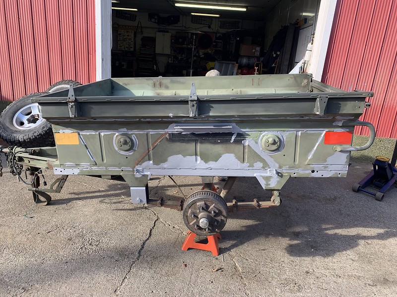

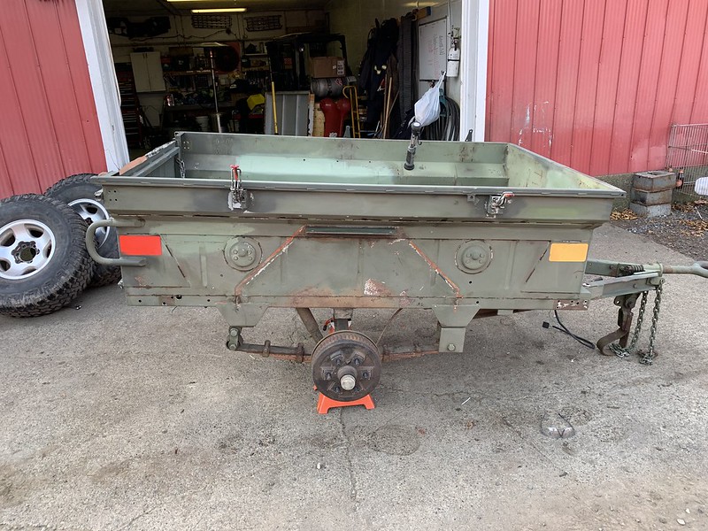

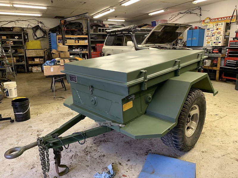

The last couple weekends I've been busy de-militarizing/repairing my M1102 trailer. Removed the lunette/surge brake assembly and installed a 2" ball hitch. Replaced all of the marker lights since the factory units were corroded beyond saving. Chased lighting issues with the tail lights, which turned out to be a ground. Replaced the hydraulic drum brakes with electric brakes. I'm in the home stretch now, just need to complete the new wiring.
And got it finished up yesterday. Hopefully I won't have to touch it for a few years :)
