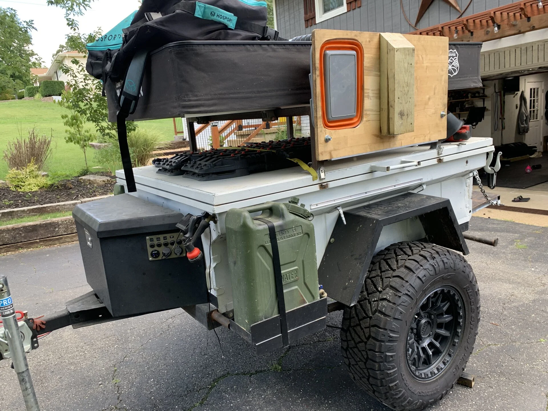

About to swap my 270 awning to the trailer. Does anyone have any nice mounting suggestions?
I don’t think I want adjustable height, and I’ll just sit it above my head height a few inches as I’m the tallest in my group. And the way my trailer is setup I think it’ll be easier unless I use some of the super fancy folding hinge setups.
Pic for reference as it’ll be a driver side 270

Maybe come off the 2 upright supports that hold the cross braces under your RTT? Will take up some of the window area of that side but would/could work
That little LC. Where did you get that? Love it
That’s my mounting thought too, I actually went and looked closer last night it won’t be as difficult as I originally thought. Just time and metal.

Getting the height you want may be the challenging thing and keep it clean and stable

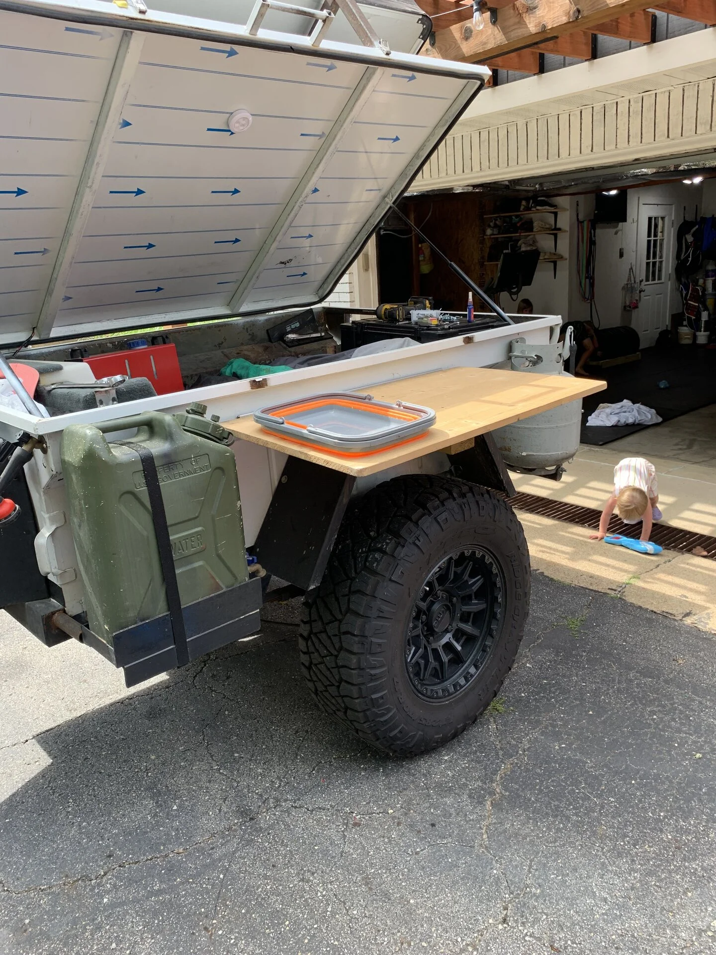

Bumping this back up. Last weekend accomplished a couple things on the trailer.
Added another 5 gallons of drinking water, added a 1 gallon container for the diesel heater fuel, added a side mount table for food prep/ flat surface.
I’ve decided the spare is going under the trailer on a simple stud mount. It’ll be a pain in the ass to get out if I need it, but better than no spare.
