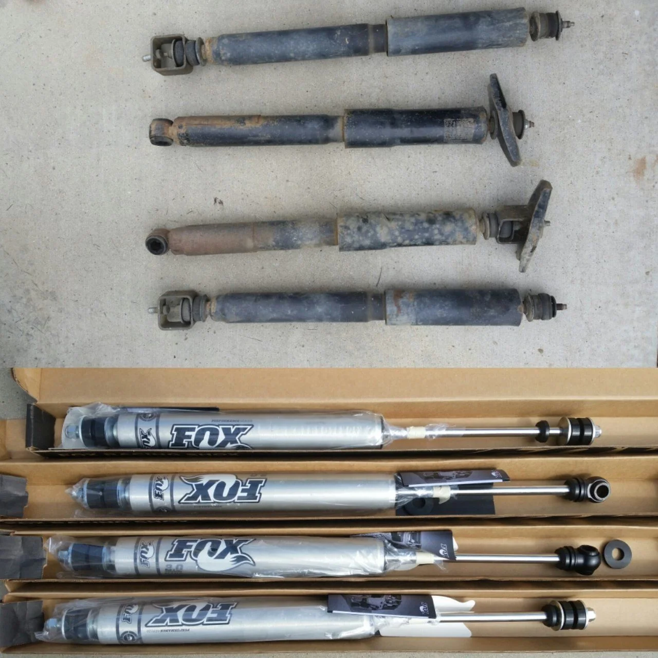

If you weren't planning on it, get the roost guards for the rear shocks. Had to cut the bottom edge down a little to clear the lower mounting post bolt, but i had significant nicks on the rear shafts after one 1k mile trip. roost guards do a good job of avoiding it, and aren't very expensive.
