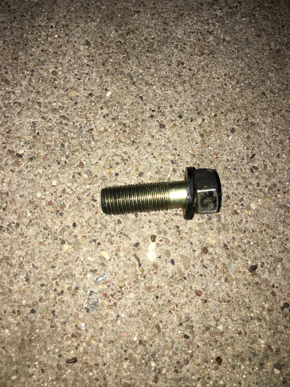

Then I checked the passenger side and forgot the PO had replaced the square head bolt with this. Probably not a bad mod IF it was fully threaded and a shorter bolt. I have an awful feeling that there is damage in there. Stacking some washers and will pick up a shorter bolt tomorrow and swap out in the parking lot at work.

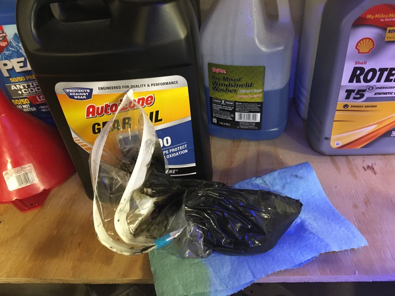

And I used my patented ziploc method for filling my knuckles. Worked flawlessly and took about 30 seconds to fill them. And no mess.

Nope. No metric plumbing supplies. So, I'm guessing that I will probably be tapping the knuckle in the future. The bolt he used went back in without a problem. Wasn't stripped out. I'll do some investigating...

What would be the concerns of using w non tapered metric bolt in there? Just curious if any damage has been caused to the threads. When I put it back in it seemed fine.
