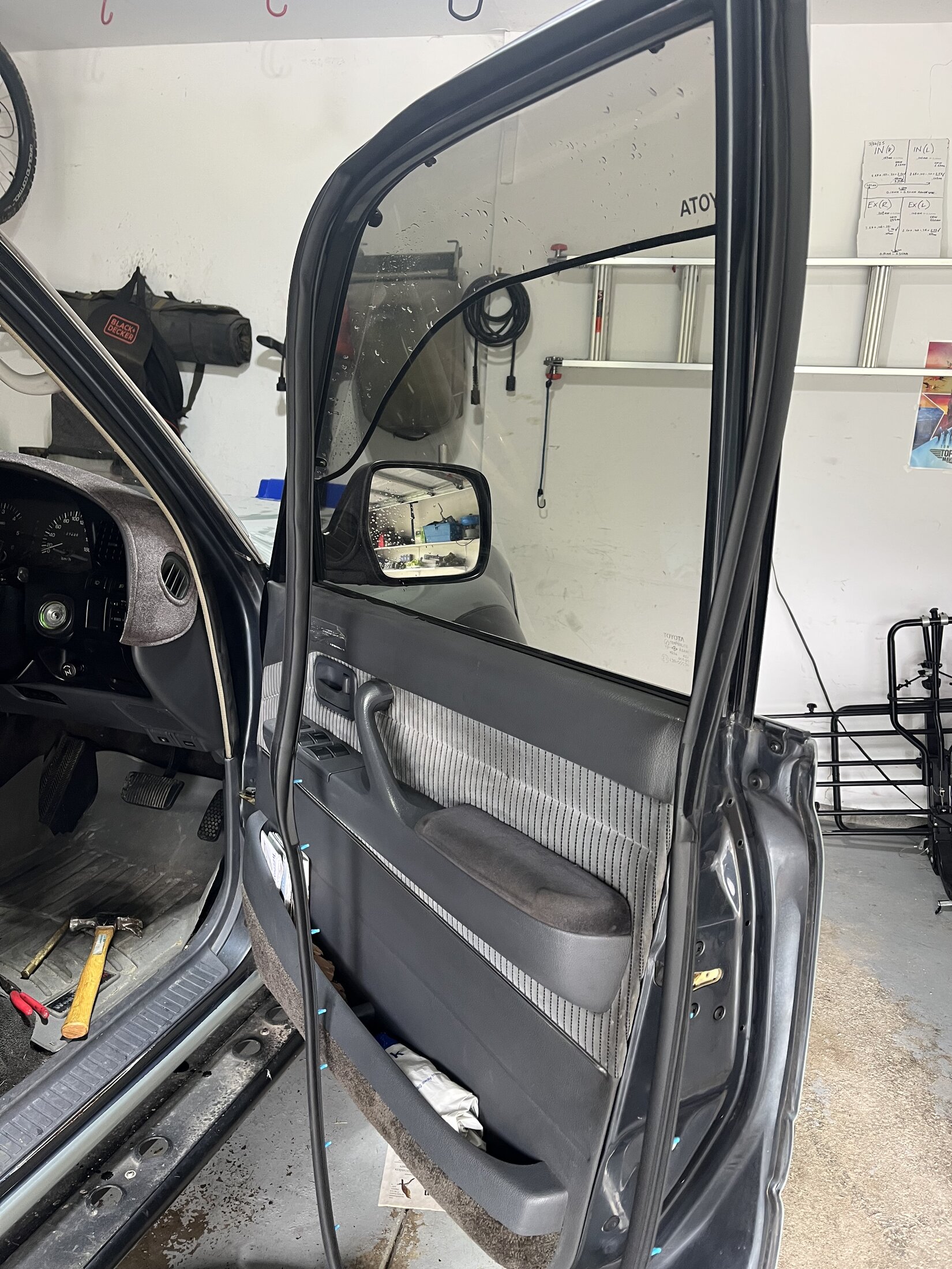

I replaced some interior paneling grommets, I put a 7mm rubber O ring (6mm would work too) in each grommet groove. Driving down the road…..an eerie silence filled the cabin…..The Silence of the Rattles. 😎
I added felt tape to the sheet metal behind the panel. It did nothing to stop the rattles :confused:
I might give this a shot.
