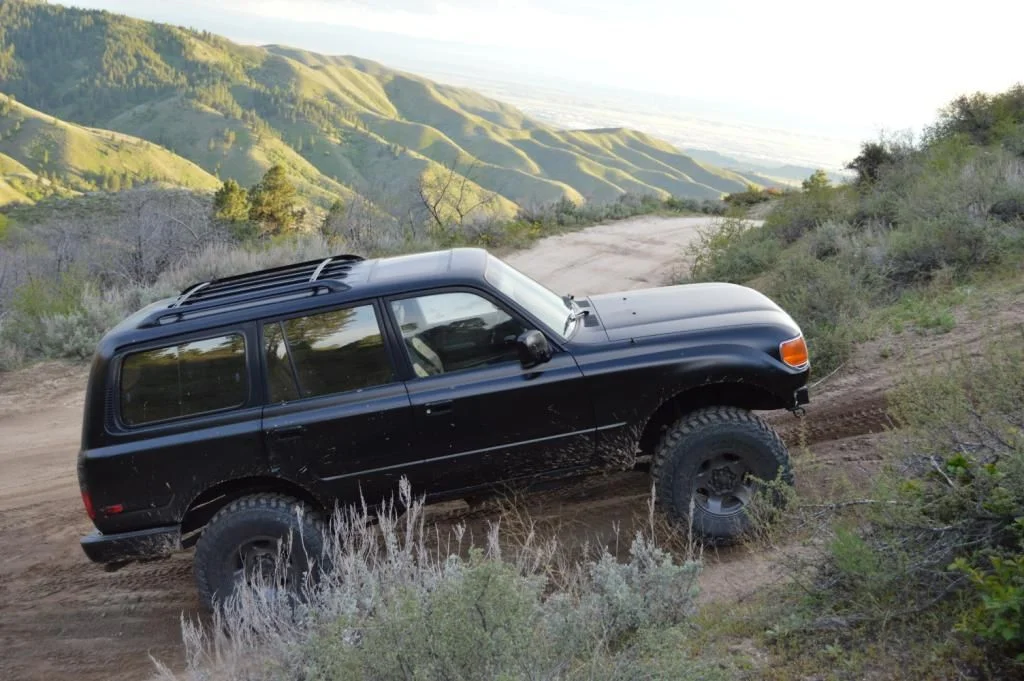

Took it on a mild trail ride to put brush marks and some mud on the new paint.

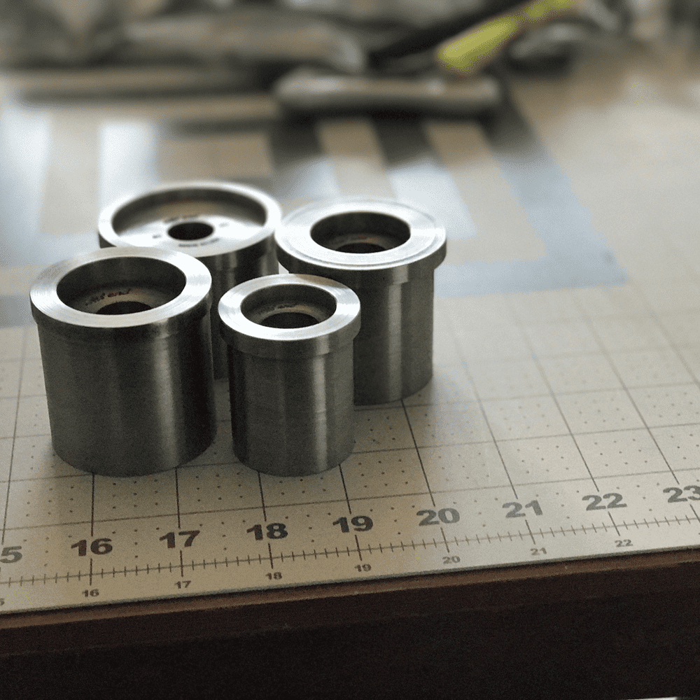

Made up some bushing press tools so that I can start replacing some bushings that I ignored first time around. I threw them up on the site as well.
Now THOSE would have been handy about a year ago. Small price to pay given the hassles of NOT having a set.

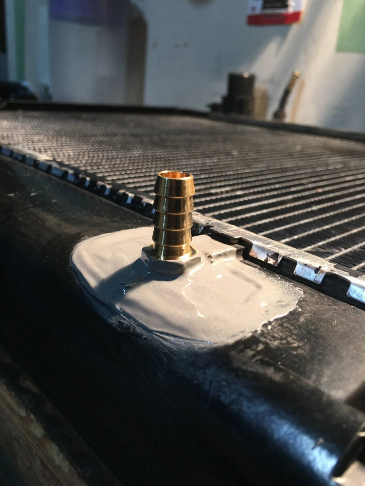

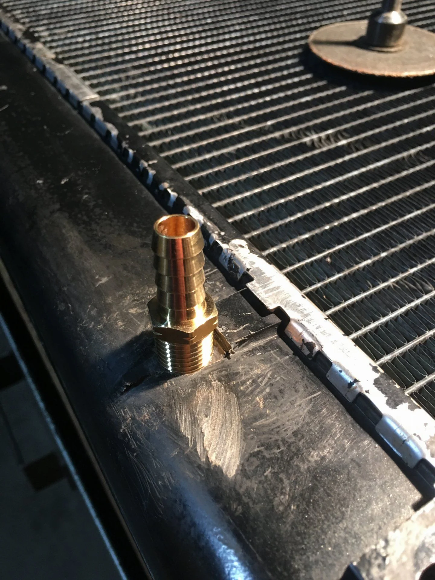

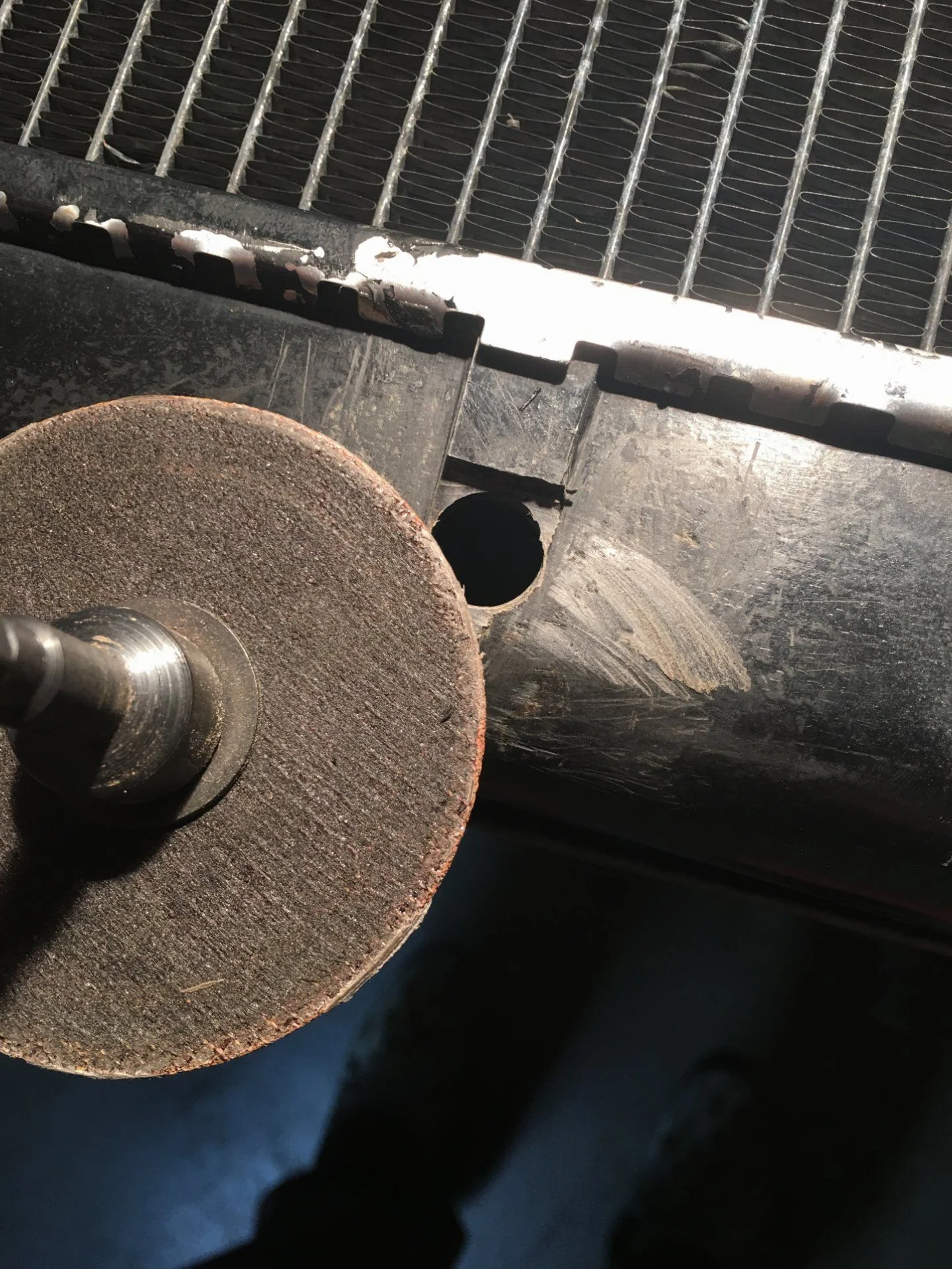

One the other hand the radiator fix held so maybe I won't have to shell out anytime soon for a new radiator.
Don't forget to add the purchase option where I drop by and let you install them for me as well!:D

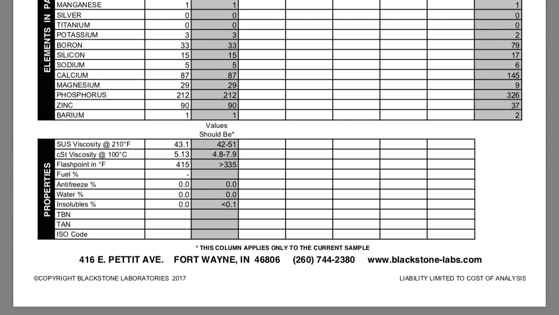

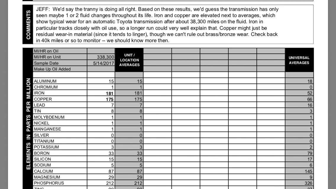

Got my transmission fluid test results. Gotta love hearing "check back in 40,000 miles". Haha

What type of epoxy (brand) did you use on your rad. Is it leak free?
