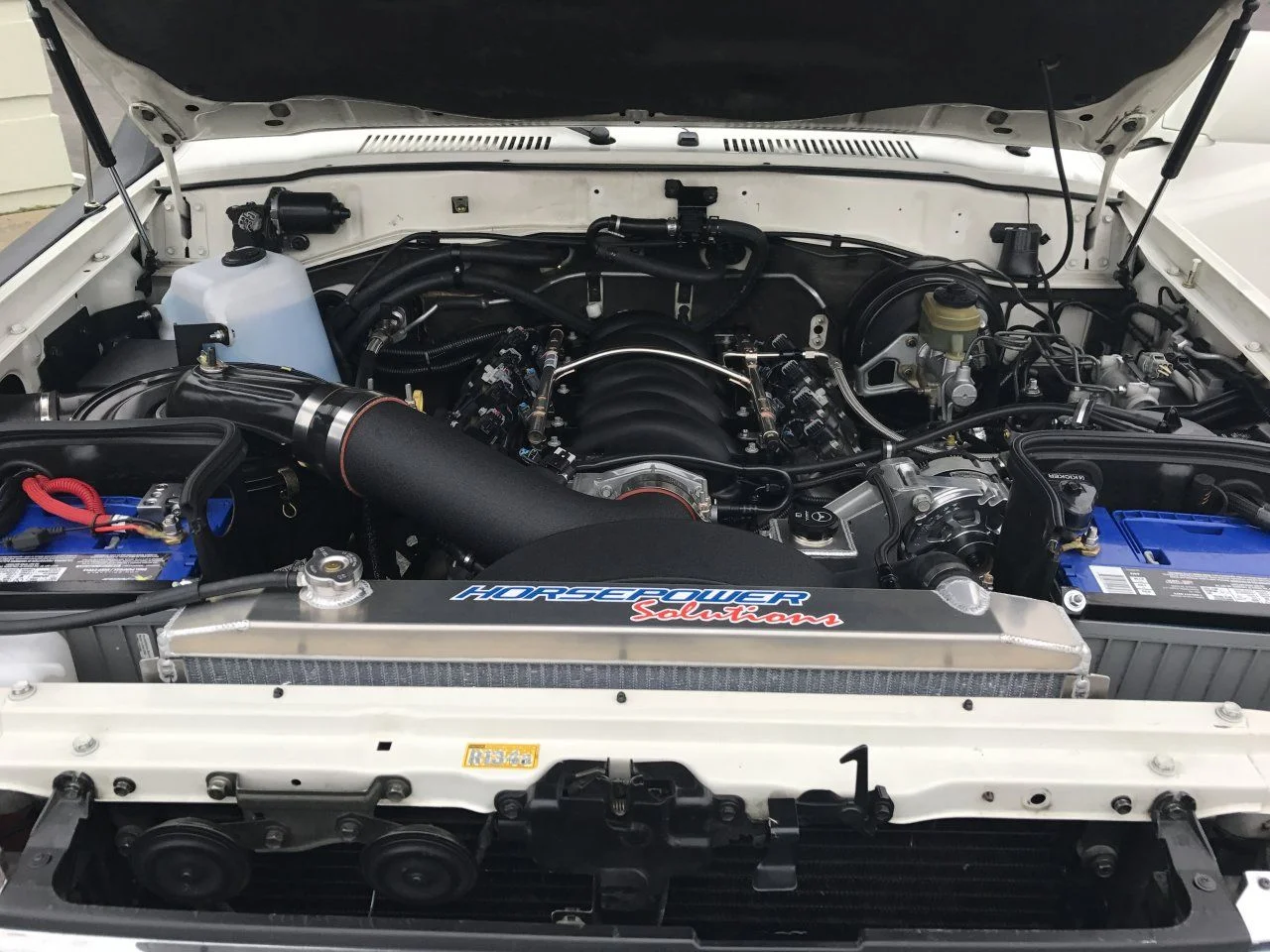

Driving her home from VA back to AZ this weekend after a 6 month vacation for an LS3 swap. I must say I do like the extra ponies on tap. Enjoyed Smoke BBQ in Newport News on the way out. Already met another forum member (sgpipes) on the way home. Great guy and enjoyed the time.
View attachment 1382379 View attachment 1382378
It's a crazy clean install.
Seriously, it makes me almost rethink doing a swap. I thought my LS swap on my 40 was clean but it looks downright hillbilly compared to @azcrackshot's. It looks factory which is one of the reasons I've hated on LS swaps. They always look like a swap.

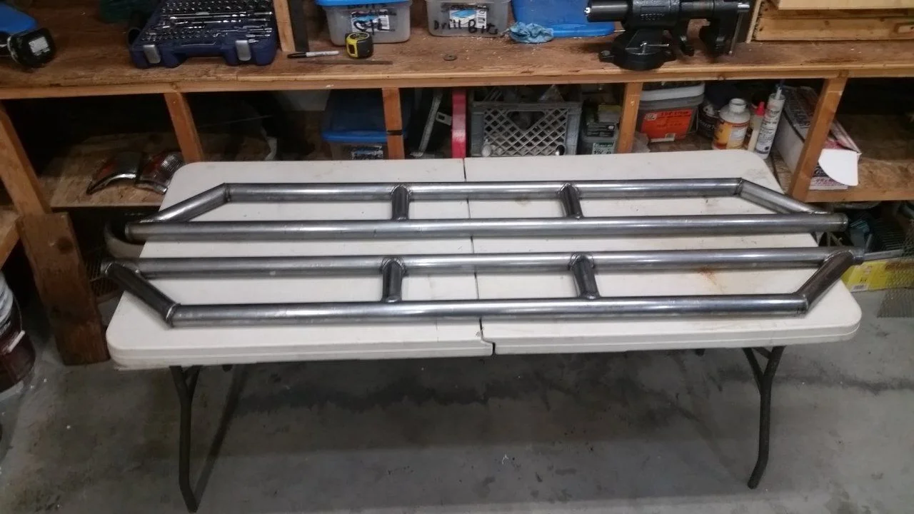

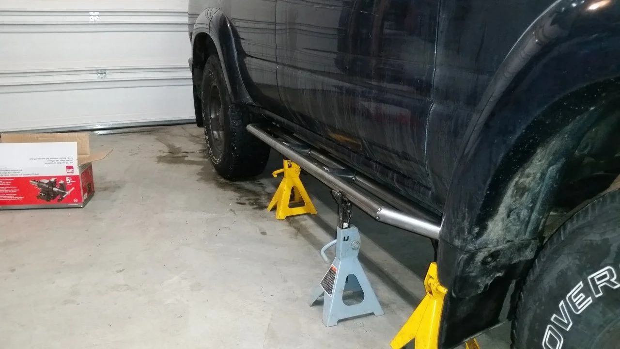

Started making some sliders. I think they're turning out ok, considering my lack of fabricating experience and tools. Amazing what you can do with a portable band saw and a grinder...

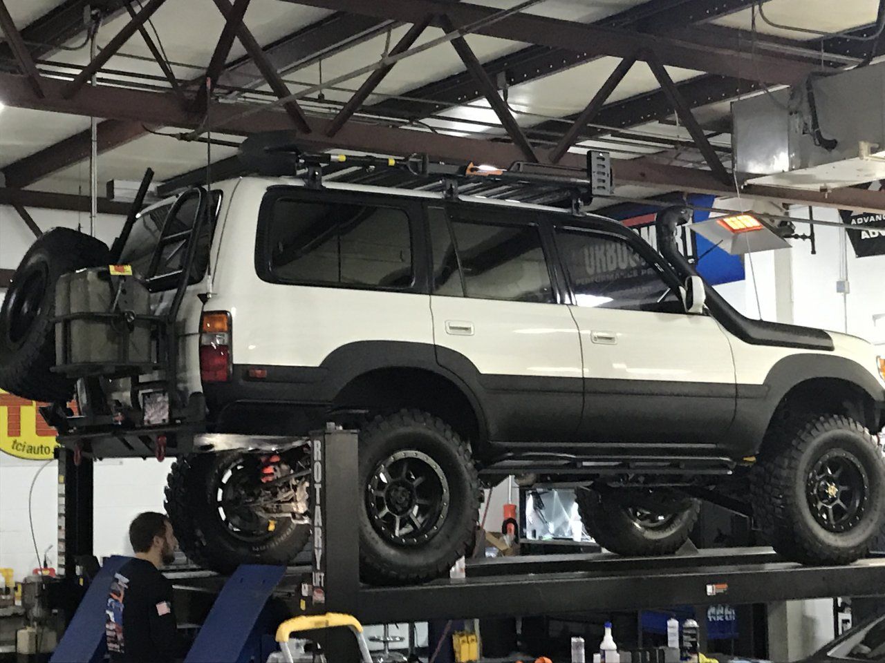

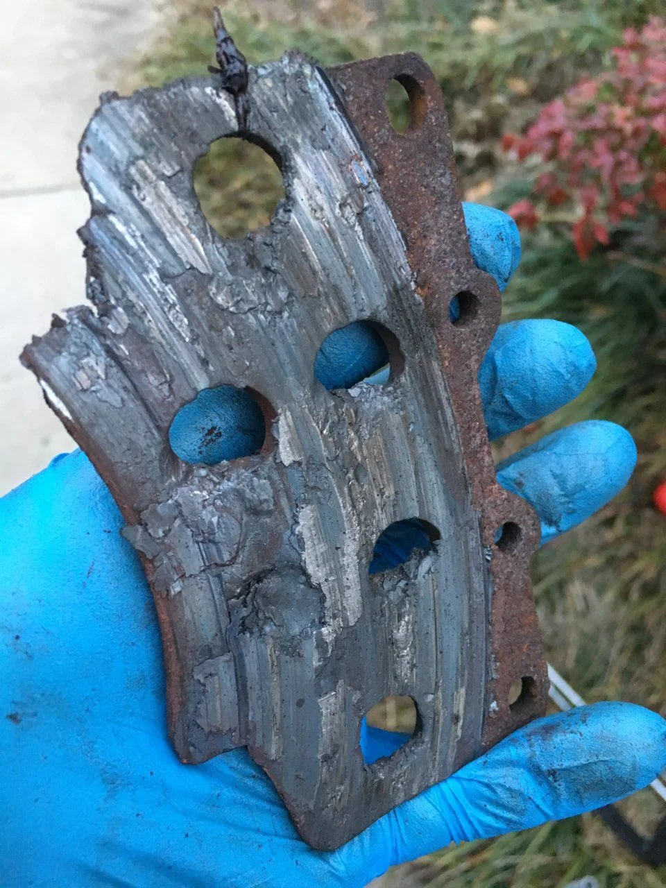

Helped a local mudder do a wheel bearing and brake redo here..... i think it was time :eek:
Driver side pistons siezed in full extension. New calipers pads and rotors.
Same as @NLXTACY .... one side had inner and outer nuts finger tight and spinning, other side snuggged up tight.......but lacking preload....... but the PO just rebuilt it :lol:
