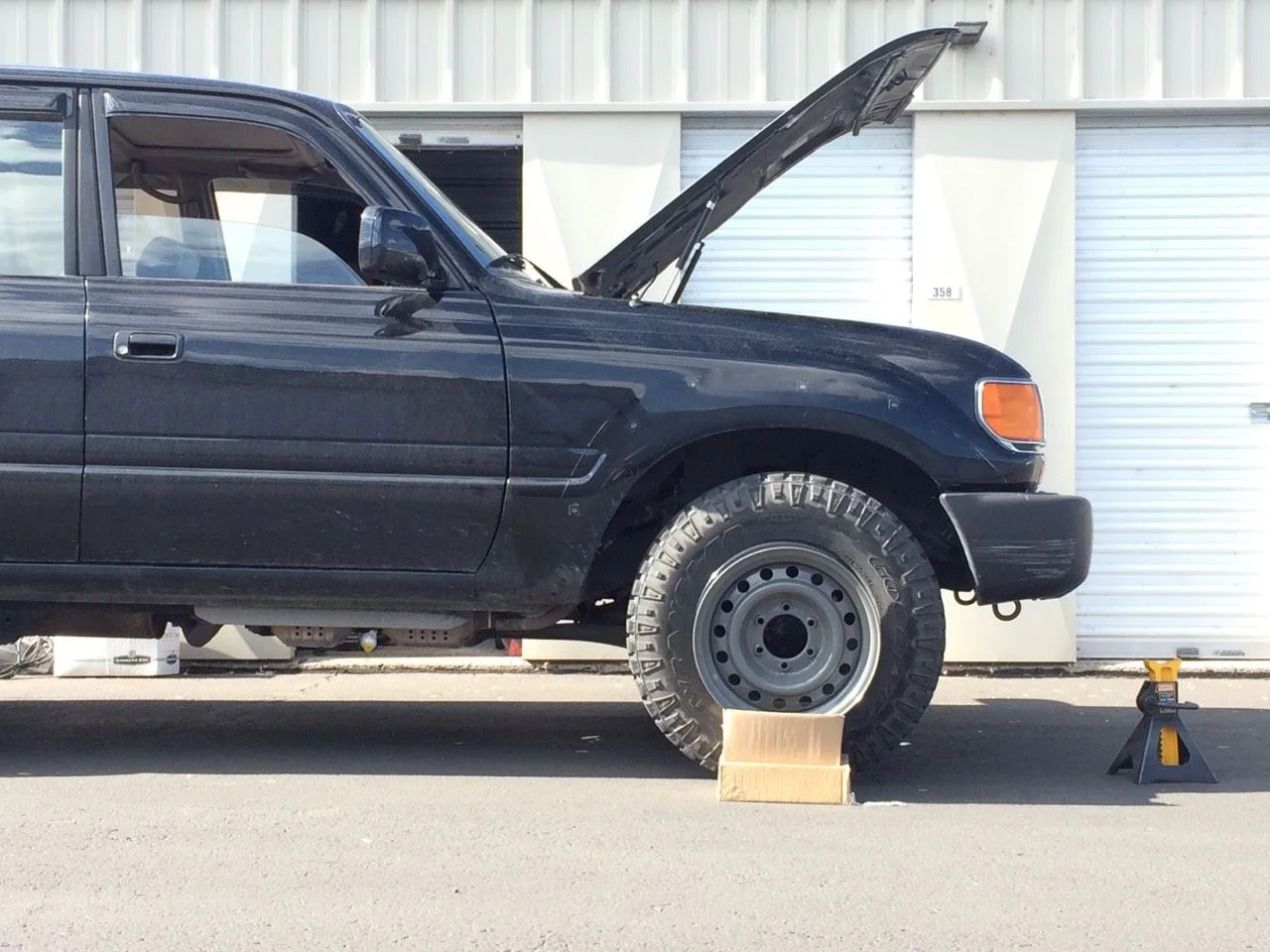

This is what it looks like now.
I tried to undo the lower control arm bolts so I can "relax" the bushings, but failed.
The bolt head is 22mm but the nut on the other side is slightly larger. somewhere between 23 - 25mm.
Doen anybody know what side the nut is?
They are definitely not standard. 24mm on mine.
My current limiting down travel factor is the shocks.
And that's a good thing for my right now as all the brake and breather lines are all stock (too short).
Even if the bushings aren't limiting downtravel they are binding more than they would which increases chances of tearing.
Placed my new steelies on some boxes to "Mock them up", they'll be wrapped in Toyo MT 255/85R16 shortly :wrench:
Paint is Valspar Massey Ferguson Gray, tractor heavy-duty paint.
