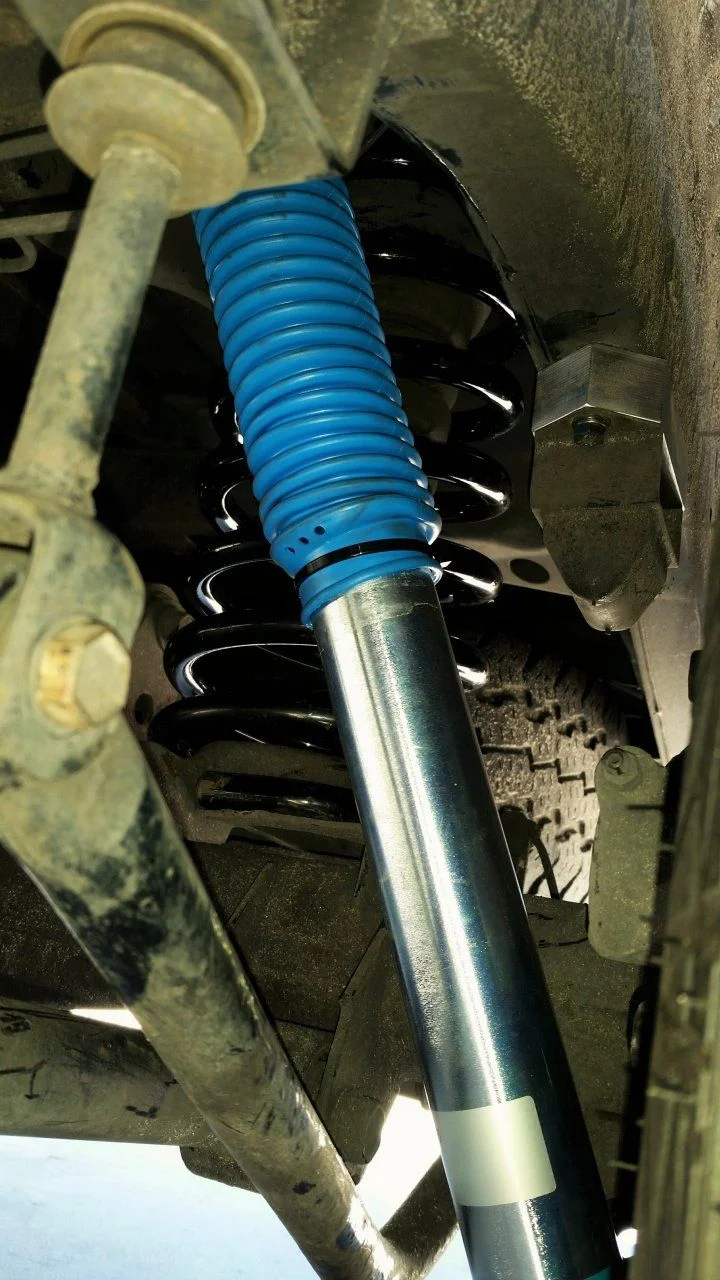

Got the rear end and sub tank area blasted and painted. Now I can finish the sub tank install

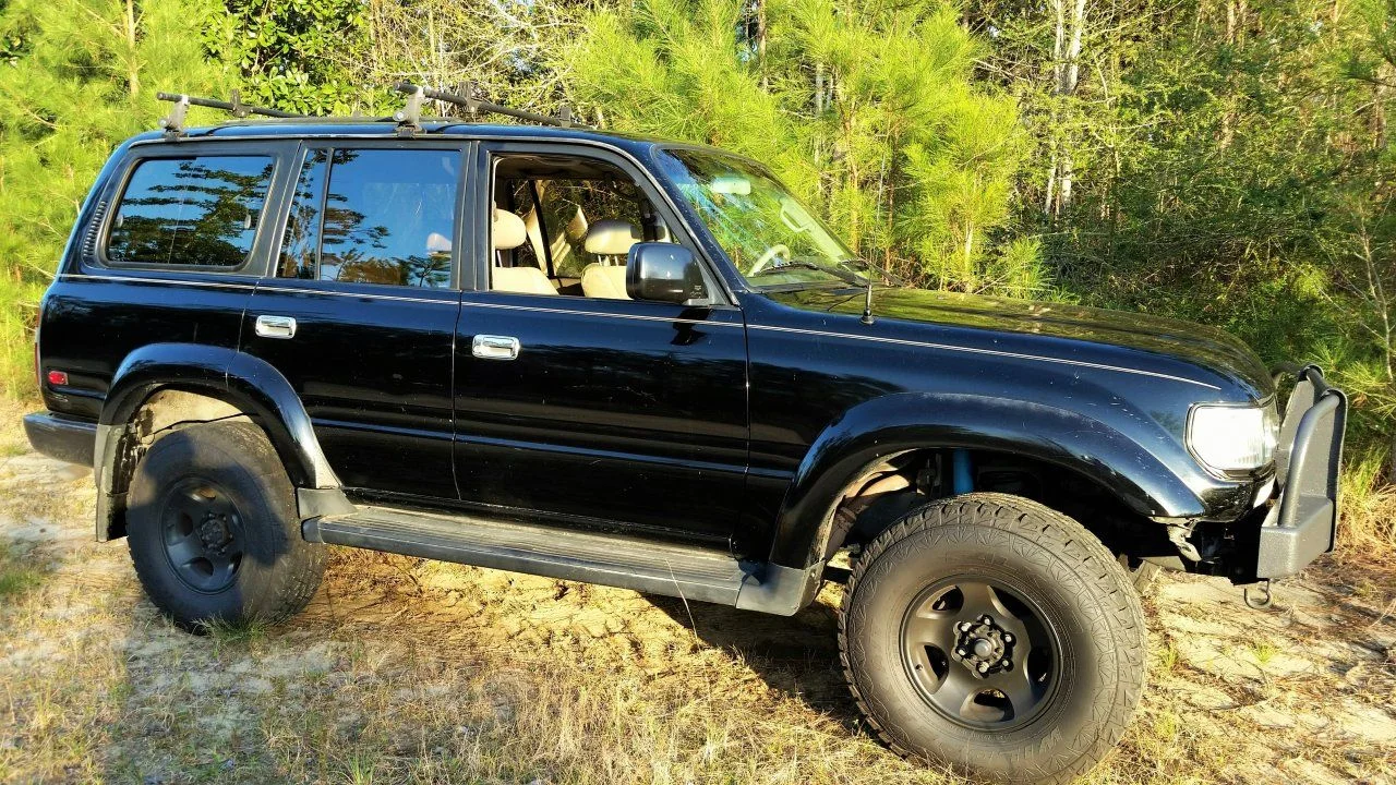

I figured out my steering clunk. It turns out that if your front axle is offset by like two inches, stuff is going to bang up against stuff.
:doh:
:doh:

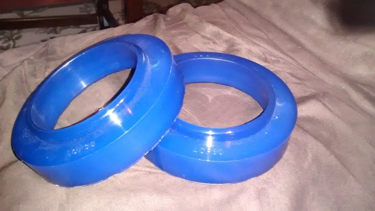

I had removed the 1" spacers in the front a while back and never thought anything of it. Then the other day I was just looking at the truck and went, huh, the wheel is way over there on the passenger side.
:hmm:
:hmm:
So this morning I took it to an alignment guy I really trust. He's all, "well I can't tell you what's wrong and I can't deal with it today anyway." But he looks at it anyway...
Well OK, he says, this thing here is kinda loose, so fix that. I don't know why your axle is so all out of whack I've never seen that before.
Well OK, this thing here is kinda loose, so fix that. I don't know why your axle is so all out of whack I've never seen that before.
turns out he was hanging out having coffee with some other old school alignment guy who was all, "Adjust that panhard bar. Shorten it.
You'll need to fix the steering wheel alignment when your done. That's easy."
"You don't need us."
