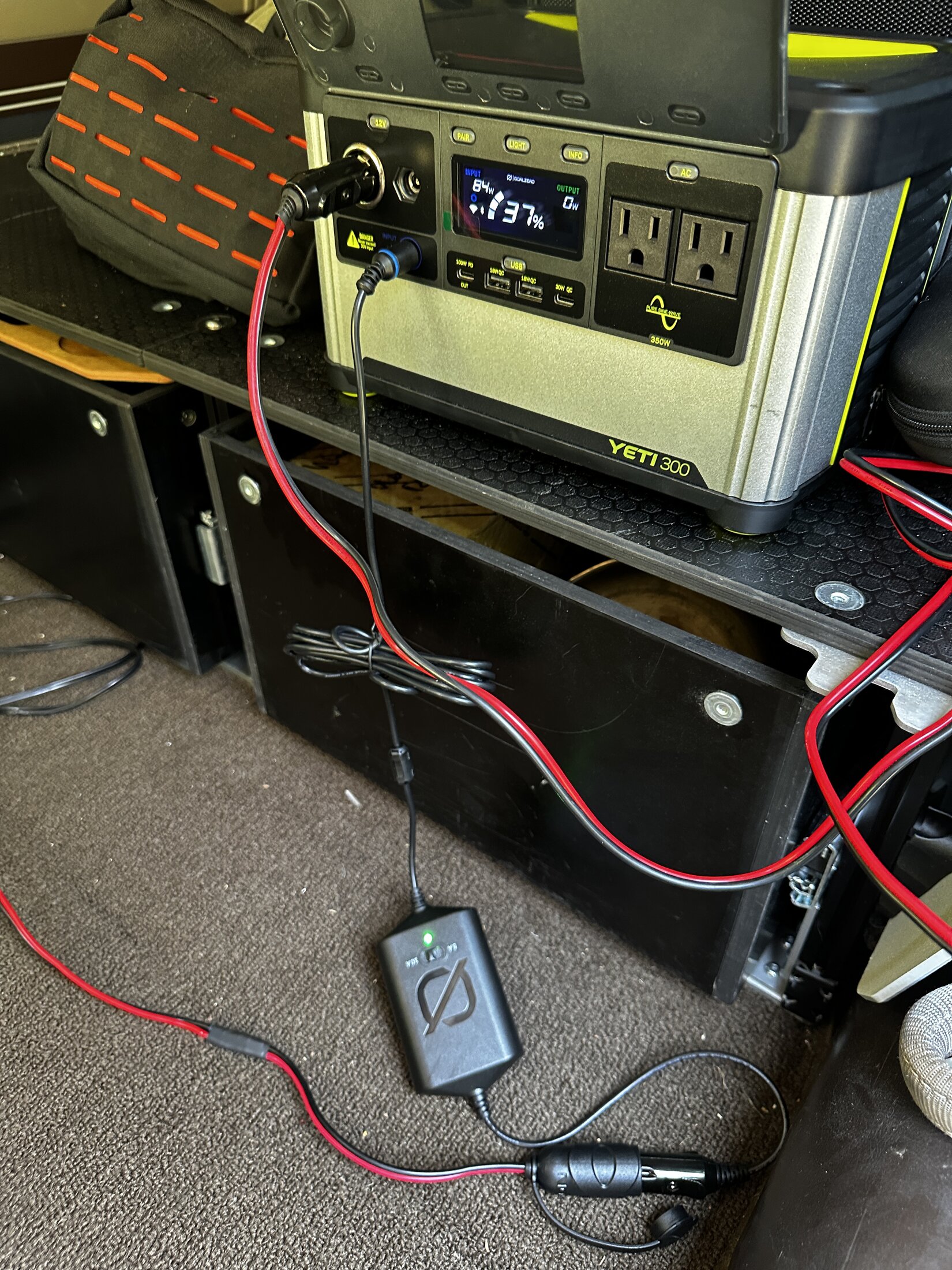

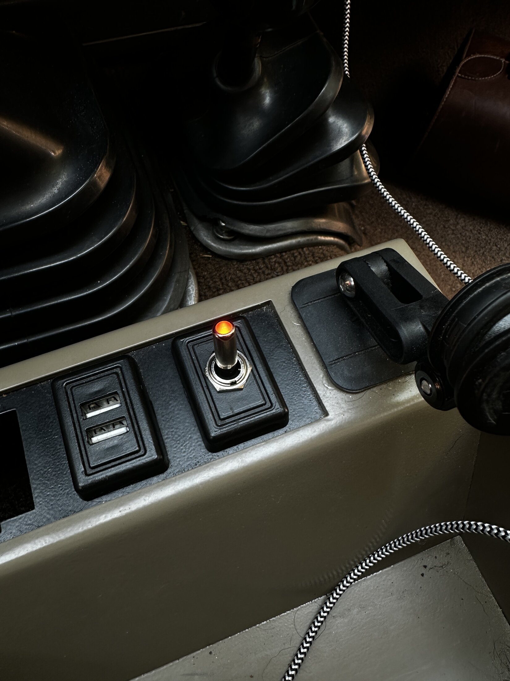

Got my self destruct switch installed… Kidding, this is for power to my Goal Zero/fridge. Wanted something I could have on while on the highway and shut off and let the goal zero battery maintain the fridge and other items as needed. Worked out really well. Then took some 4WD time to go wheeling to the swim spot!
Switch in!
Here’s what things look like just after the first smoke test:

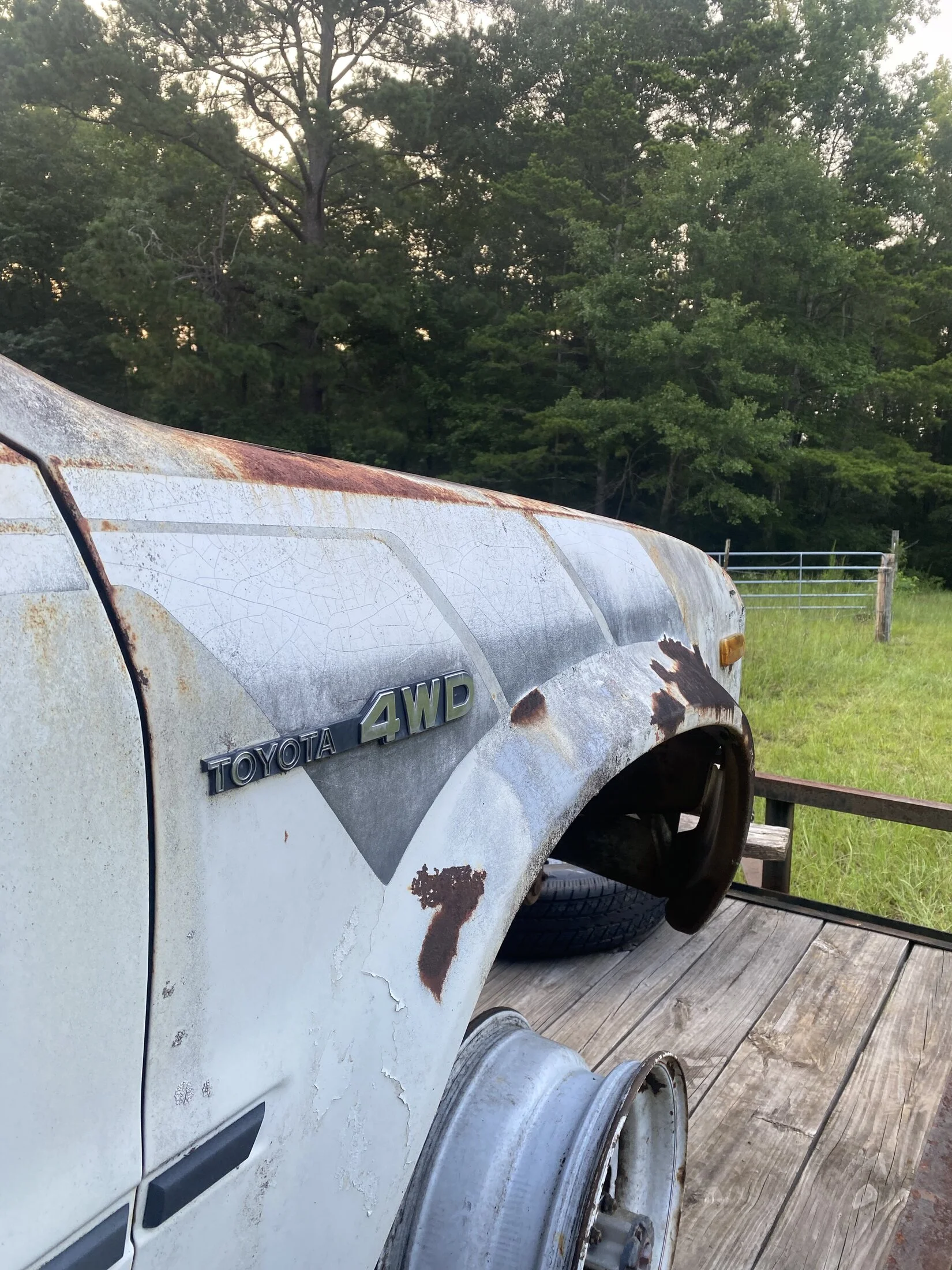

Helped @cruiserinsanity drag home a couple of old Toyotas he found. The white one is a 1982 SR5 longbed with 22R, while the red one is a 1987. We used both FJ60s to tow these home. Towing was quite as slow as I had expected and our top speed was under 60. We had one hill which where we dropped to 30. Red FJ60 has a 2F with over 300k on it so I was expecting slow going and poor mileage. Keeping the engine at 2500 rpm in 4th was the sweet spot; both 60s have H55Fs.

Man that early mini truck is so awesome. Need one of those in my life

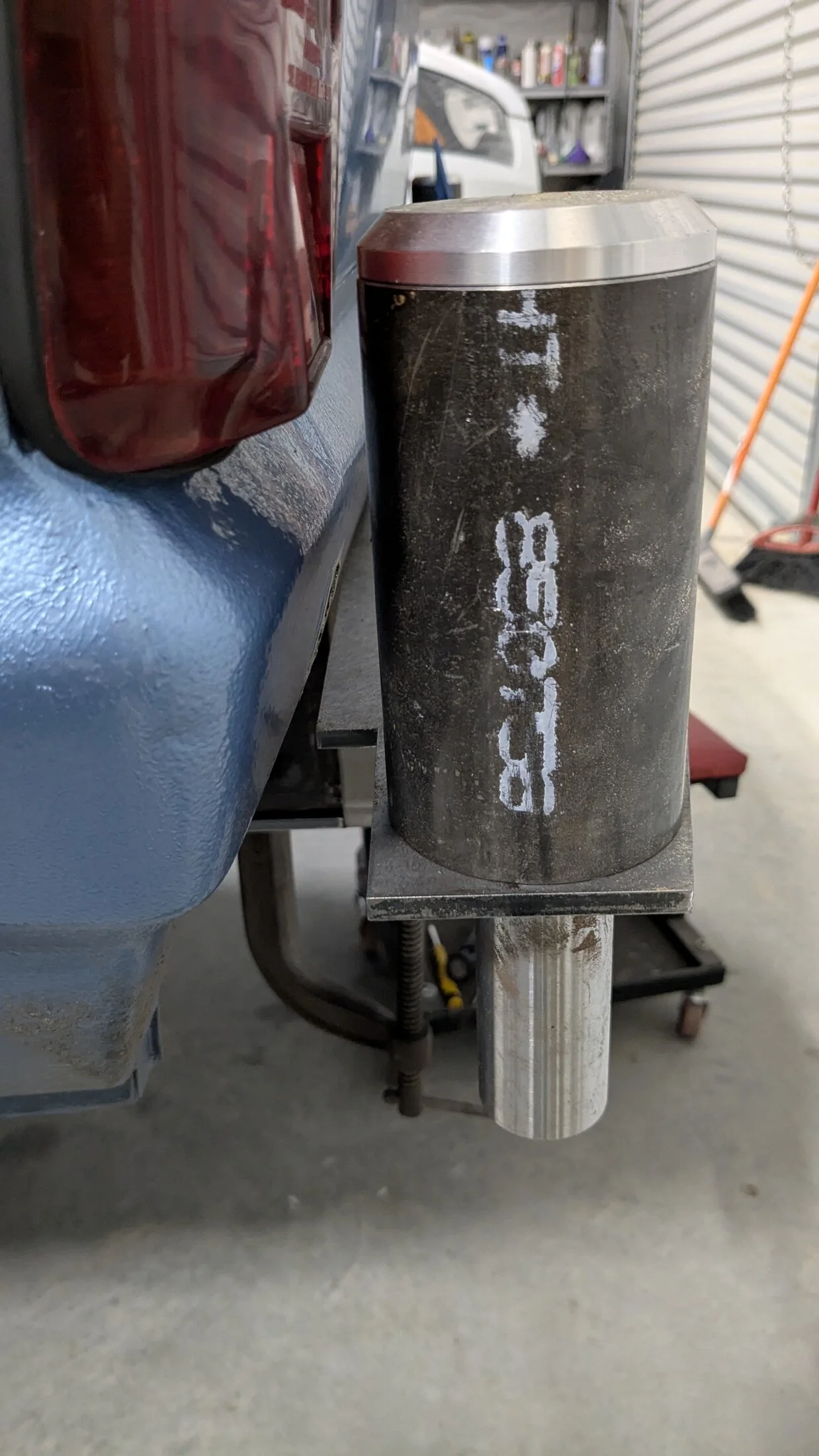

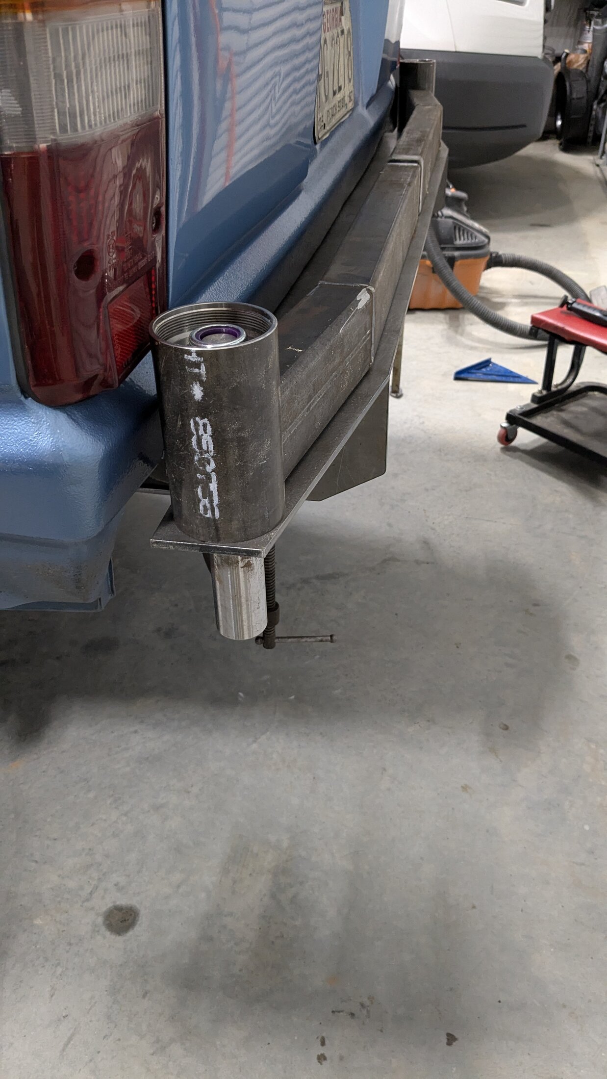

Working on a DIY rear bumper... only bought the thing 3 years ago.. :/
How much gap should I give between the swingarm spindle and the tail light? This is 10mm and Looks tight to me, but I wonder if there's that much flex to a fully welded bumper.
The tail light housing comes straight back since it has the light dividers in it. I would pull that housing to test light bulb replacement
d'oh, hadn't even thought of that (I blame the 93F/78%RH shop)... probably as good a place as any to set it. thanks
EDIT: Didn't feel like bumping the whole thread just to say that 17mm was the perfect distance (ironically, that was the same measurement as from the rear-most surface of the body mount and the forward most of the bumper brackets, made for easy adjusting). Lens has to be slid out to the side, but there's plenty of room to do so AND get the housing out too, if there's a need. Made sure to check BOTH sides, just incase there was some twisting weirdness with the frame but all was the same on both sides.
Thanks again BurntToast for pointing out what should have been blindingly obvious, but wasn't (to me).
