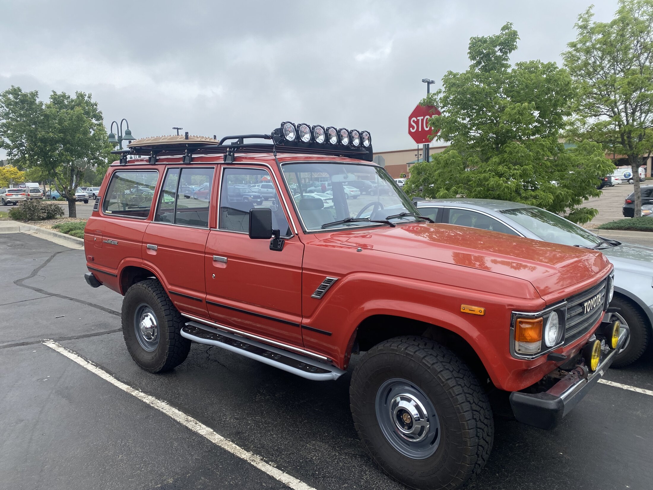

what lights are you running on the roof rack ? they look good. I'm thinking of something similar. what did you use for the wiring channel down the side of the windshield?
Thanks, these are the KC Gravity pro (7 light version)
The strip down the side is also sold by KC.
