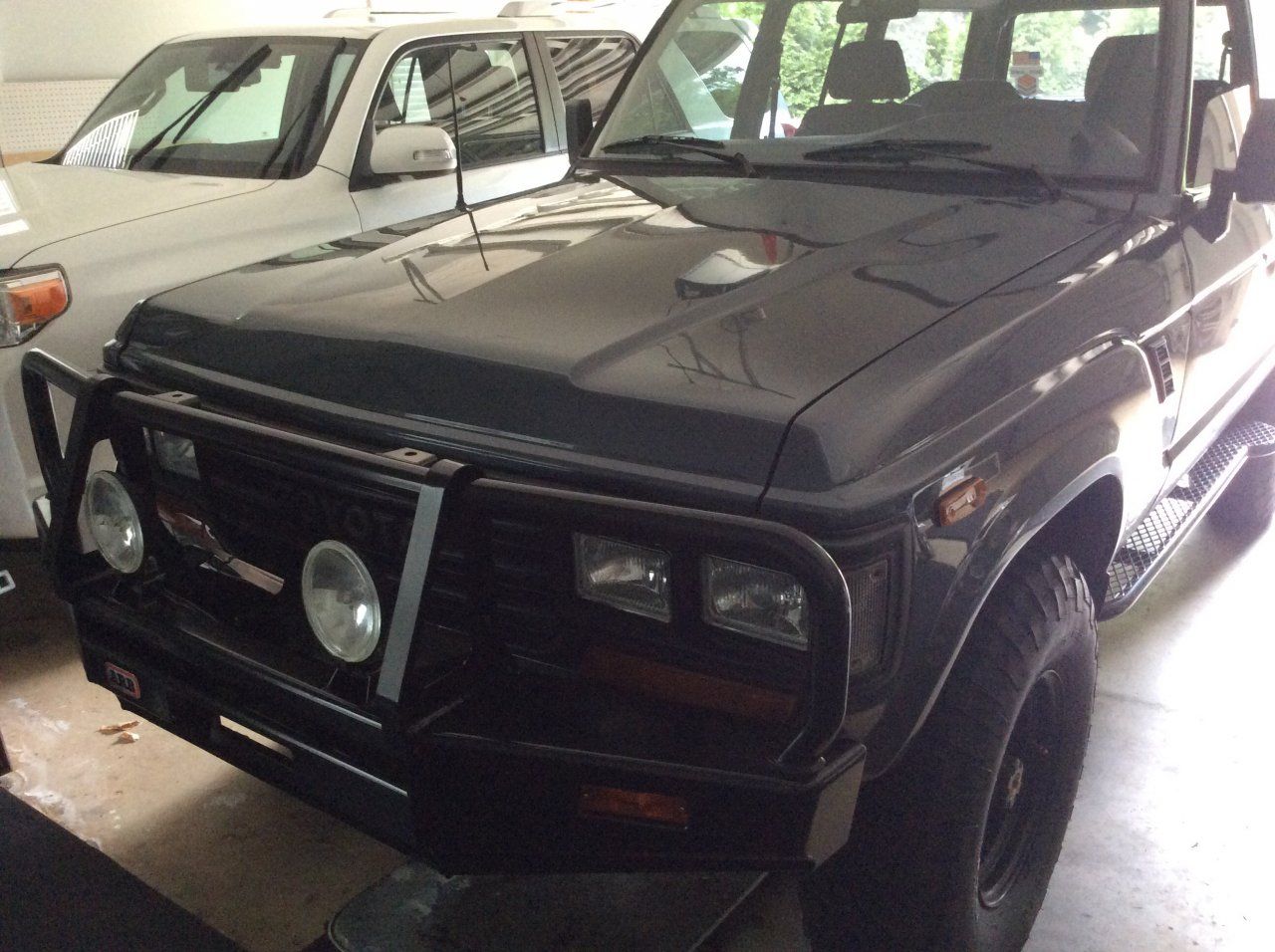

so drillduty...tell me about those awesome rock sliders you got there.
Fabricated by @NCFJ vendor here on MUD also has ads under HFS. In addition he did my Vortec Repower.
