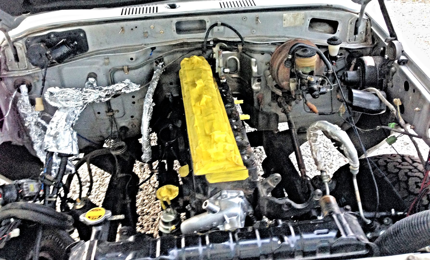

And prepped the engine/engine bay for painting:

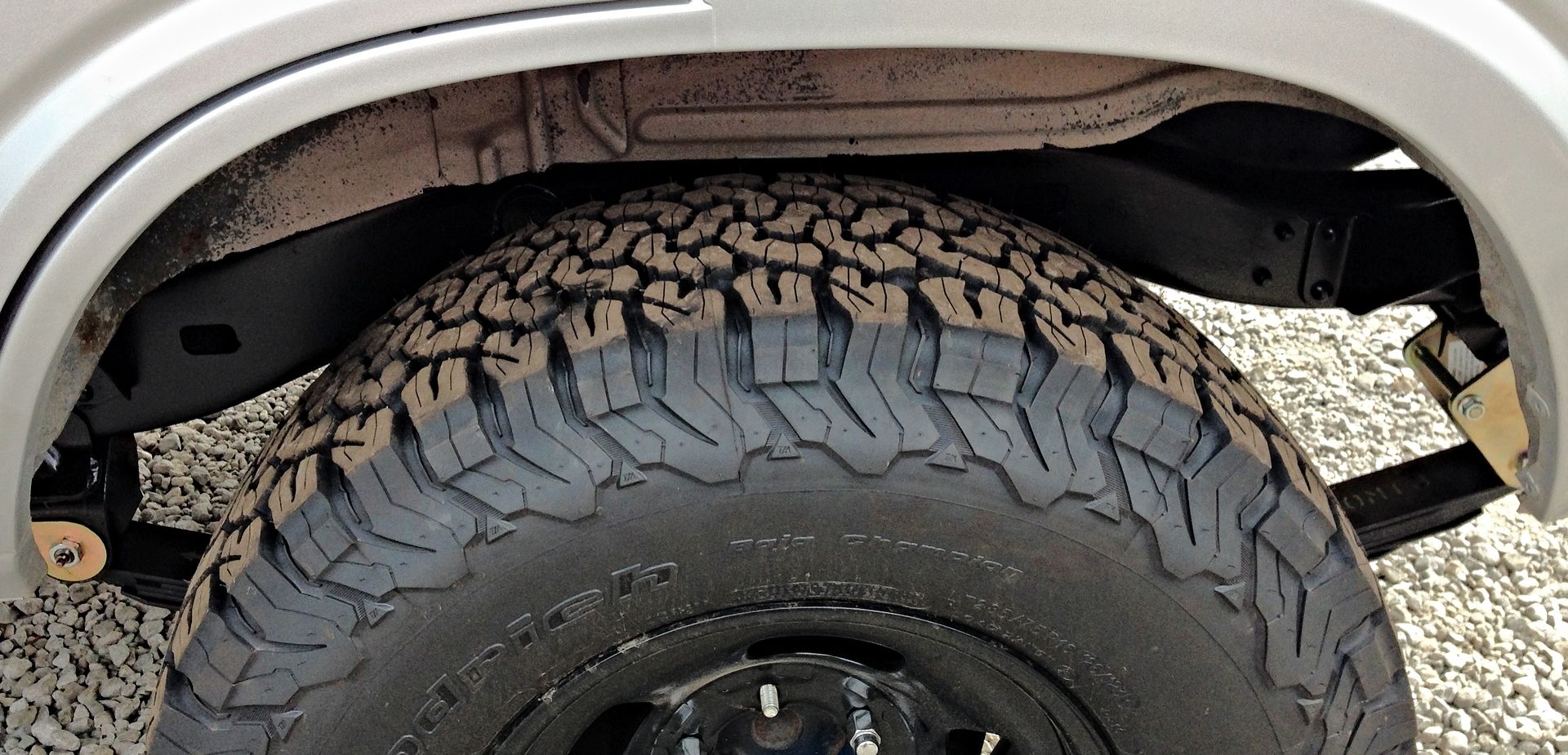

They are Yokohama 742 s and say 7.00 r15 on the side wall. They are radials and D rated. At the shop , we were tripping on how skinny they were. I was worried about drifting all over the road but they handled way way better than I thought. A firmer ride than my prior bfg at 30x 9.5. They are skinny but don't look lost in the wheel well. View attachment 1054615
Looks proper by my eye. After having a 7.50R16 tire on my rig for a number of years now, I'm so used to seeing it that when I see a 60 with fat tires, it looks goofy to me.
I've found that general drivability improved with skinny tires. High-speed corner handling is down, but I wouldn't want to drive like an F1 car anyway. I wish the Yoko 742s came in a 7.50R16.
I put 285/75/17 Nitto Terra Grapplers on mine a few weeks back. replaced 12.5x35x17 BFG MT. About 1.5 inches more narrow and an half inch less overall height. Rides and steers so much better I couldn't believe it
