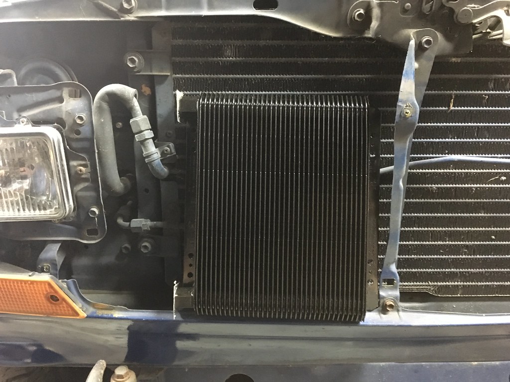

Got the transmission cooler in the mail today. Need to fabricate some mounts:
Trying to figure out the best line route. Do people have the lines run through the large hole in the frame below the radiator?:
Seems like a direct path to the tranny cooler lines in the engine bay.
I run mine on the same opening where the AC line (shown in the first pic) comes out .. as there are no sharp edges that could chafe the hose. I also run it inside another hose for good measure..
Thanks! I wasn't sure if there was enough room there but sounds like it will work. That would be the cleanest route. Thanks!
