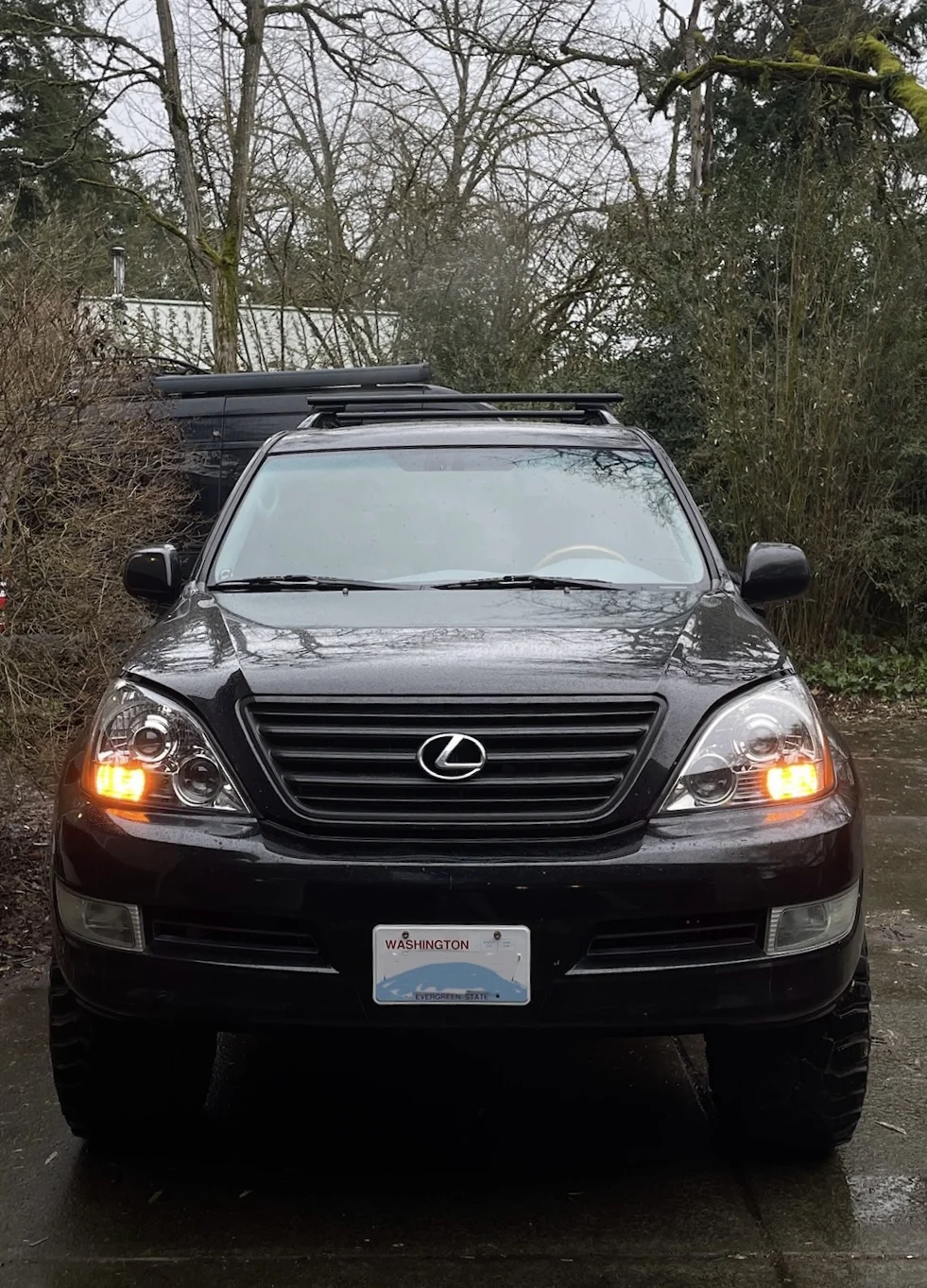

Replaced the headlight housings and added LED DRL/blinkers. So much better!

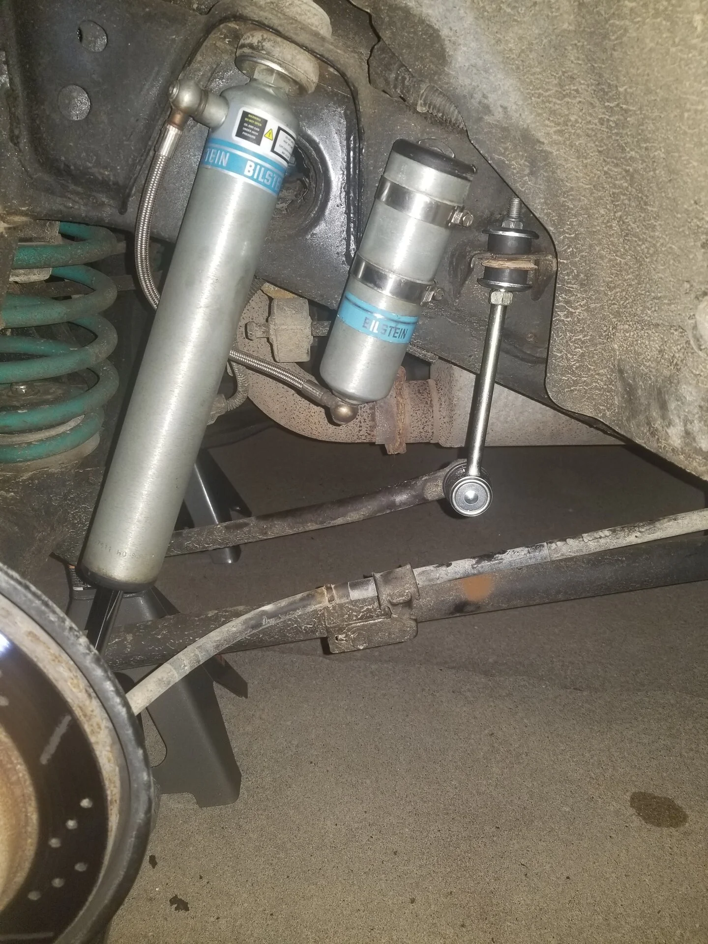

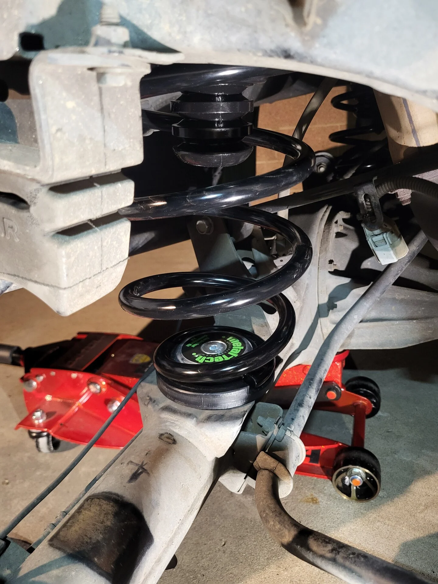

I have ~3" Dobinsons LT and the sway bar was not a limitation in travel. The lower control arm contacted the axle tube before the end link and sway bar maxed out. The 2nd gen links get the sway bar pretty close to parallel vs the lower arms. Heres how they looked with my old 5160 setup.
I have ~3" Dobinsons LT and the sway bar was not a limitation in travel. The lower control arm contacted the axle tube before the end link and sway bar maxed out. The 2nd gen links get the sway bar pretty close to parallel vs the lower arms. Heres how they looked with my old 5160 setup.View attachment 3579297
This is great info thanks. What particular links did you use?
Proforged or something like that if I remember correctly; nothing fancy or expensive. It was off Amazon a few years ago, so I don't remeber the details.

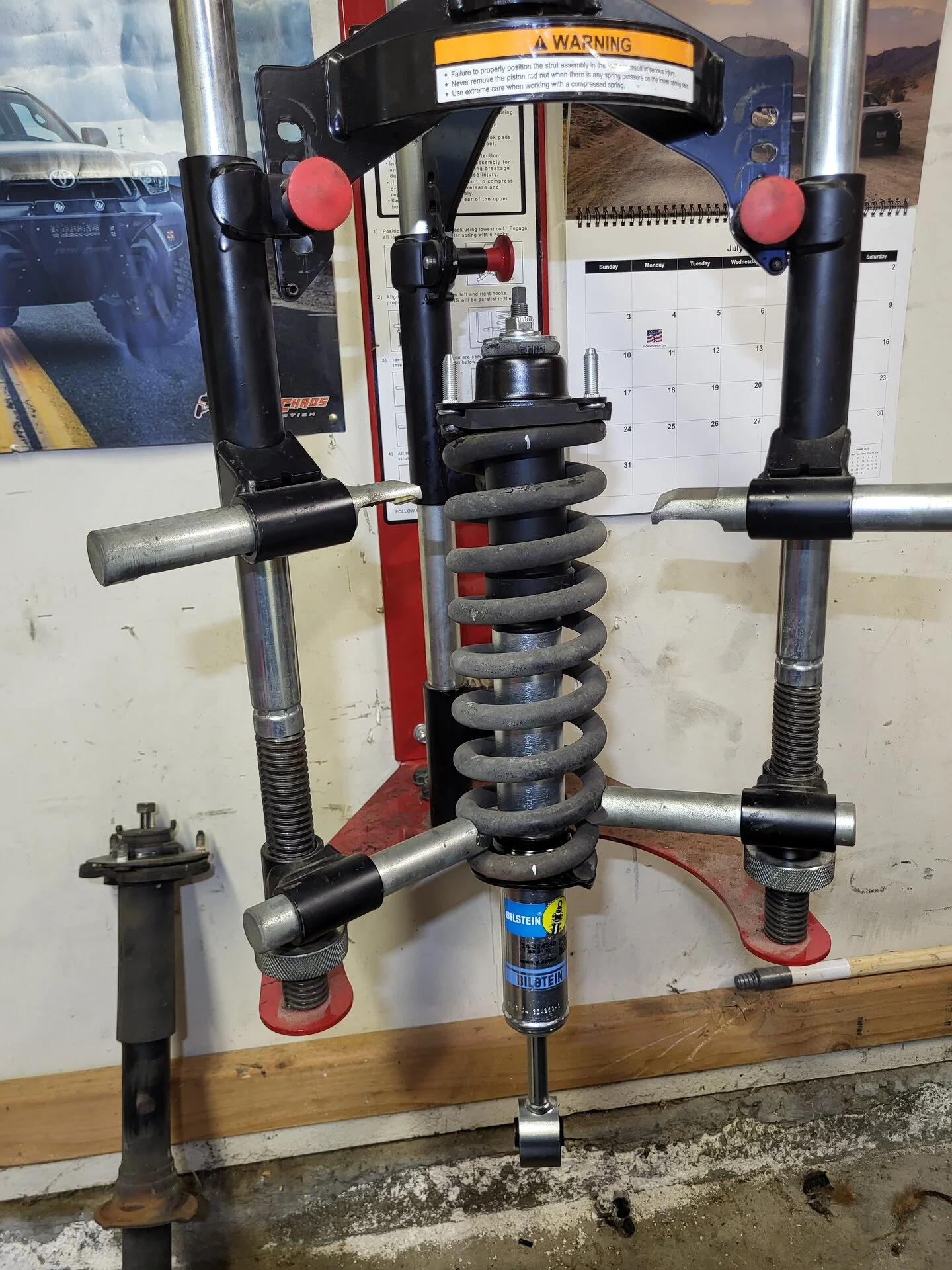

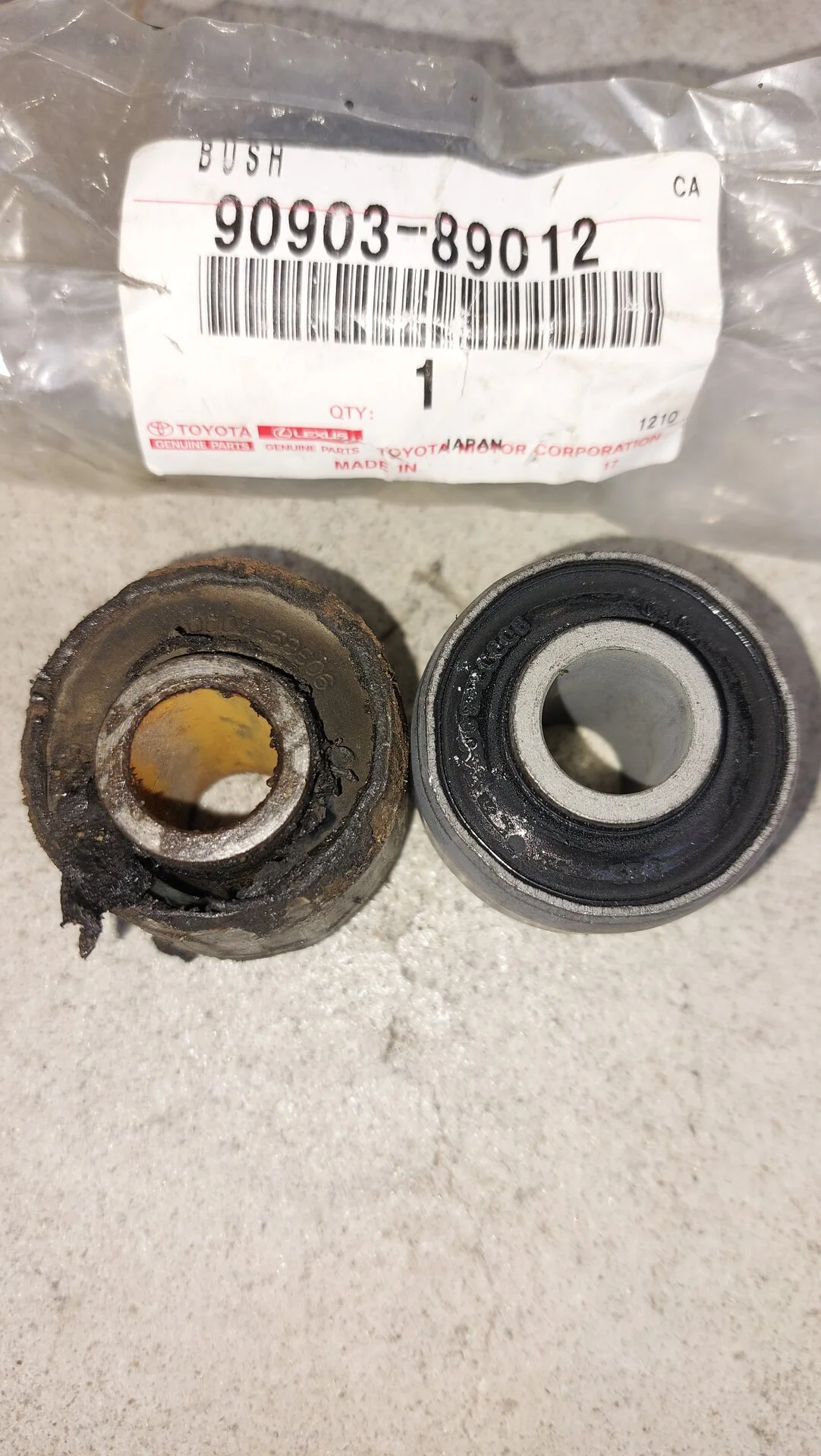

In case anyone else has Bilstein 6112s and your lower bushings get blown out, OE Toyota/Lexus part number 90903-89012 is a direct replacement since Bilstein won't sell a replacement.
I used a ball joint press and 30mm socket to push the old bushing out and press the new one in. No heat or anything needed. Easy job and got rid of a very annoying front end clunk.

I have done this, but on Tacomas as I lift a Tacoma almost every week. Common issue with 5100/6112. They fail more often than one would imagine. Definitely want to torque that lower shock bolt once tires are back on, vehicle on the ground.
