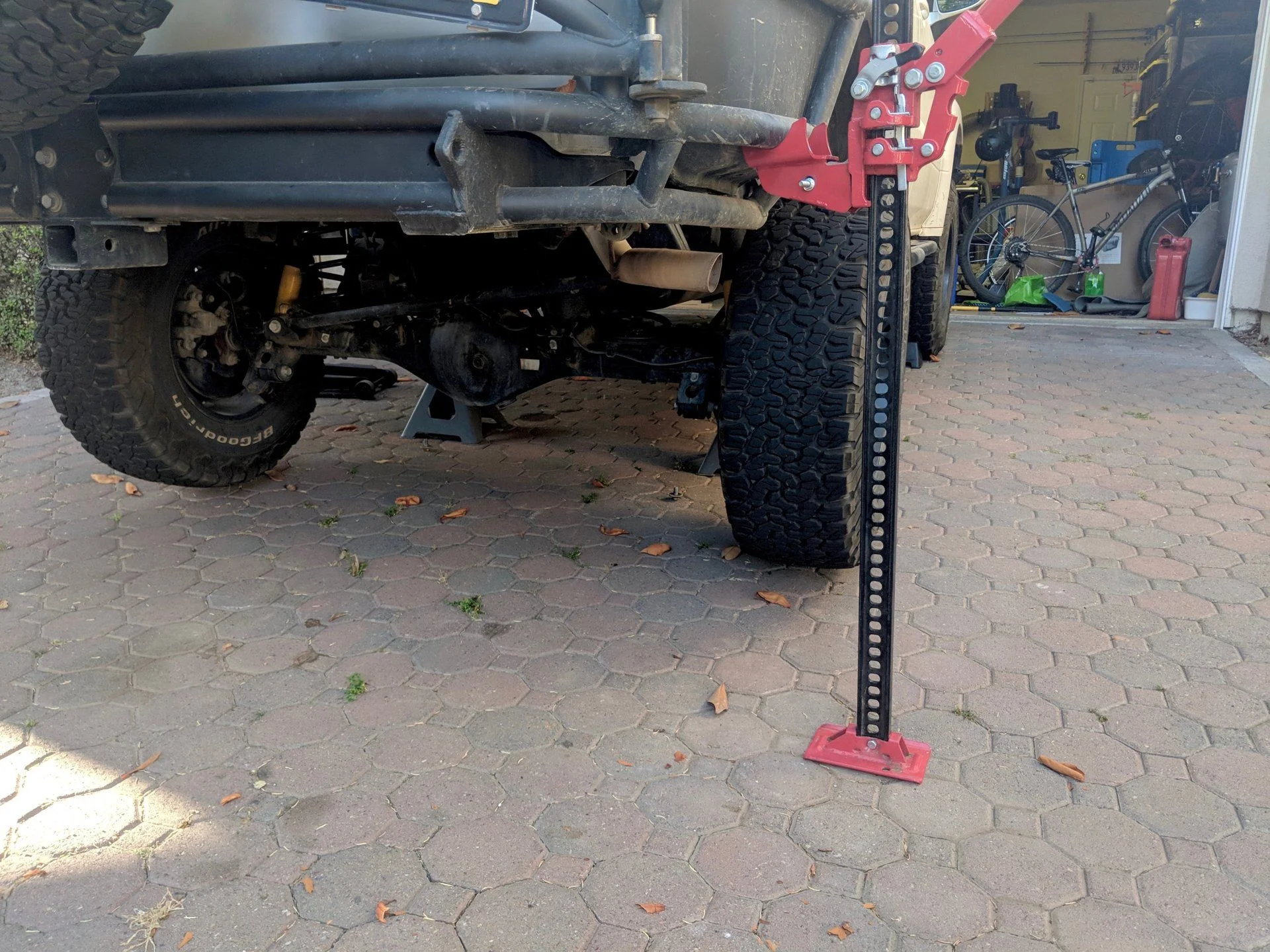

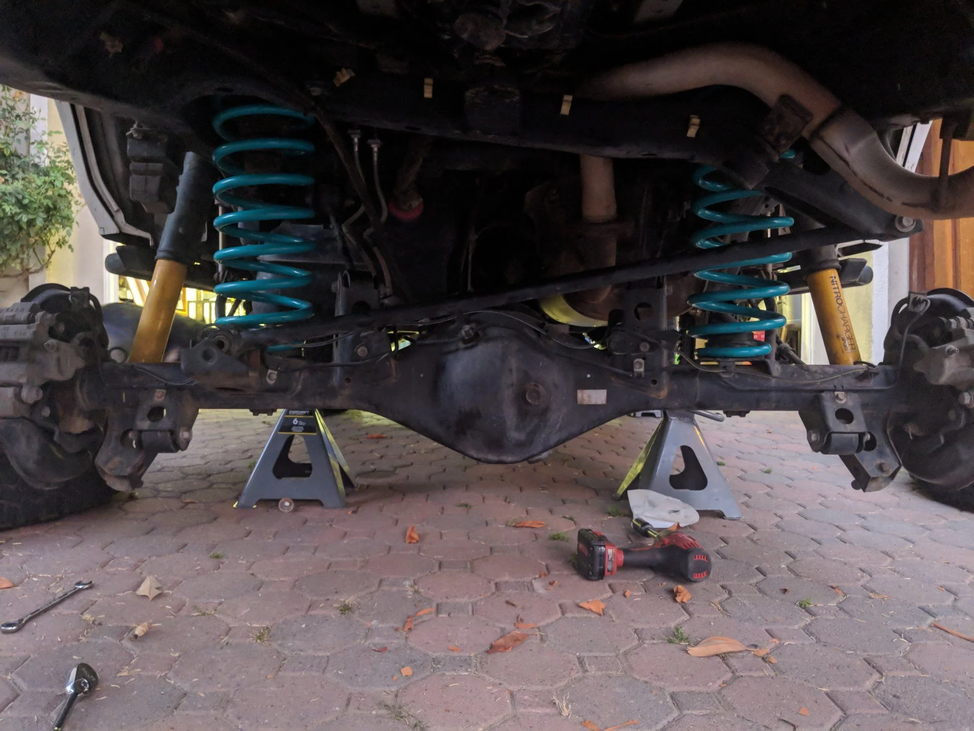

A spring compressor.... a bottle jack .... and a lot of effort. Dont think i've done a tougher job on the GX so far.
Along with several choice words along the way.
Oh, make sure you disconnect the sway bars as well. The more you can free up, the better
Thanks all for the tips. I've got my choice words ready!

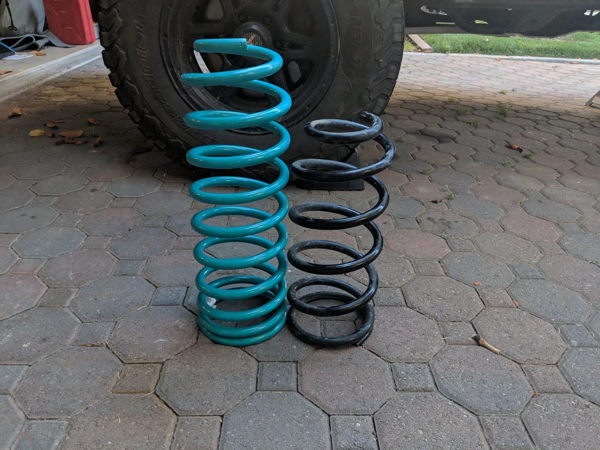

They're C59 701V, 600lb load 3" lift. Hopefully it's not too much
That’s about the same as my MT LT rear coils. You’ll be good to go! Hardest is the drivers side with gas tank. Not as much real estate to play with there. Passenger goes in easier.
Ok a few sweaty hours later but they're in! Cleaned up my tools in the dark so no "after" pictures
Definitely taller

And I needed a boost past my floor jack
2032921

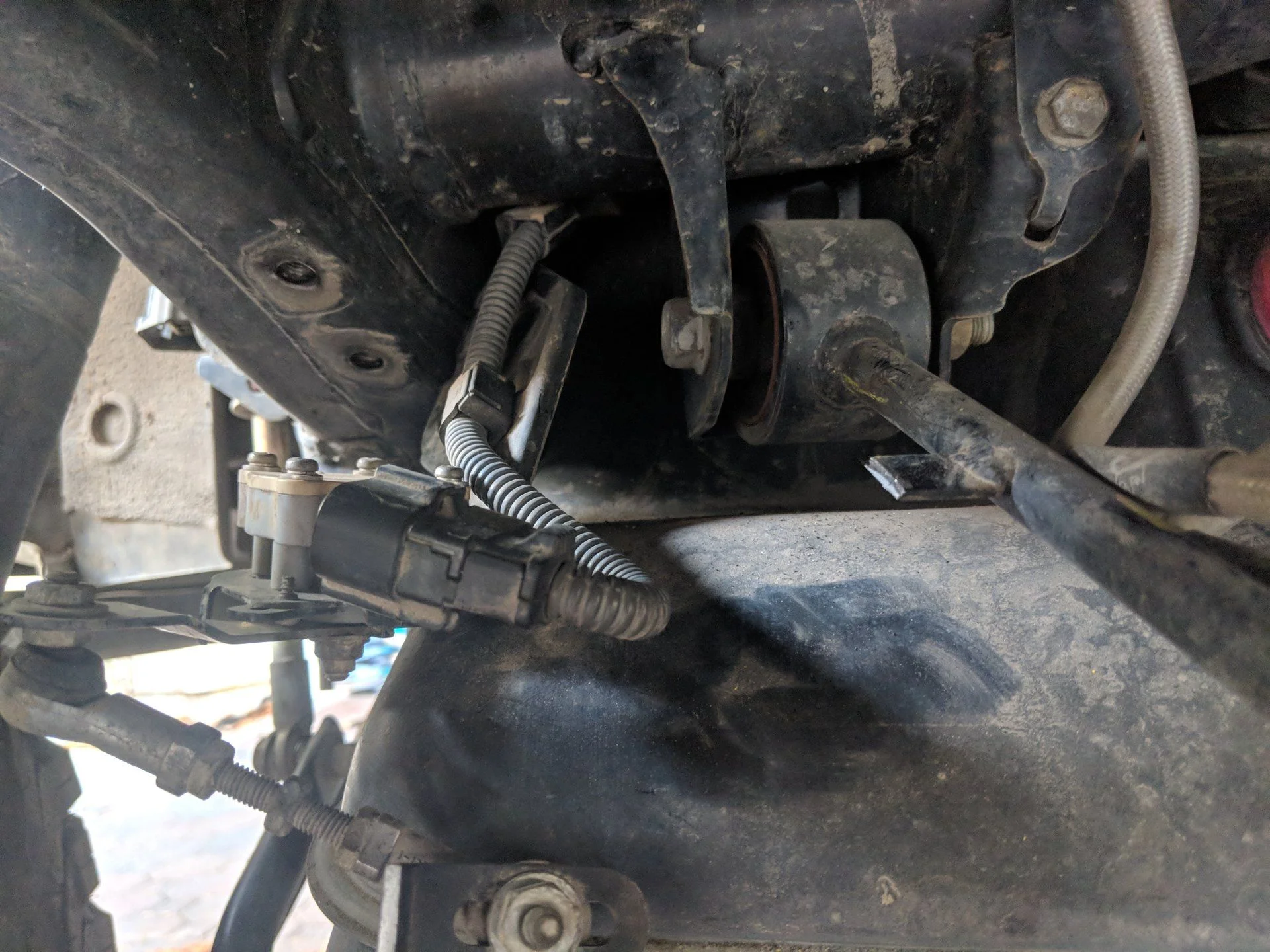

Took the opportunity to get rid of the old AHC brackets (had my angle grinder in hand and then a little voice in my head said "gas tank" and I chickened out and used a hack saw instead for the DS)
2032919
But they're in and everything is buttoned back up
