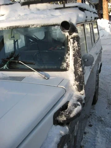

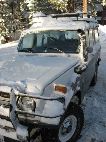

Nice to know about the silicone spray. Looking forward to that snorkel pic
Well, I made a snorkel out of 3 inch ABS. I cut the ABS for make the angles and glued it together... rather than plastic weld... it is basically the same thing anyway and a bit easier. Also make a cover for the vent out of one of my old mud flaps from the T100. On the inside, I just used 2 inch PVC and stuck it straight into the intake hole on the stock air box. It fits right in. OD is the same as the ID on the air box. I attached it to the body with velcro straps for now and have Super Quick Fists on the way.
And yeah.. it's cold here and I use a bungy cord to hold the door closed for the AM commute, until she warms up.
