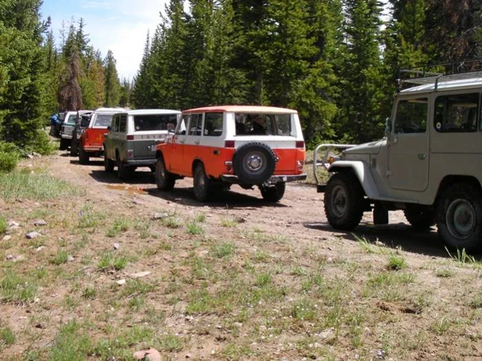

From this weekend:

We just made it back from that same trip. Had a rear brake issue that delayed us joining with everyone on day one.
Carmon, you'll need to get out and join the "Relic Run" one of these years. Your truck qualifies all you need is some old camping gear and stuff. You and the "piggy" would fit right in.

heck yeah I will. Where was it? looks like fun
