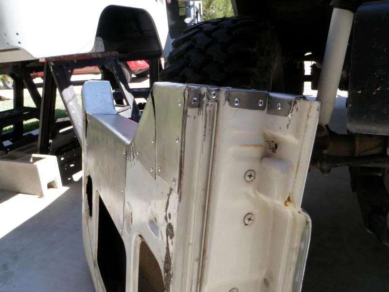

finished the fab work on the P/S 1/2 door
D/S next
gonna paint to match the rig, and wrap grey indoor/outdoor carpet for the inner and over the top, to keep it cool
