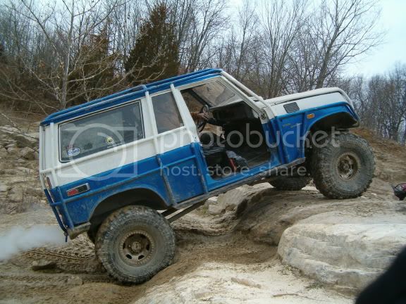

Stock wheelbase +1...inch...if i was cottin to chop me anether un... kinda want to; kinda don't... I'd go back to about 1/3 of the way up the leading edge arch of the rear well, go straight up, right thru braced and gutted rear doors to the top of the door rail and then bridge the gap between the sides at that height with a solid bulkhead and a cap plate. Add some beefy cross members to the floor to tie the rockets together and tie the rear crossmember to the rear bulkhead (removable hart top) cut the b pillars and think real hard about a fold down windshield (virtually impossible$$$)... now, the rear doors MUST open suicide style and if enough beef was afforded in the rockets, crossmembers and rear bulkhead, then the b pillars could just be added to the front door, and you're left with an extracab and chassis- the most functional IMO...a fixed hard top with a fixed b pillar and rear doors that open either way would be cool too...,BUT, I would cut it at LEAST 5" aft of where I did on this ol rig, closer to 9...but then, then you have to go to 63" rear springs and relocate the axle and shock mounts if you want any kind of real bed, which means a new custom gas tank and a new drive shaft and whatever you must do while you're in there.,,the first step is a doozy...I thought about it for over 2 years before I considered doing it...shoulda thought for 3!!!
there was a white bob job (no poke at BOBm) in Los angles in the 90s when i lead the tlca there . was short but functional rear window , the truck that started my swine flu . i need to pull our old records out of the atic and see if i can find him , .. all of my major projects are wraped up . and i have a 74 that is heavily rusted from the door handles down . so its no crime to massage the tin some . i wish i had some pics of the one i saw i remember it cut right after the ft door with a full rear quarter window
I have always liked the proportions of @Gumby 55.
Or
pigbob-jpg.273174
