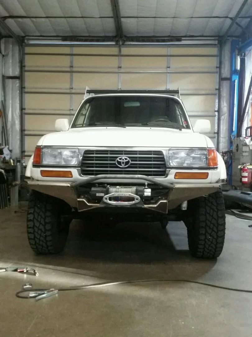

It sold sight unseen to a guy in Atlanta. Been looking hard and saw the build thread in 80's section and made a deal. Im having some seller remorse as it was by far the fastest 80 I ever drove and turbo whine is cool:D
Where you attached D rings to the front bumper are designed for using a jack not a anchor point. My plan is to use the downs from 80 series front and back. Need to source another to have four. On the front will require a spacer with the bull bar. For now using two of the front hooks front original bumper. Mine has hole that match the bolt pattern in the vertical pieces.
I might have the downs off of my 80 if you want I can look for them

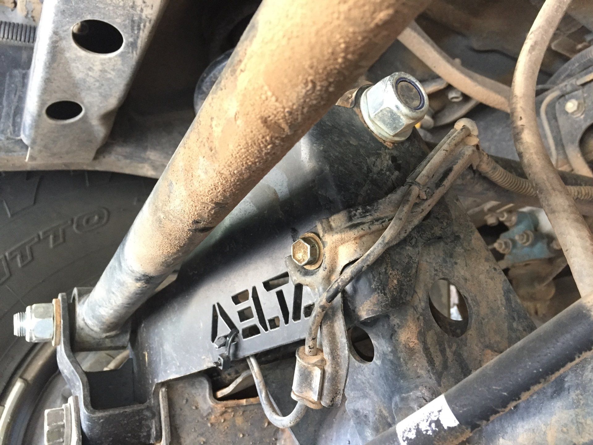

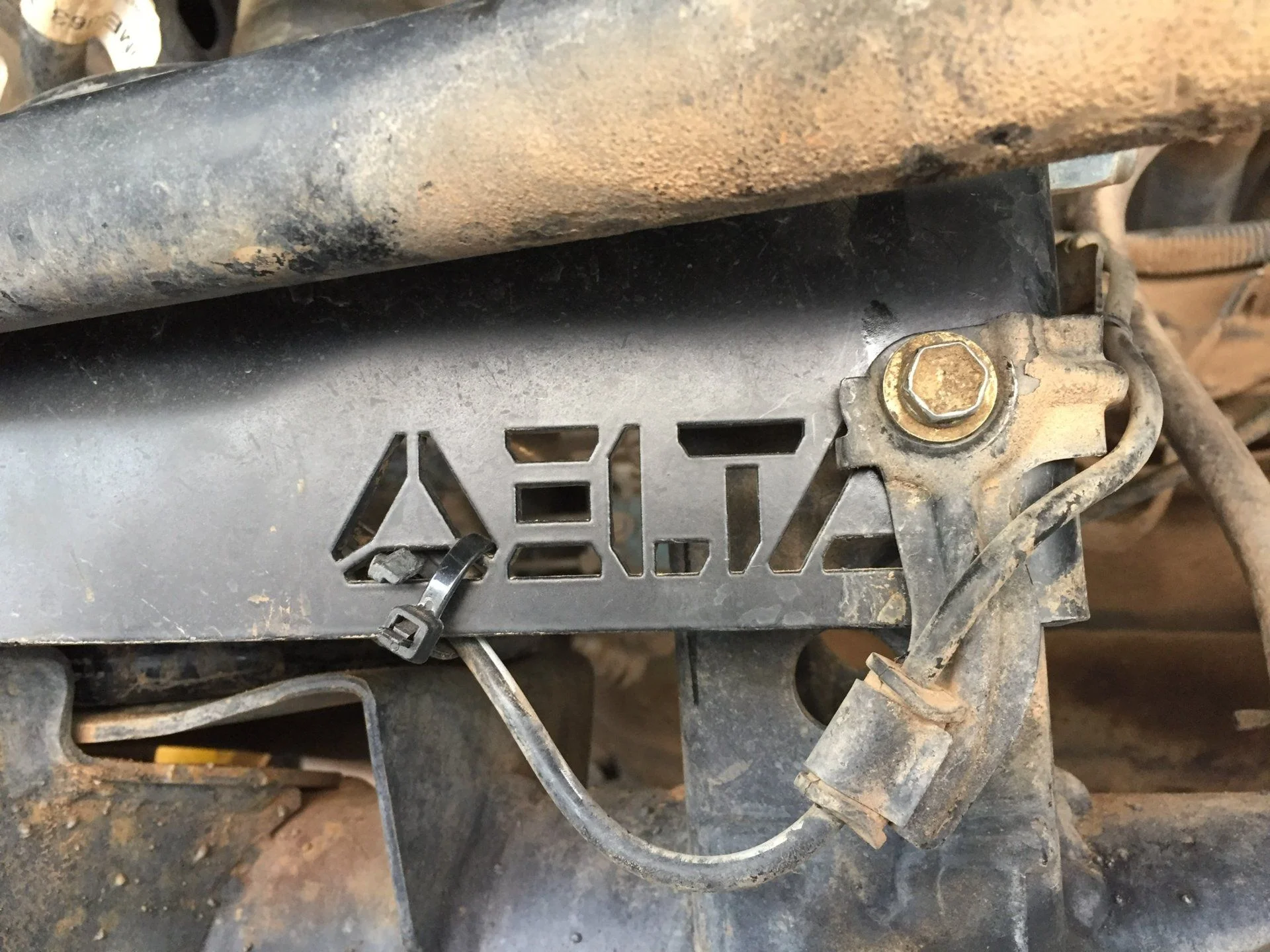

Added a new hole and tapped it for my ABS line on the Delta bracket. I really like the way the truck handles after the install of this panhard bracket, makes the truck feel like an unlifted rig.

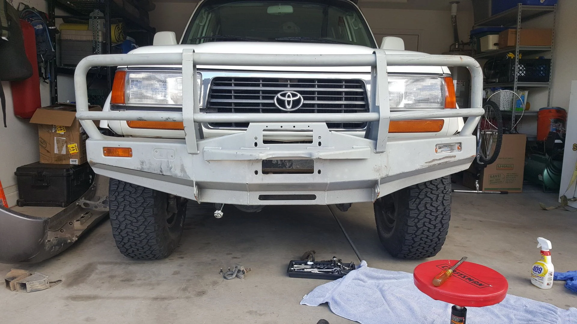

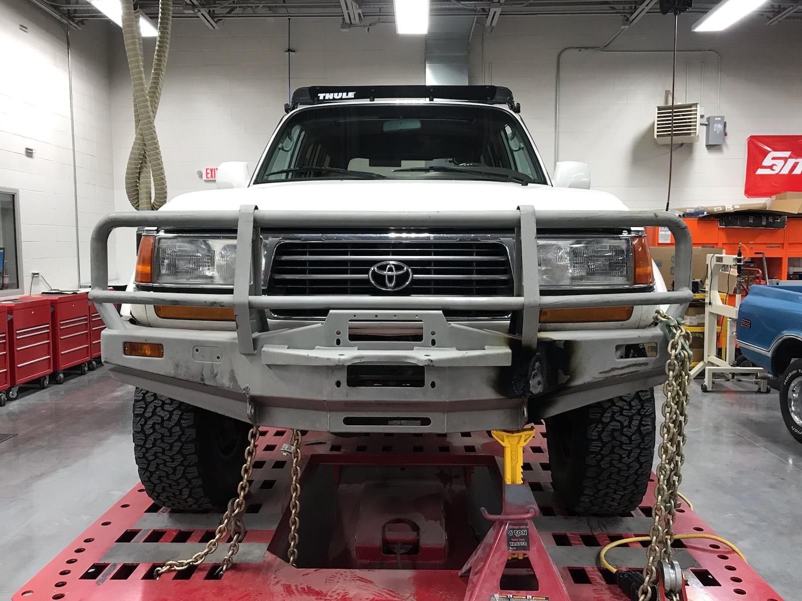

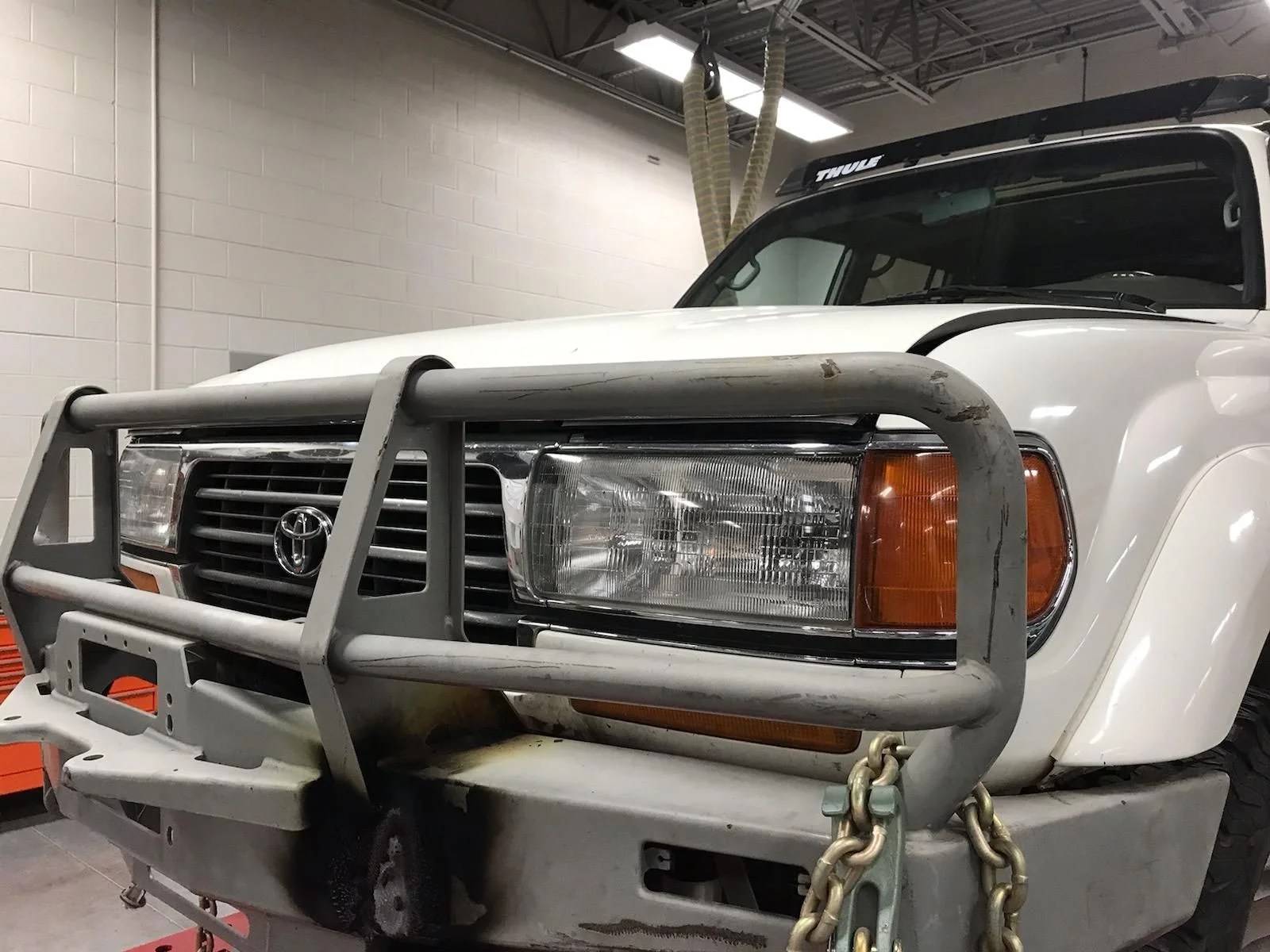

A couple of "before" and "during" shots of my ARB recycle/resurrection project. This was purchased from @Spamcheese and was on a truck that he purchased from @medtro. So we're keeping it in the club;)
High school students at the school where I work are doing this for me which makes it that much more rewarding to save something that was damaged. It was tweaked pretty good and it had a twist in it. It took a little bit of heat and well over 10,000 lbs of force on the frame machine to get it right. It put up a fight and surprised me a little bit at the strength of this bumper. Paint should be done by the end of the week so I'll post "after" pics soon. I think the students were pretty excited to work on something besides a smashed fender or a scratched door on some boring sedan.
you are training 'em up right Mattman!
Wish I could take the credit but I'm just the director of facilities/construction for the district. The auto collision instructor there is pretty talented and does a great job with the students. I'm fortunate enough to be able to use the equipment and sometimes the skilled labor for a nominal donation to the student organizations.
