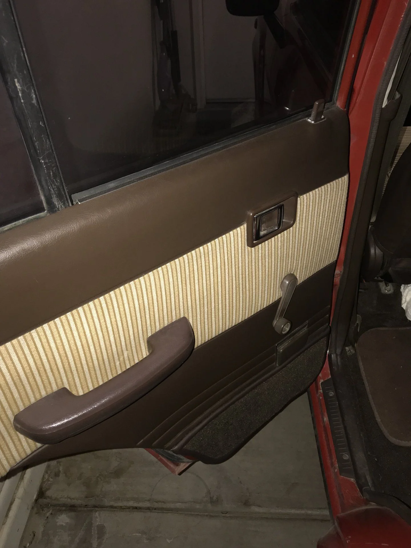

I finally started body work on the 4Runner. It had been in a couple of slow speed accidents. One did some front end damage. The second was from rolling back with the DS door open. This damaged the door check at the a-pillar and pulled the door hinges away from the body. A new door was installed, but it required about 4mm of shims on the door side of the hinges for the door to fit. Needless to say it leaked a lot of air. A temporary fix was to pound the hinges back in. This worked, but there was still a lot of air leakage, especially from the vent window. I sourced some new-to-me door hinges over a year ago. I've been avoiding replacing them as it was my understanding it is really hard to align a door if you completely remove a hinge from factory placement on the body side. Guess what, they are right. That is they are right if you try to do it by yourself. I cussed and struggled for an hour by myself. Finally the Mrs came home and it was an easy-peasy 20 minutes. Door gaps are within 0.5mm of the PS now and no more shims are needed. :bounce:
The best news is I have no more air leaks, even the vent window. I guess the damaged hinges warmed the door just enough to keep the vent window from sealing all the way. I think some new weather stripping will take out the last of the air leaks. :bounce:

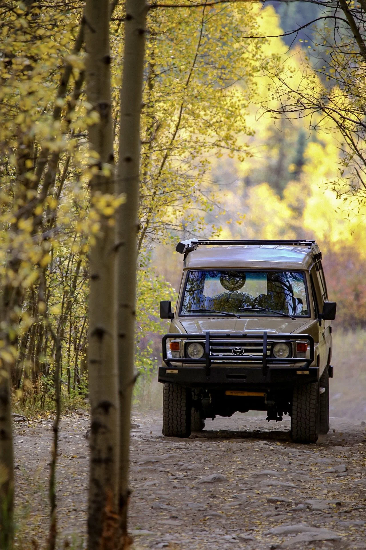

What's the story with the LHD B/F/HJ75? Looks extremely clean.
That's Eric's, the gent who builds Campteqs. It's a 92, 3F powered, originally imported from Colombia. It is clean - recently painted, and those lines are so elegant -- a beautiful truck.

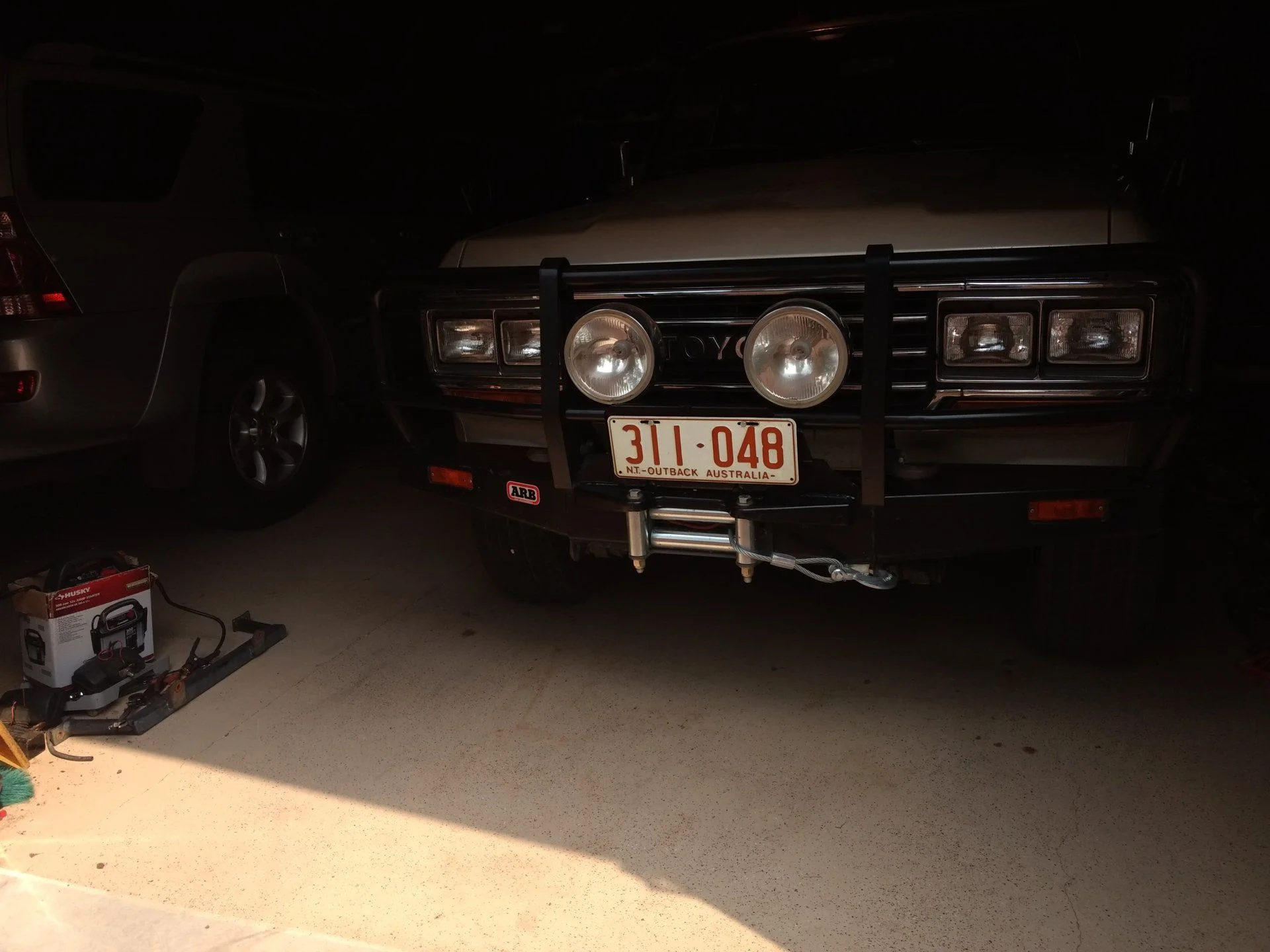

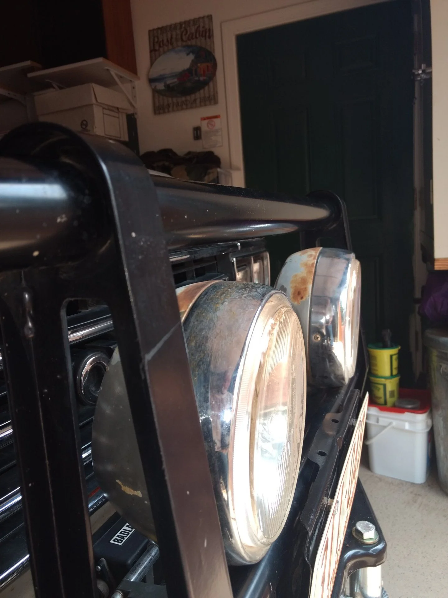

Playing around with off road lights tried these on for size.
These are some old IPF lights from Australia. Having a hard time trying figure out what they are. Never intended for the US market, no SAE on them. One has a grounding thru the chassis issue but the lamp is good. With just other one on my hand heats up from two feet away. I know never going to get good gas mileage in a 60 series but with a the lenses being concave may actually hurt mileage if not cause heating over heating from disrupting the air flow.:rolleyes:

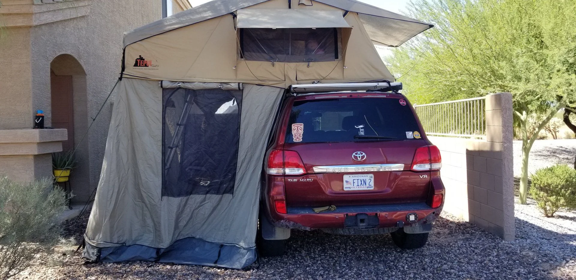

Friday night I missed the club meeting, to install airbags inside the rear springs.
using a 4' prybar to lower the KDSS arm, it slipped and I gave myself a black eye :censor:
I continued like a pirate and finished up the install, so that Saturday I could pick up the Tepui RTT from @Pitch .
Eric was super helpful and the tent is amazing. the kids love it!
we'll be making our maiden voyage on the casner trip. I've ordered a set of Disc-o-bed bunk bed cots to stack the kids in, so we can all sleep in the tent. should make for quite the set up!
