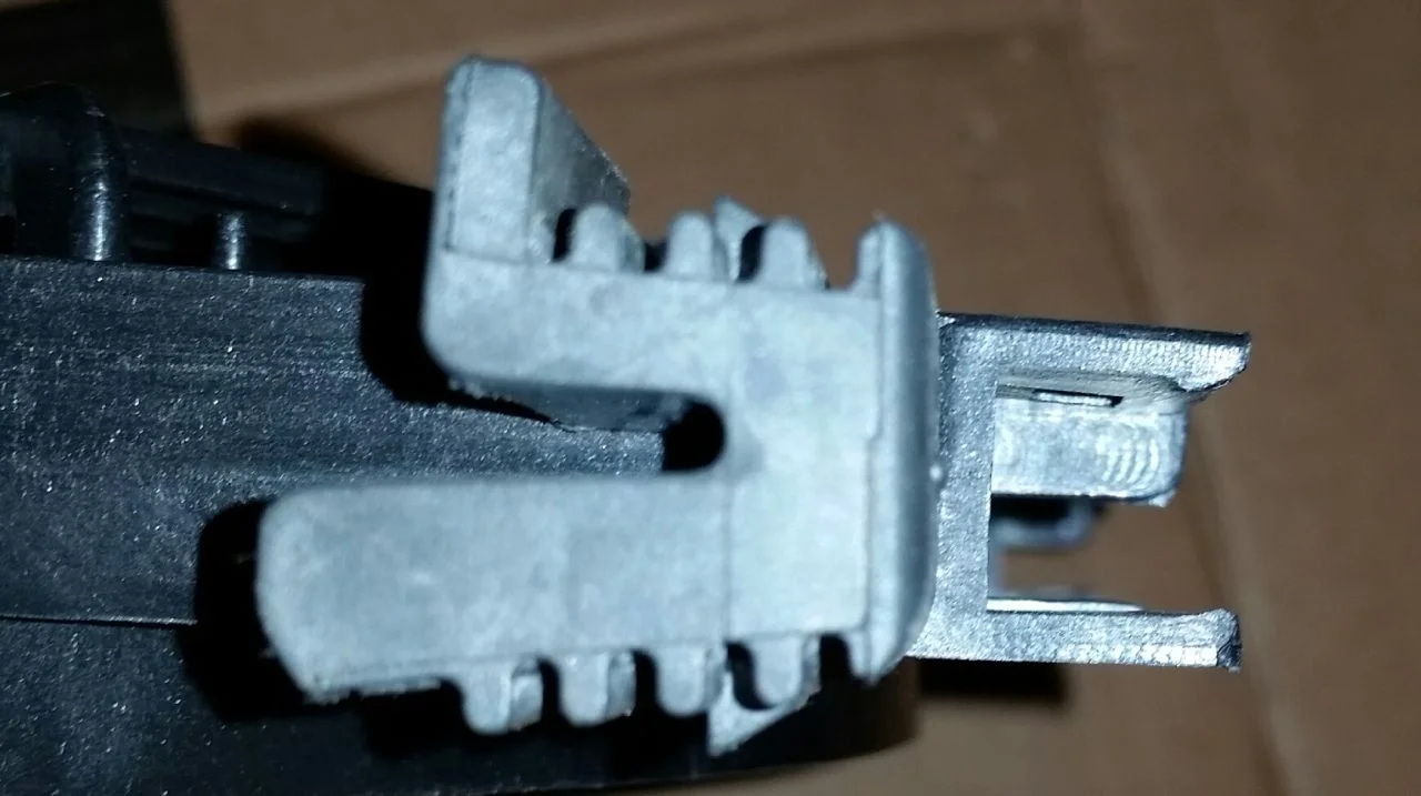

I am not able to find the rubber mounts for 100 series electric fan. I bought 88467-35080 for 4Runner condenser, and had @Saddletramp made it fit into the fan mount.
Comparison of 88467-35080 and electric fan mount. The rubber mount is thicker.
Trimmed 88467-35080 after @Saddletramp did his magic.
Rubber mount installed.

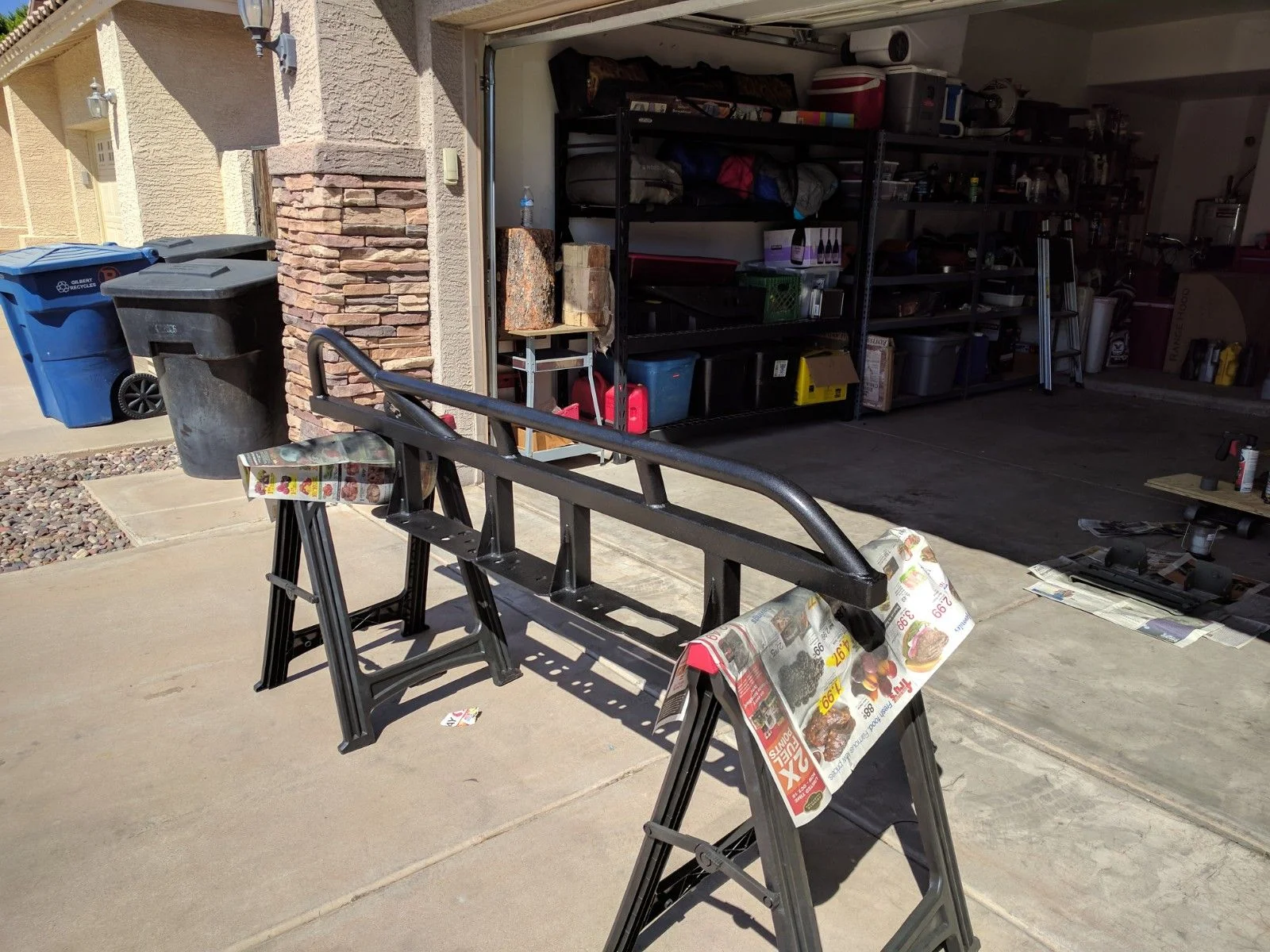

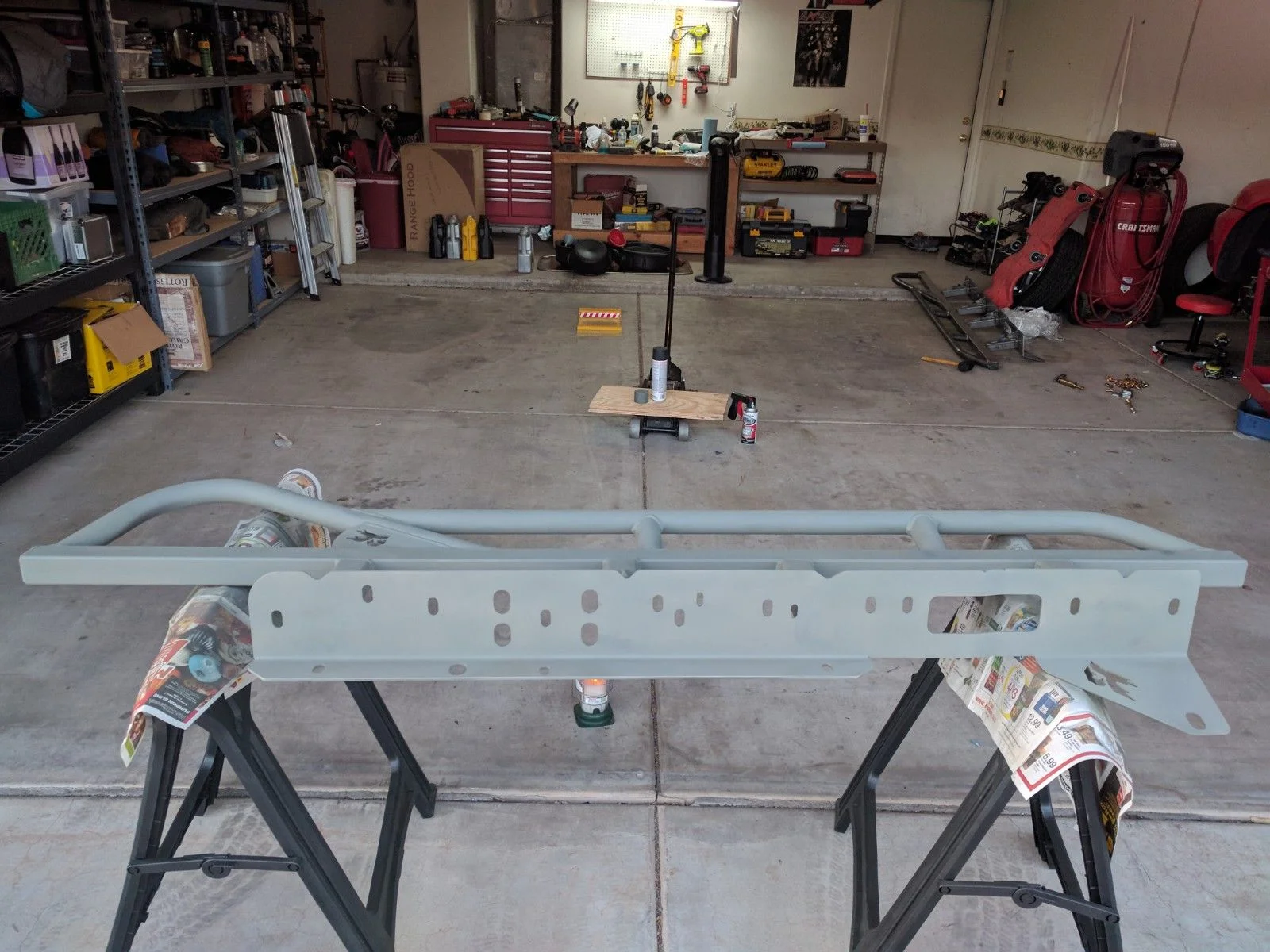

Spent the week squiring, cleaning, blasting, prepping, Re-Bushing and painting the radius/control arms I picked up to be ready for the lift that has been in the shelf for 2 years now.

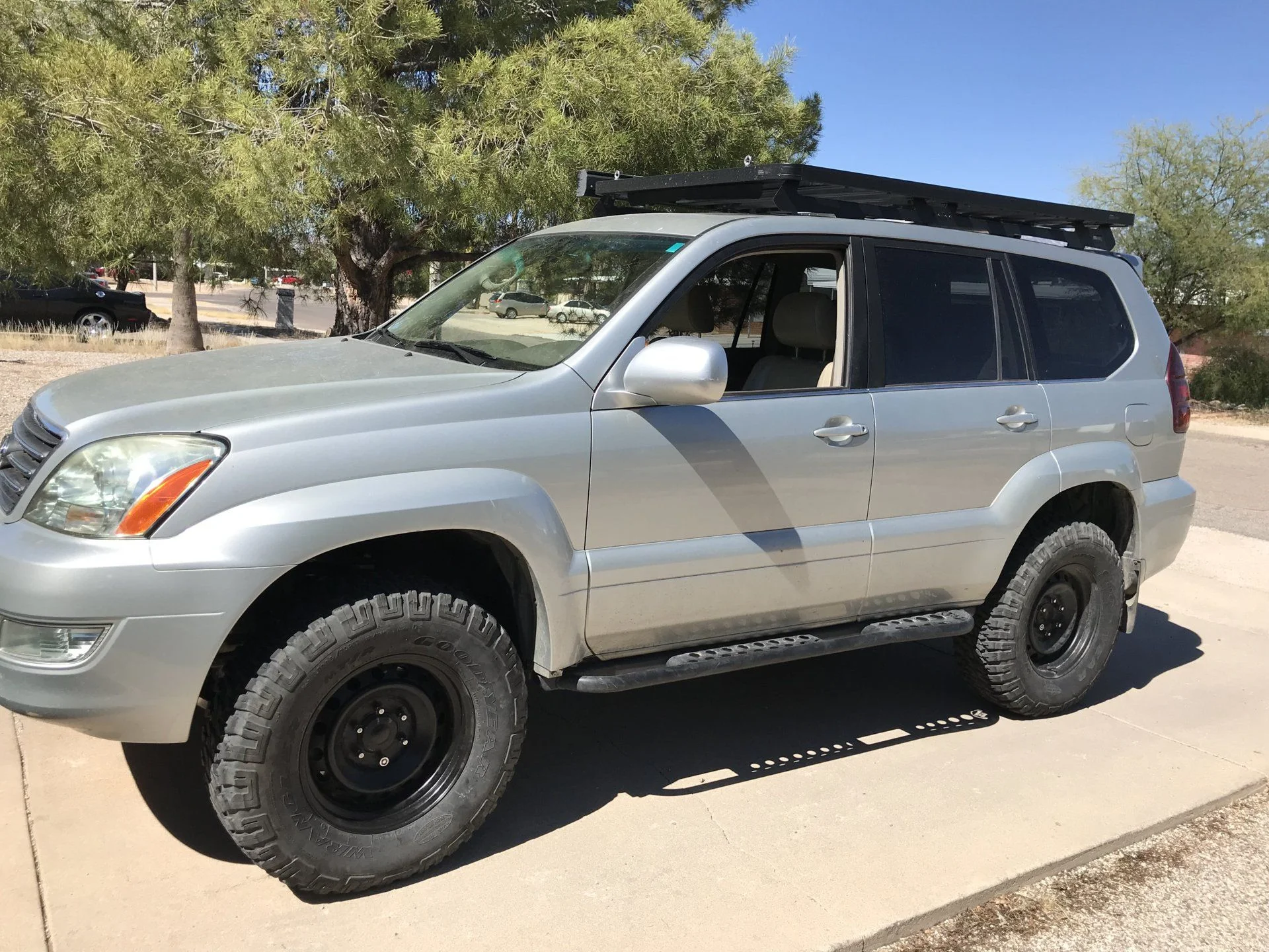

Finished up RCI skid plate (front, tranny, and tcase) install. Also added FJC steelies with old MTRs to the GX today. No rubbing! OME 885/895 w SPC UCAs installed in August.
Checked wheel bearing play in both front wheels, all good. Contemplated replacing original steering stabilizer that's dry and gray on one end and shiny and oily on the other. Figure that may correct some of my steering feedback. :hmm:

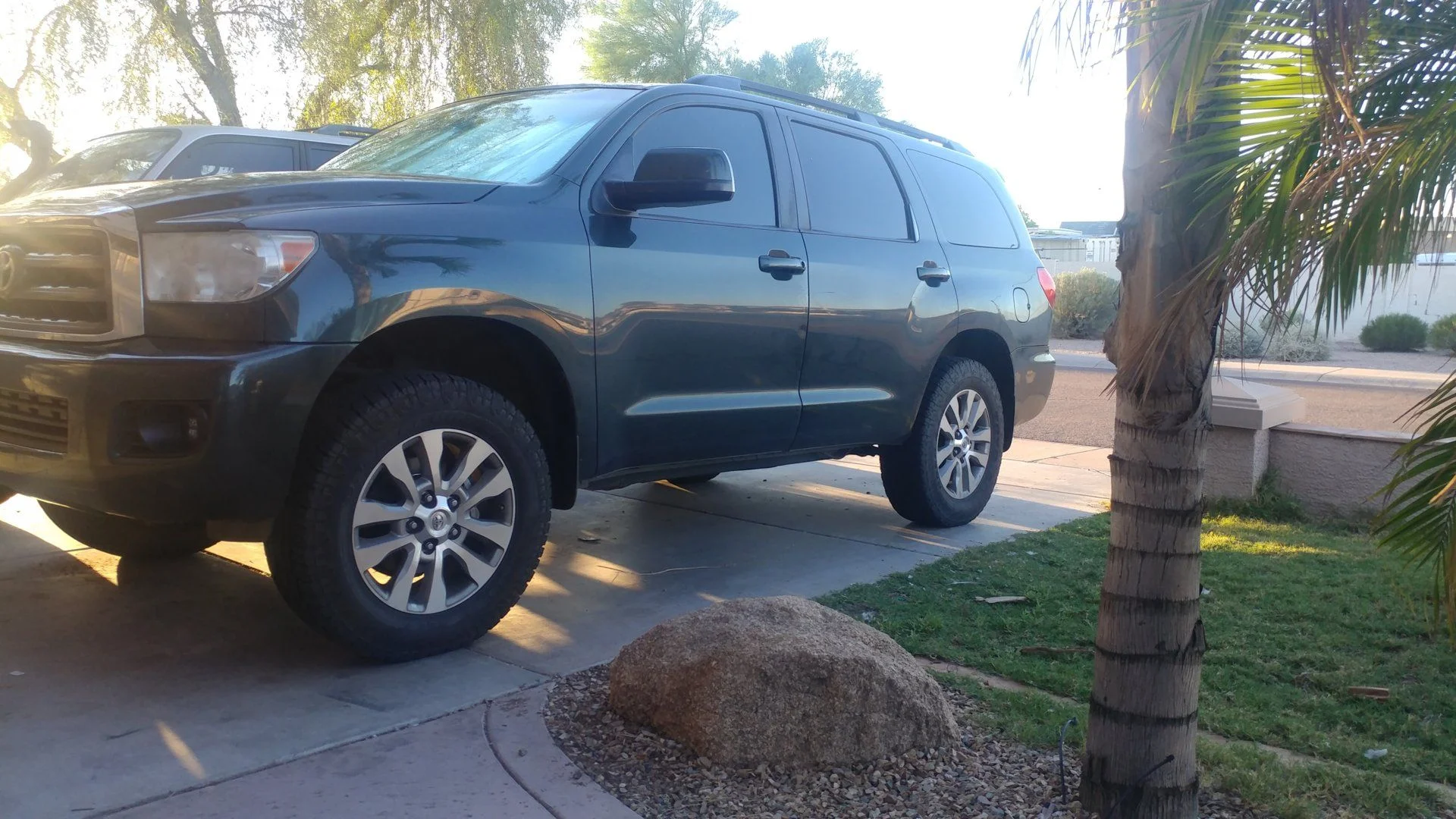

New rubber mounted by CBT 4 - 35" Nitto only required 2.25 oz total for all four to zero on the balancer :clap:1 tire/rim did not require any, perfect from the factory:)
Tested only up to 80 but smooth

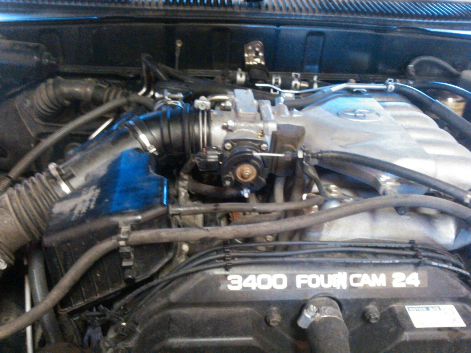

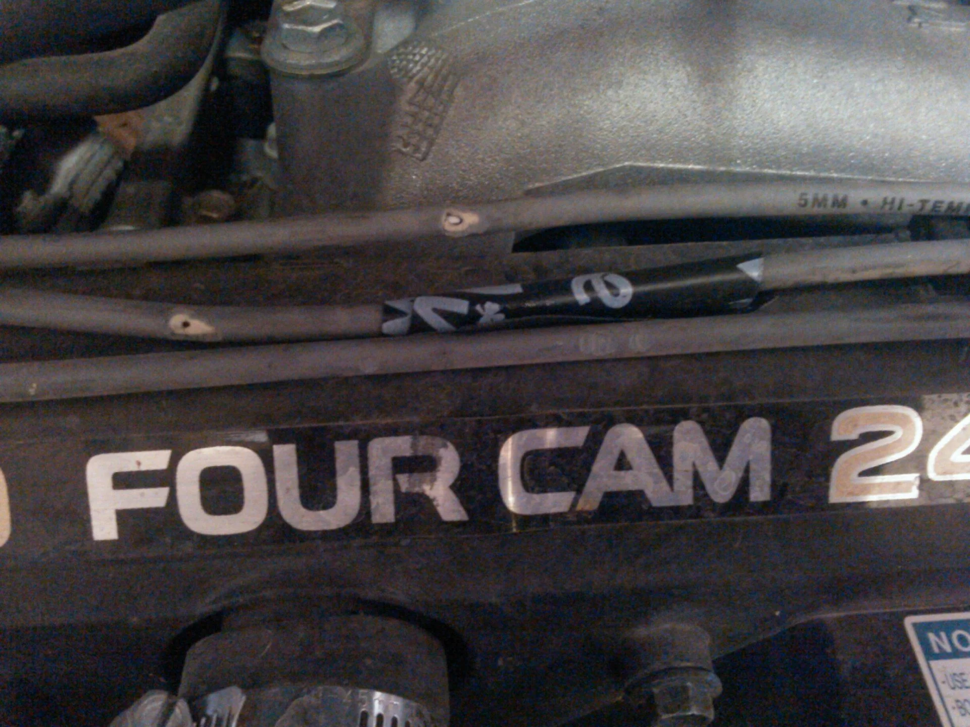

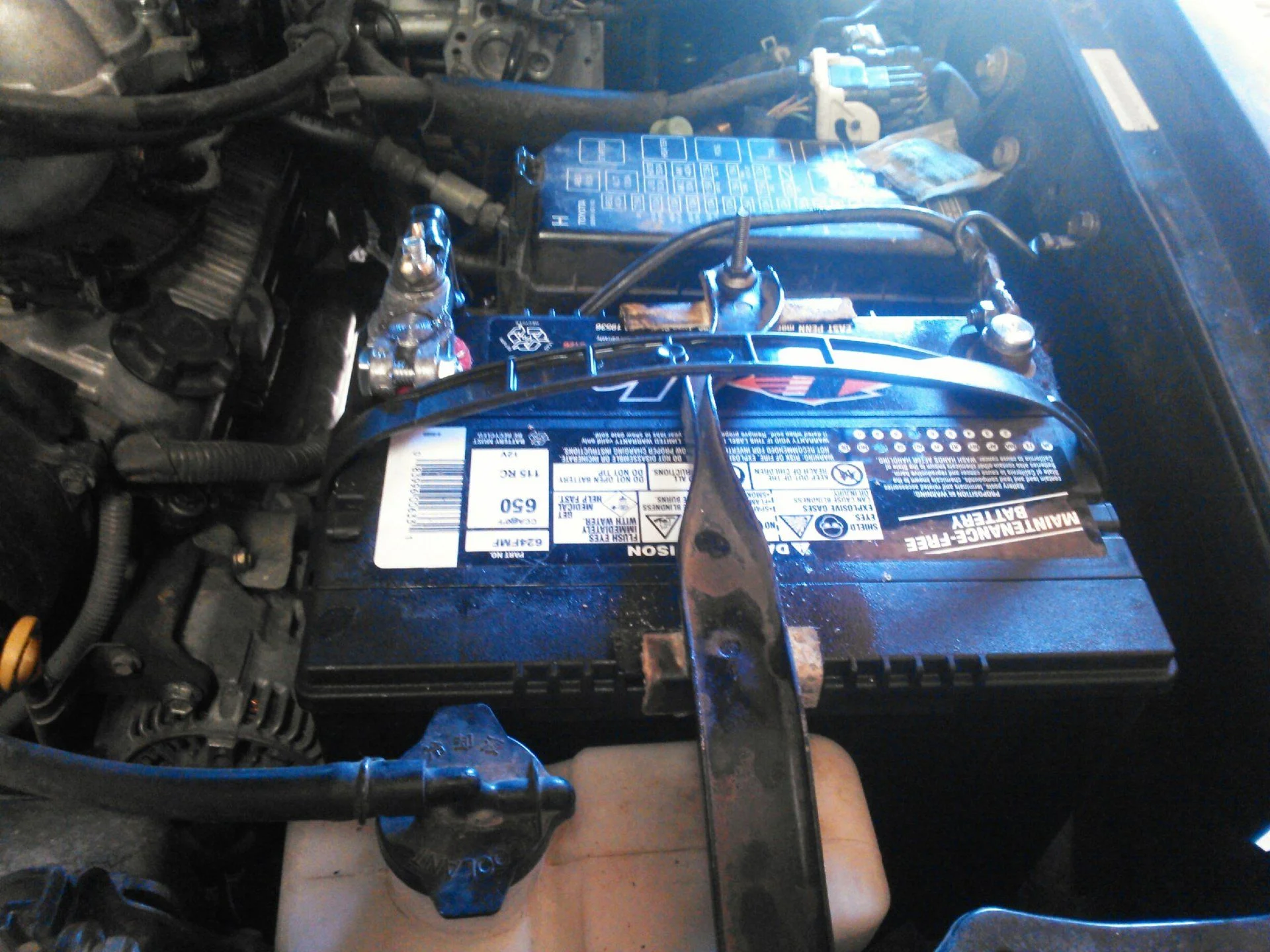

Finally replaced the rat eaten plug wires (needed the same OEM intake hose I just replaced on the Limited) and a new battery/post terminals.
For those of you who are still running conventional lead/acid batteries, I have found that this sprayed on works wonders to keep the corrosion off the posts and tie downs.

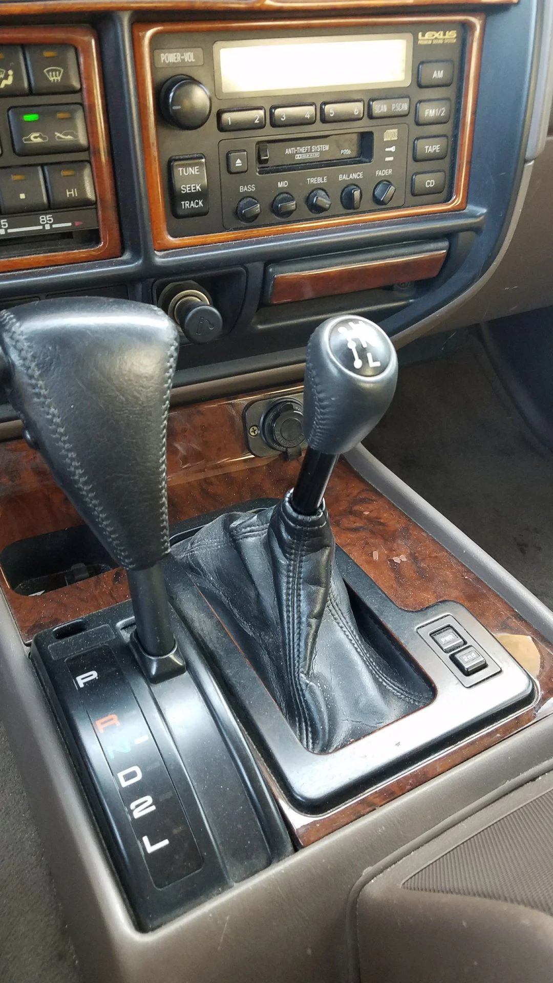

Felt the need to do something, added 3" extension. Looks cool IMO, cheap at $10, and actually does add ease to function. :meh:
