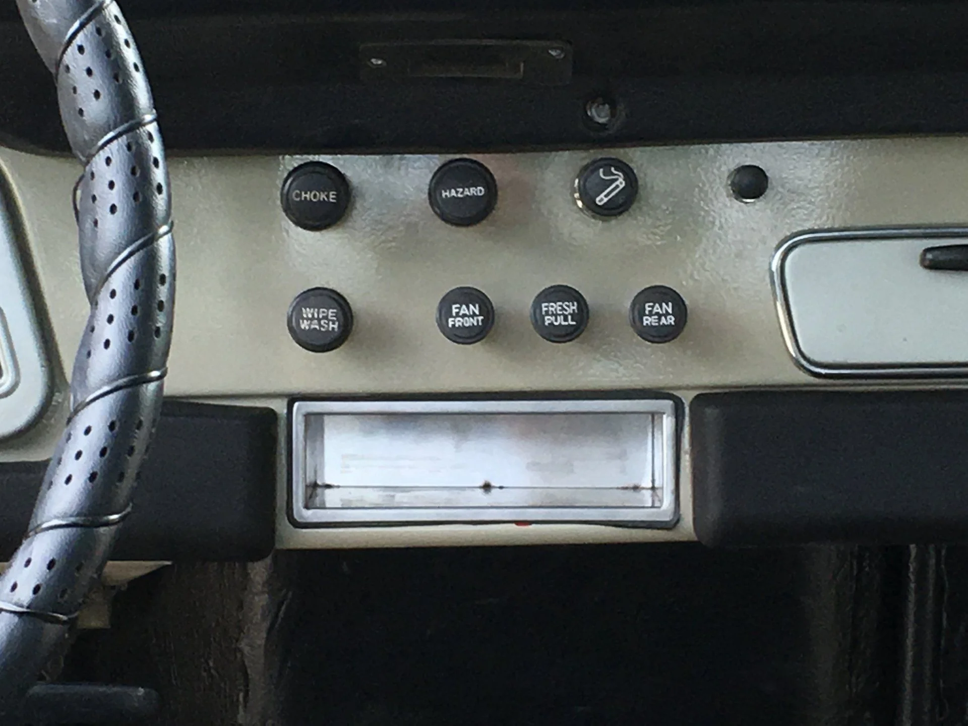

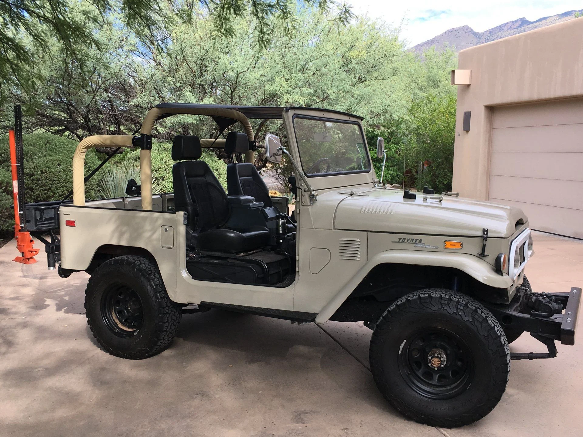

Installed roll bar, padding & cover as well as bikini top and custom box to fill in radio opening..fits my cell phone perfectly!

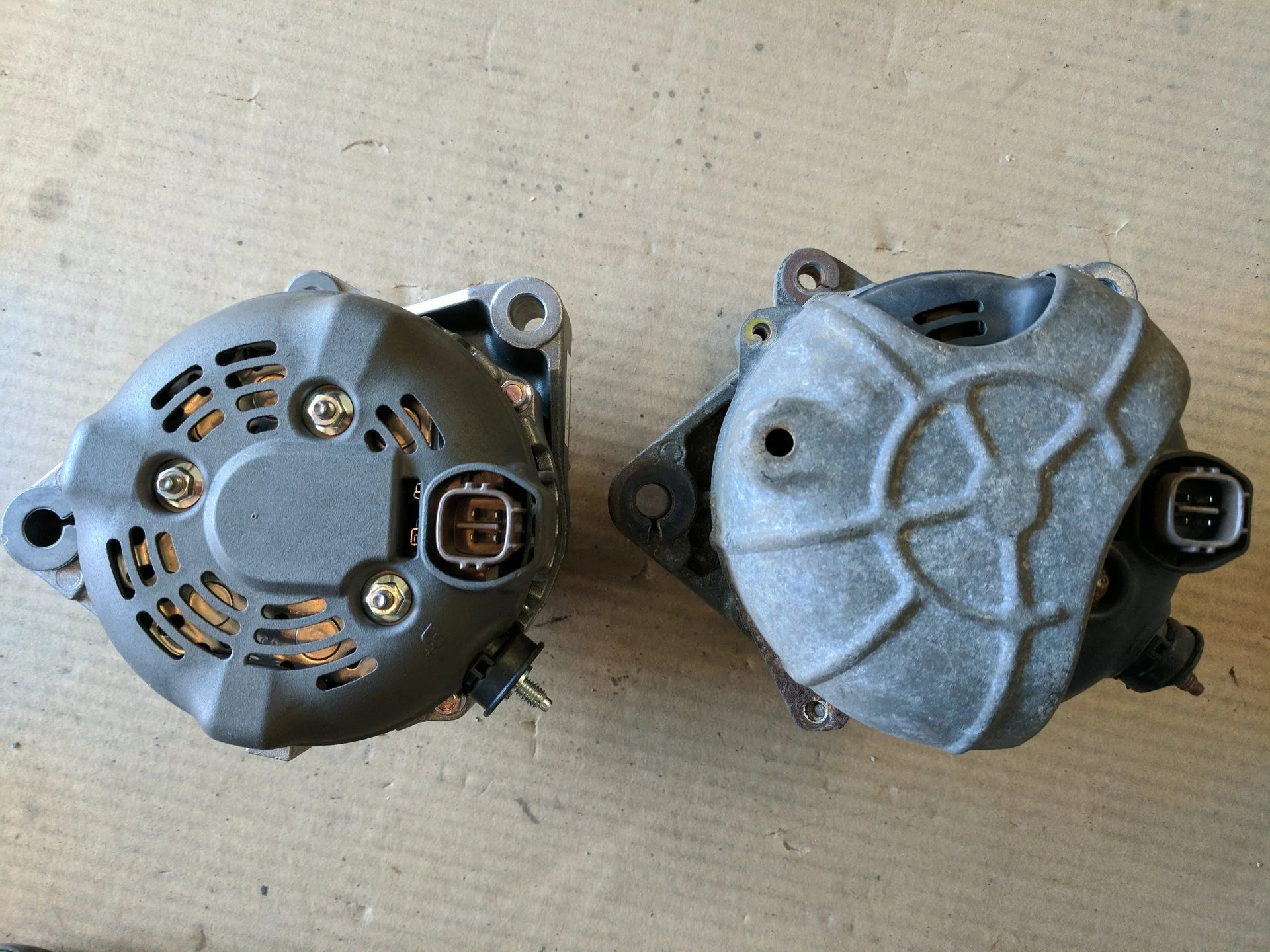

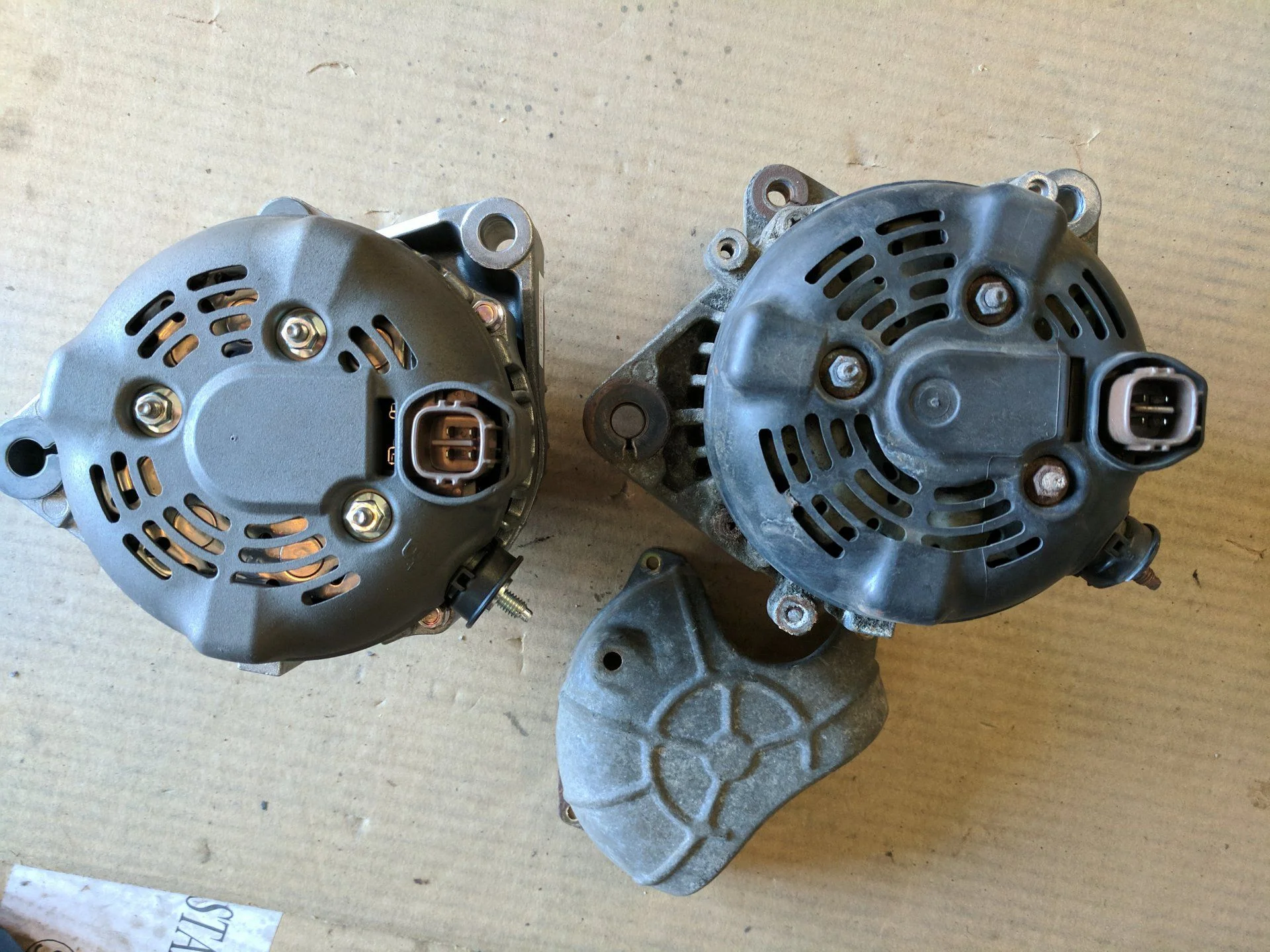

@medtro and @Saddletramp helped me with replacing the alternator. I was having a loud whining noise from the engine bay that I couldn't pin down. Checked the charging and was barely getting 12.5 volts.
There are two different model numbers for alternators in the 2004 model year, pre and post June. Mine was built in March. Part number I had was 27060-50330. No one had that one available on Friday. So we went with the later model, 27060-50360. The only difference is a shield on the back of the older model, which only seems designed to make it a complete pain to wiggle out from underneath the truck. New one went in super easy.
Thanks again to Jackson and Steve for the help.

View attachment 1534958 View attachment 1534959
Let us know if the sound comes back, the other bearings on the tensioner and idler may need to be replaced.

View attachment 1534646 View attachment 1534647 Installed roll bar, padding & cover as well as bikini top and custom box to fill in radio opening..fits my cell phone perfectly!
Looking good. Your seats really highlight how much lower the driver's seat is. Never driven a RHD version at all much least one from 73-78 era with buckets seats. Imagine pretty tight between the steering wheel and seat.

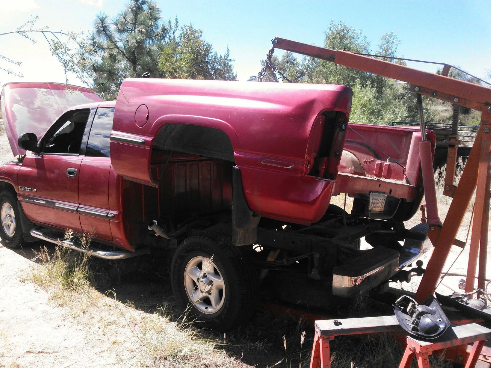

Toyotas are fine, but we still own a Dodge. At least it creates it's own shade.
View attachment 1538310 View attachment 1538311

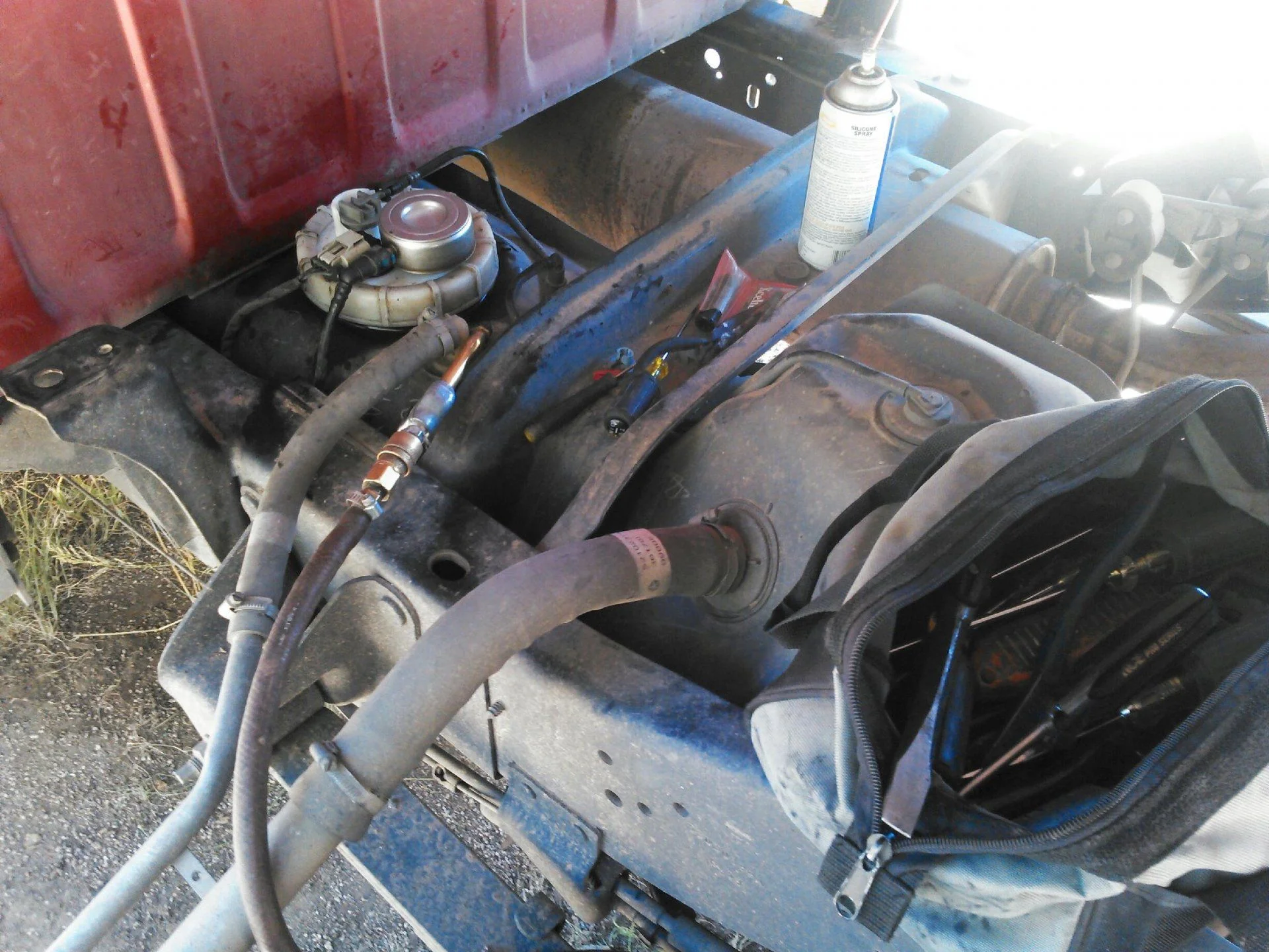

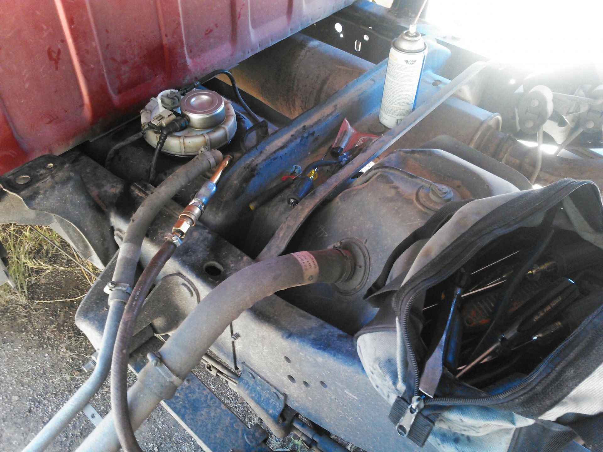

Toyota wasn't thinking when they started using fuel injection on the Land Cruiser. FJ60 has a inspection cover for the fuel tank sending unit. But when they moved the fuel to the tank they didn't add a inspection cover for that. Can drive you Cruiser with a broken sending unit but not with a bad fuel pump. Changed it twice. Once before joining Mud and second shortly after. That because of Mud knew a pressure regulator on the engine should be replaced at the same time. Lucky for me both times died at home.

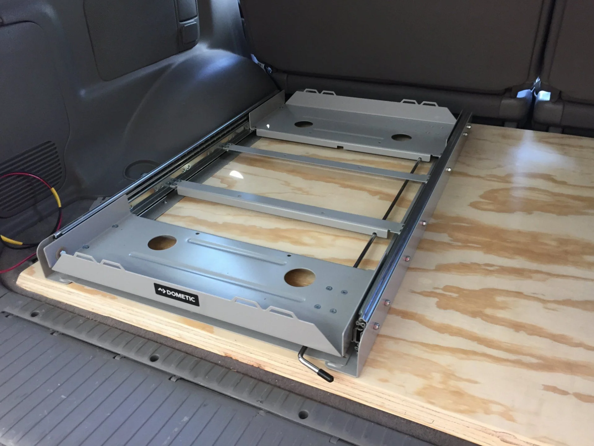

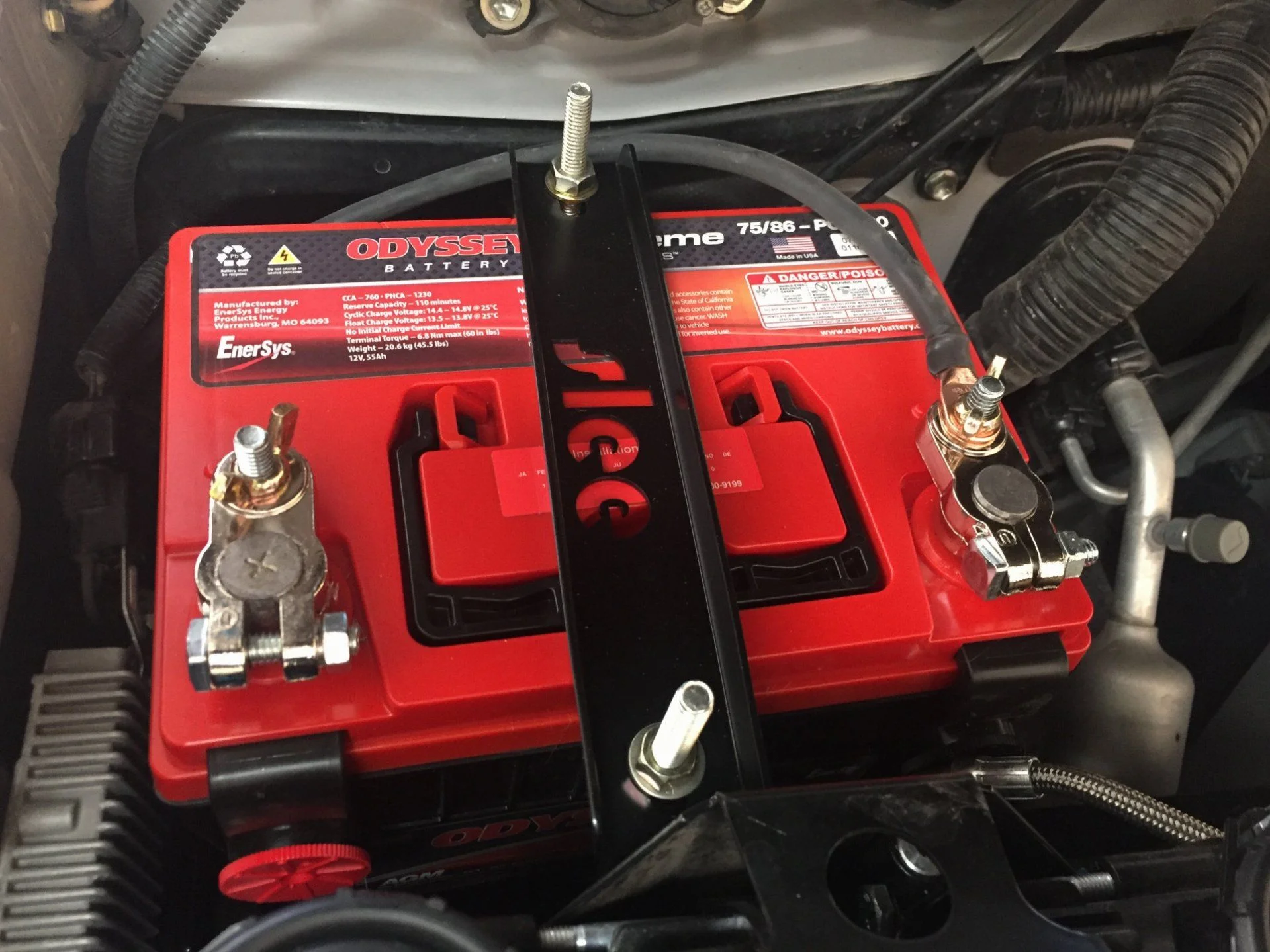

Installed dual Odyssey batteries, hooked up the ARB twin compressor and installed a fridge slide. I was busy this weekend.

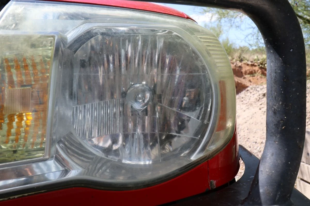

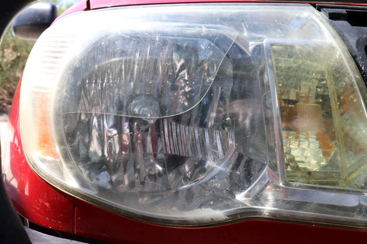

Replaced headlight bulbs

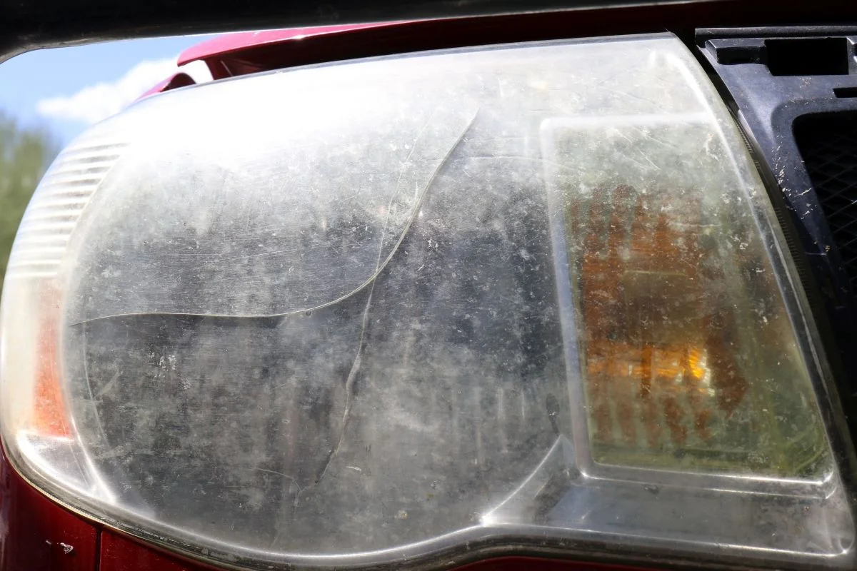

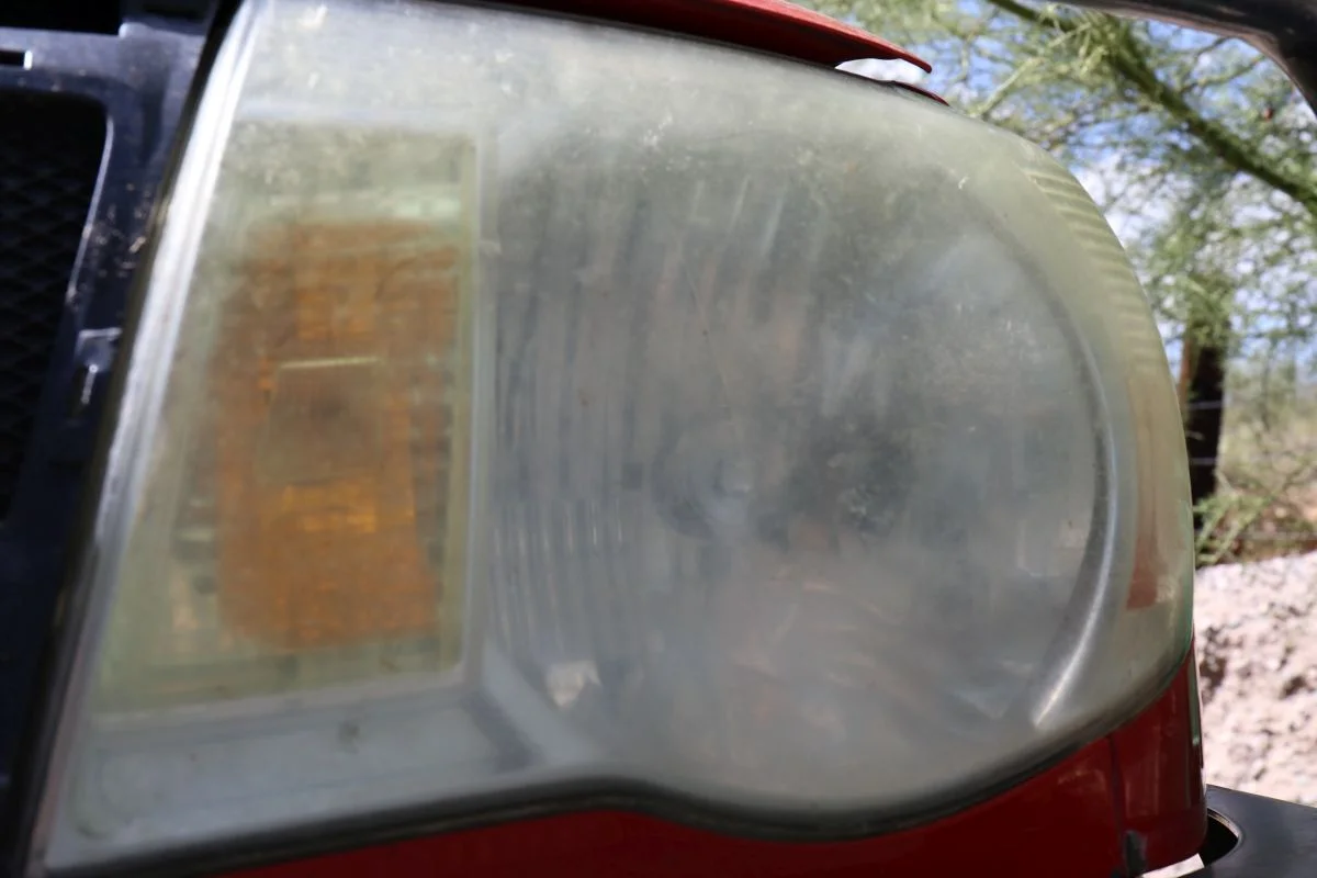

Buffed out headlight lenses - I still need new ones because the deer I hit cracked the passenger lense, and the driver's already had a crack
Before:
After:
