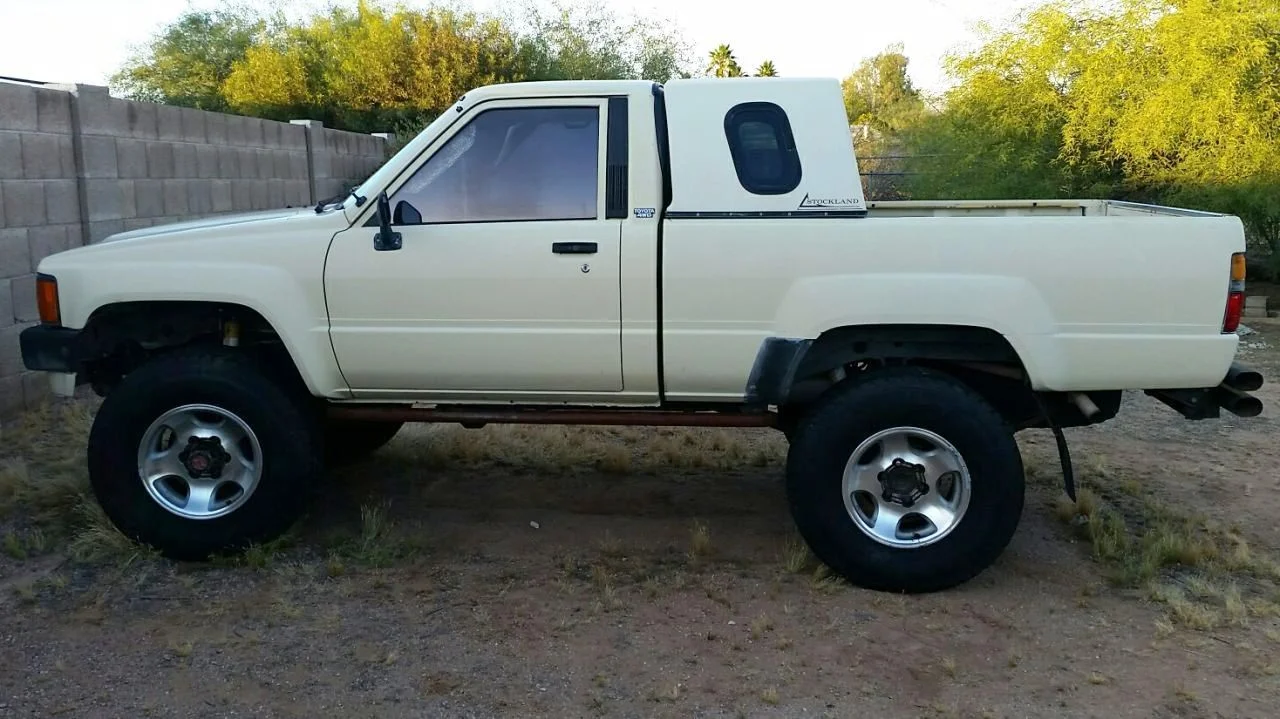

My 4Runner no longer has the stock "why use 5 parts for steering when 37 will do" steering setup. HySteer is WAY better and easily turns the 315s. So @GeoRoss you're halfway there as HySteer uses an IFS box.
My Next Big Upgrade will be giving the engine some love. Either rebuild/add some oomph to the 22RE or those 3RZ swaps sure look nice.:hmm:

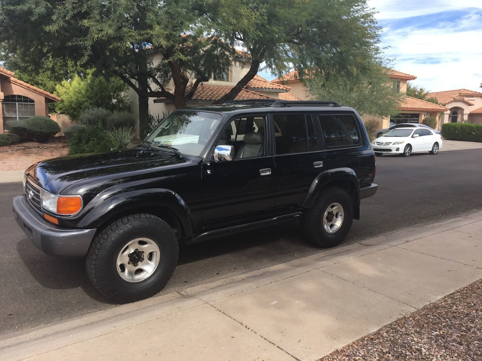

had front wheel bearings repacked, reman OEM calipers, new OEM rotors, OEM 100 series pads, new OEM front brake lines installed, parking brake adjusted, drive shafts lubed, disti o-ring replaced, timing done, new heater control valve from Rock Auto, and OEM tow hooks bolted on to the rear.
And new shoes ! 315/75/16 Terra Grapplers. My truck rides so smooth its like butter !

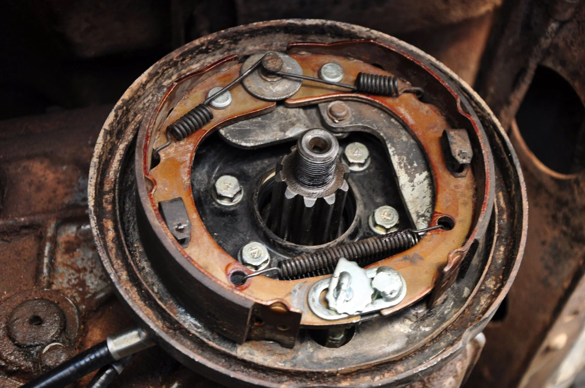

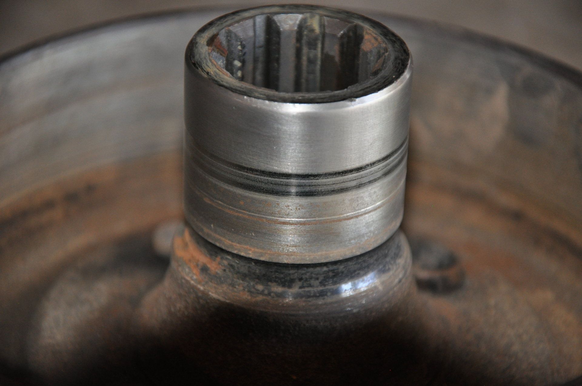

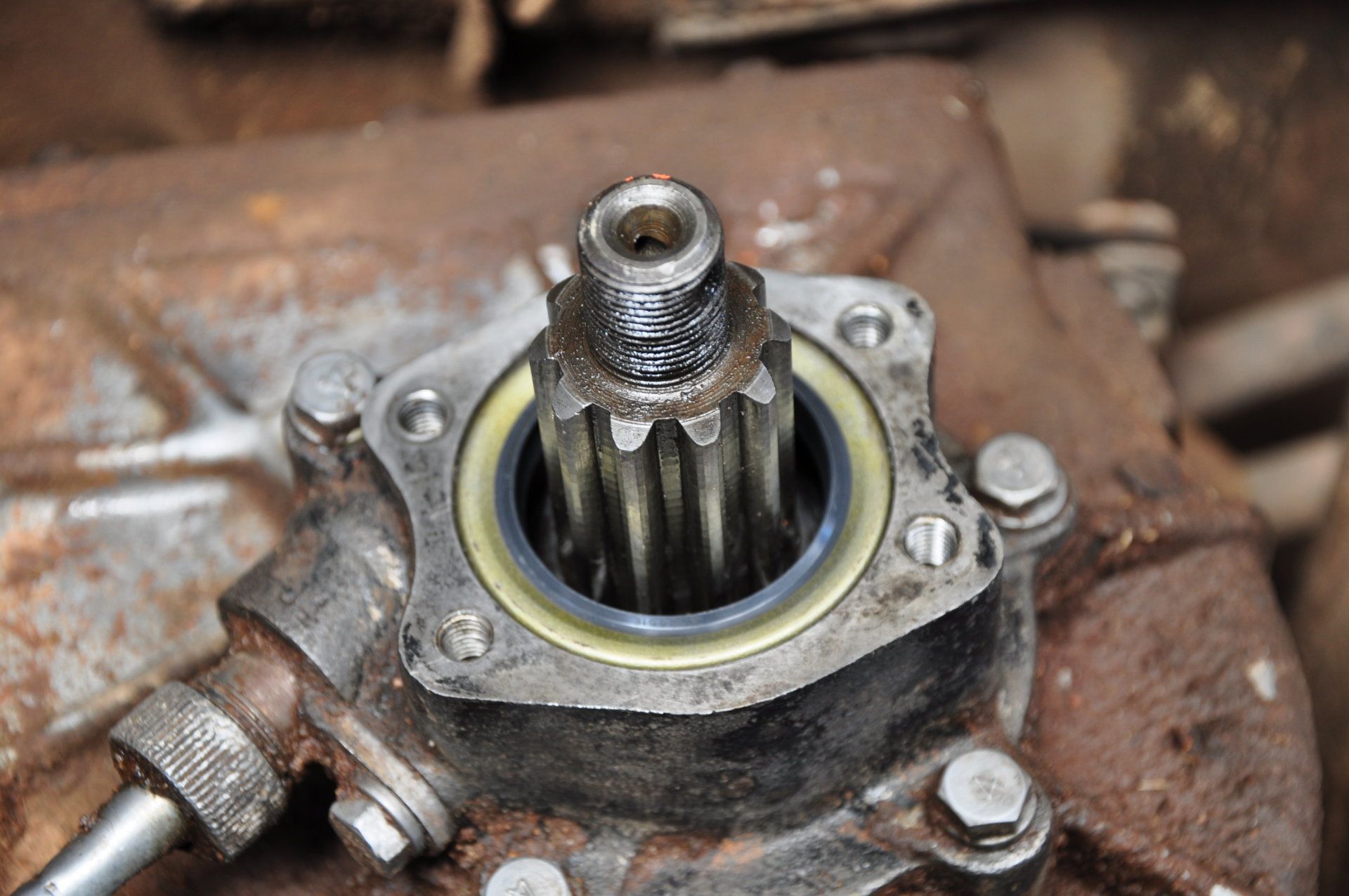

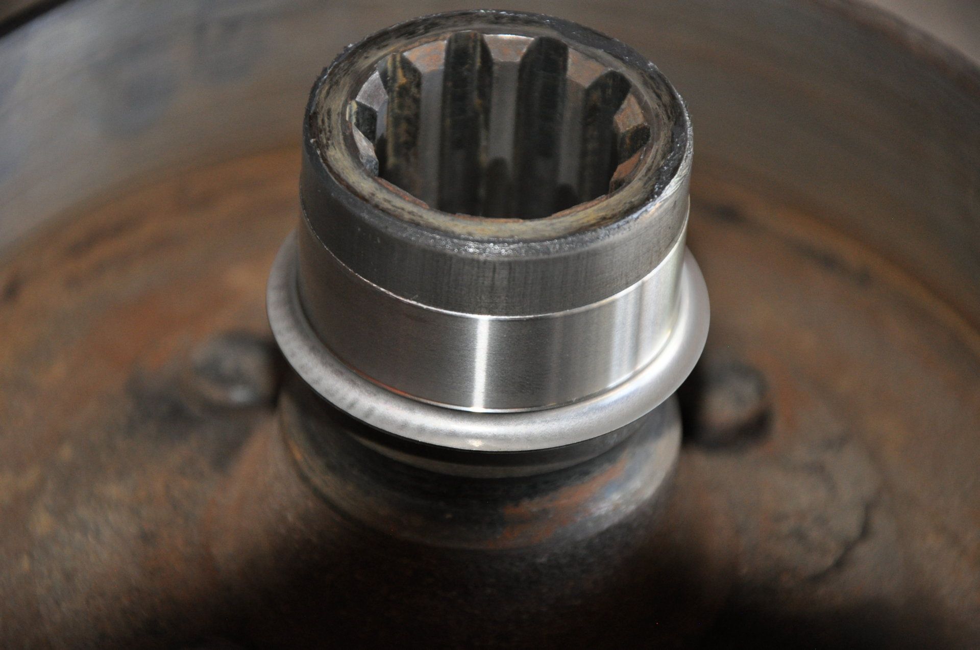

I have owned this so long that I am replacing seals I have already replaced before. E-brake drum seal;
The surface on the drum shaft was borderline so on went a speedy sleeve.
Also just in case I had excess play in the output shaft I bought a shim kit and gasket. Not needed. If anyone can use I have these on hand.

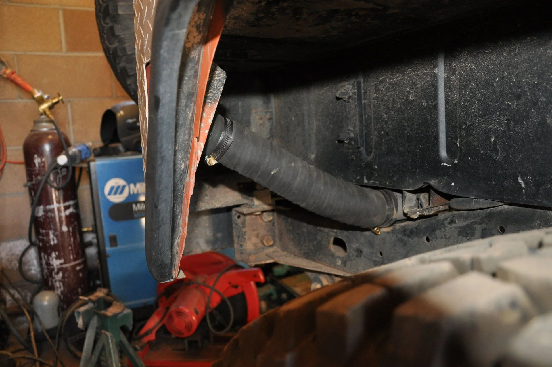

Fixed the gas tank leak. for my elk hunt next month.
I finally got around to doing that as well. Replaced the filler neck hose on the 18 gal aux.
Should be good to go for our end of month whitetail hunt.

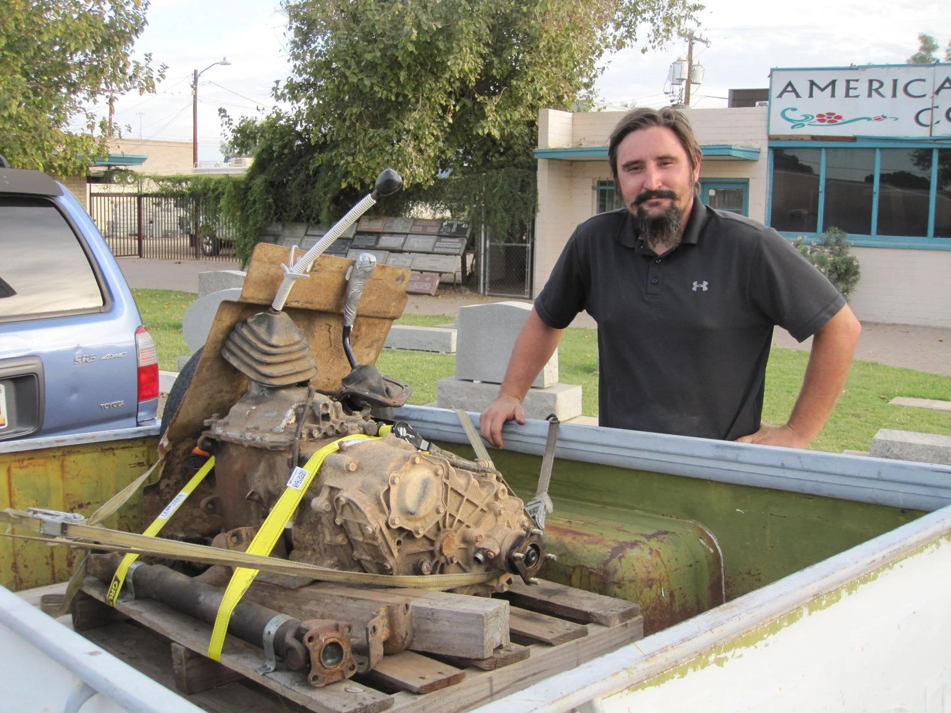

My ordeal that started in May is finally over, my five speed arrived today. A big thank you to Alvis @Cruddz for excepting the shipment and having a forklift to unload and load it into my trailer. A another big thanks for talking cruisers for a few hours. Haven't had a chance to get out month the last couple of months and great to get to talk to another cruiserhead for a while. Now that I know the setup don't be surprise of I pop in for a visit something.

Fixed the gas tank leak. Took the 40 up to Picacho Peak and back at highway speeds (65 or so), 60 miles, as a shakedown for my elk hunt next month.
