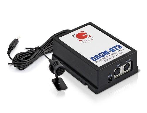

I added a GROM audio BT3 system to the GX on Saturday and tested it on a trip to San Diego this week. Works great and the hands free phone microphone sounded clear. Keeps everything looking clean and stock while adding BlueTooth streaming audio and hands free phone use. The handoff works well too when receiving a call, alert or txt.

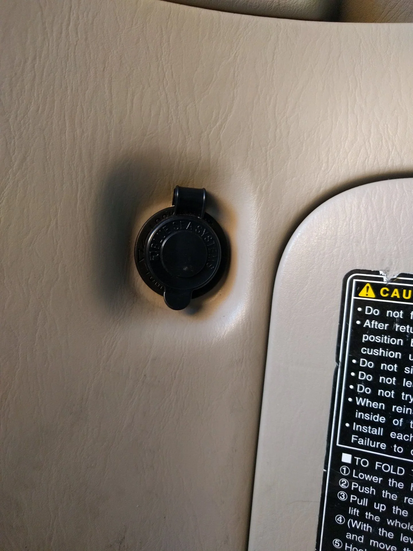

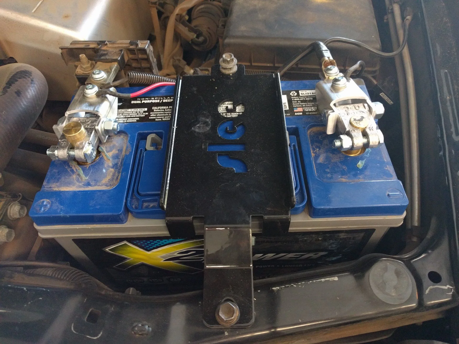

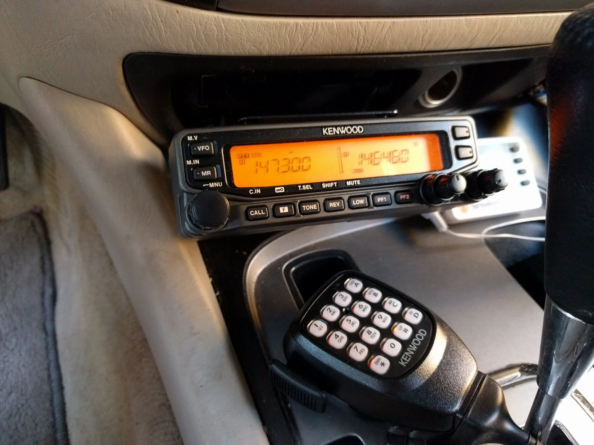

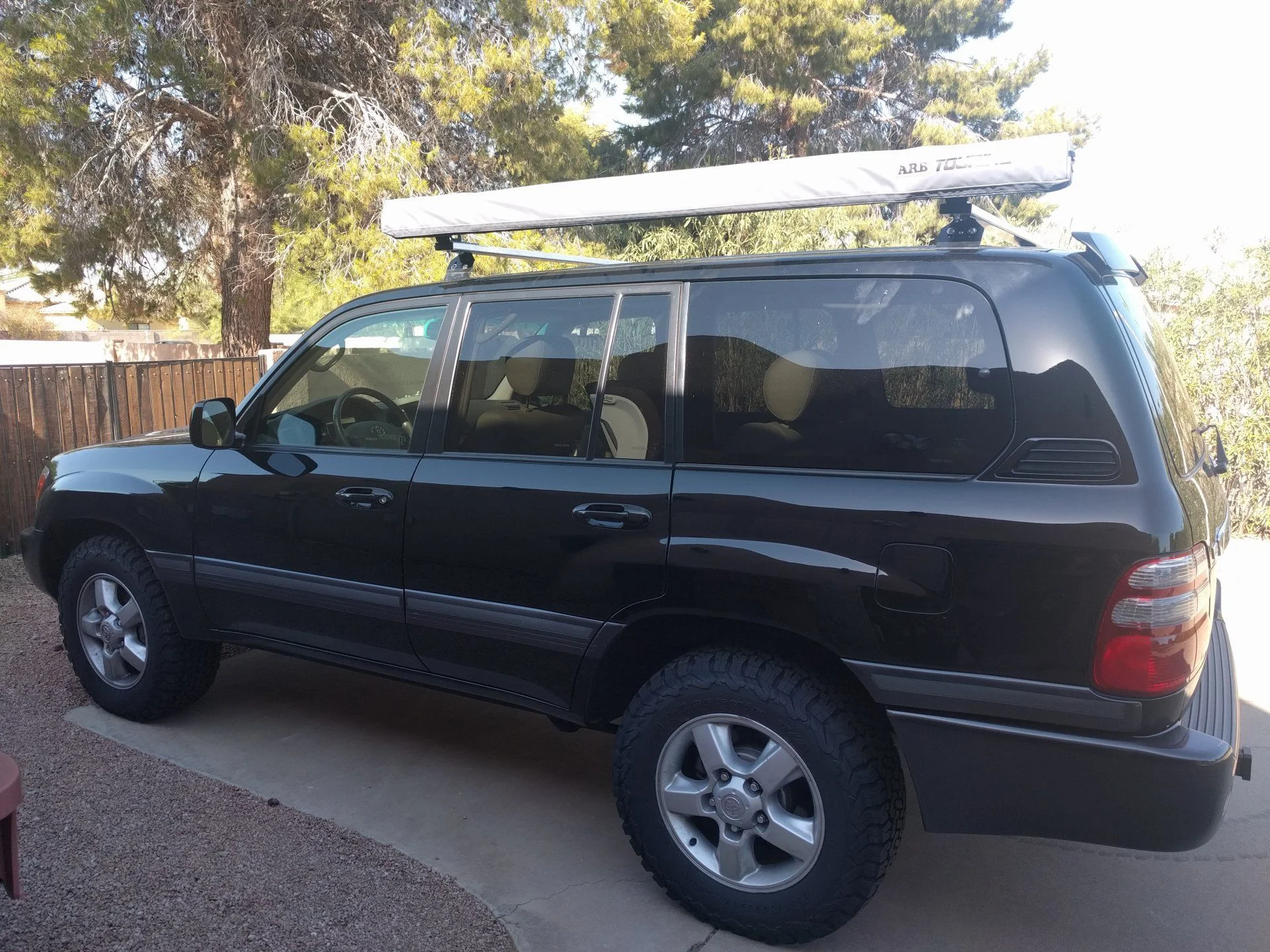

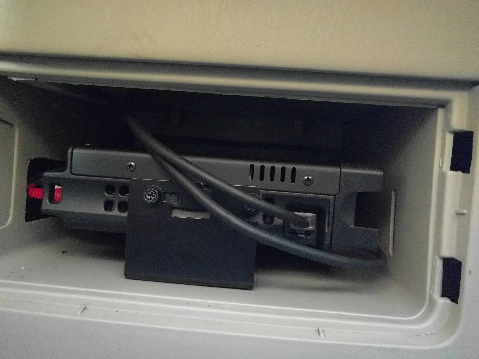

Awning installed, new Kenwood ham radio installed, 10ga wire ran to new Blue Sea 12v outlet in the rear for the fridge, and Slee battery tray installed for my 31m battery.

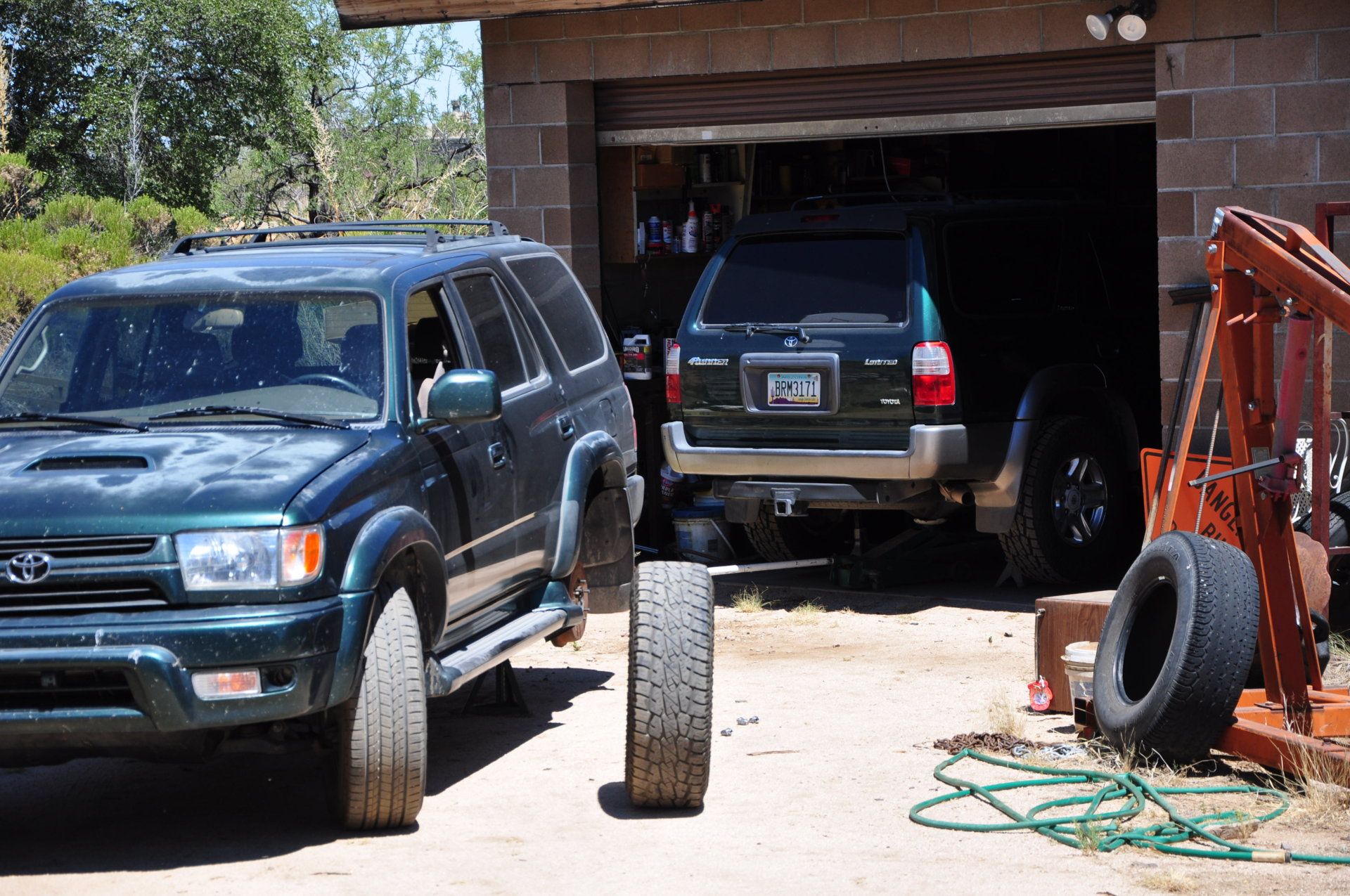

So did you get a few days off from work? Switching wheels and tires between the two 4Runners? I like the five spoke wheels. Switched to them on my poor 99 that now just sits in a garage for months at a time.
Two days in a row off!:bounce: Also landed the copper gig and a new truck that they let me take home from time to time. I am now going back and forth from Asarco Sahuarita to Asarco Hayden with loads. $200/day and pretty much a stress free 10 hour shift.
Yes, now the tire situation makes more sense, the '99 Limited (2wd) has practically new Yokohama street treads, and the '01 SR5 (4wd) is sitting on the Pro Comps and the 5 spoke Limited wheels. I have to say, I haven't noticed any change in ride quality or road noise. These AT/Sports are quiet and I like the look of the wheels as well.
