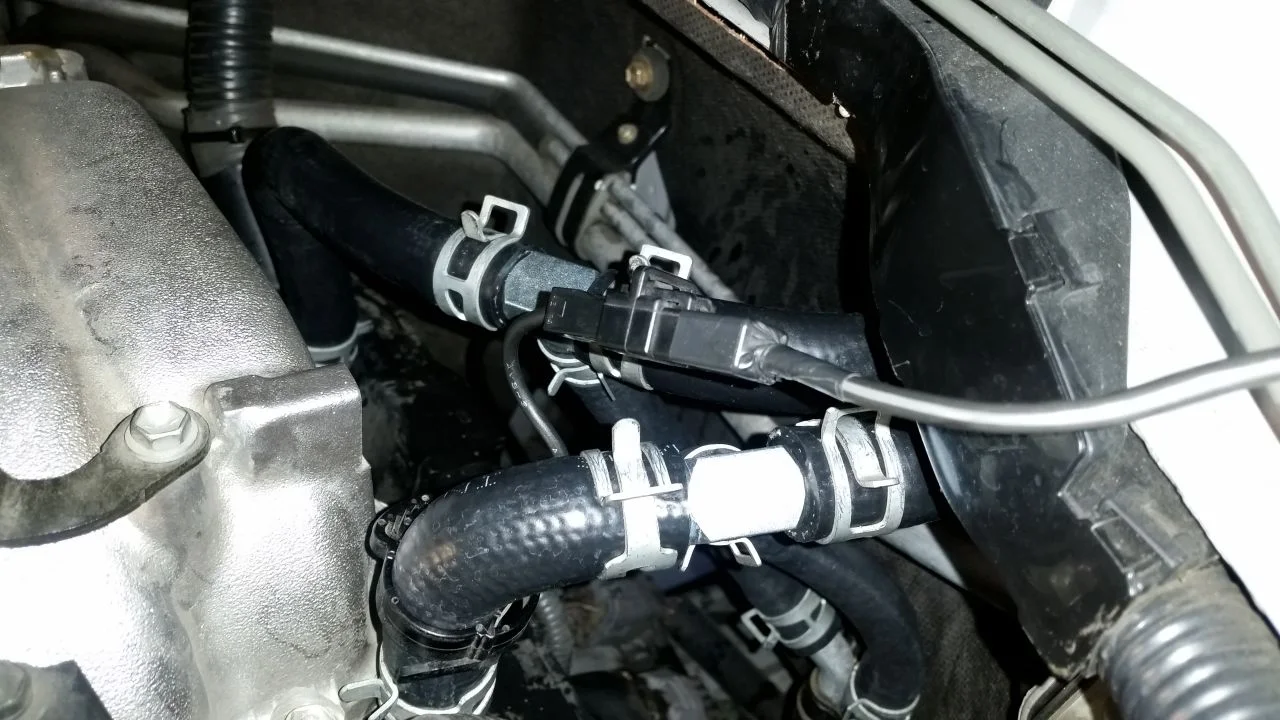

Also developed, and hopefully cured a random coolant leak in the "3rd radiator hose" on the 3FE. Such a stupid location; located behind the AC compressor pulley.

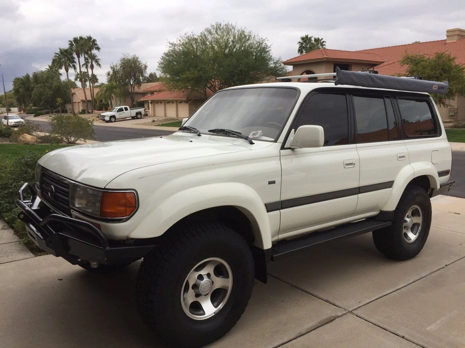

On Kaibab the 97;
The rear stock springs and 30mm spacers were removed, and OME mediums swapped in. Now the stance is propper, with mediums F/R.
E-brake adjustment completed, and the LSPV maxed out= happy brakes!

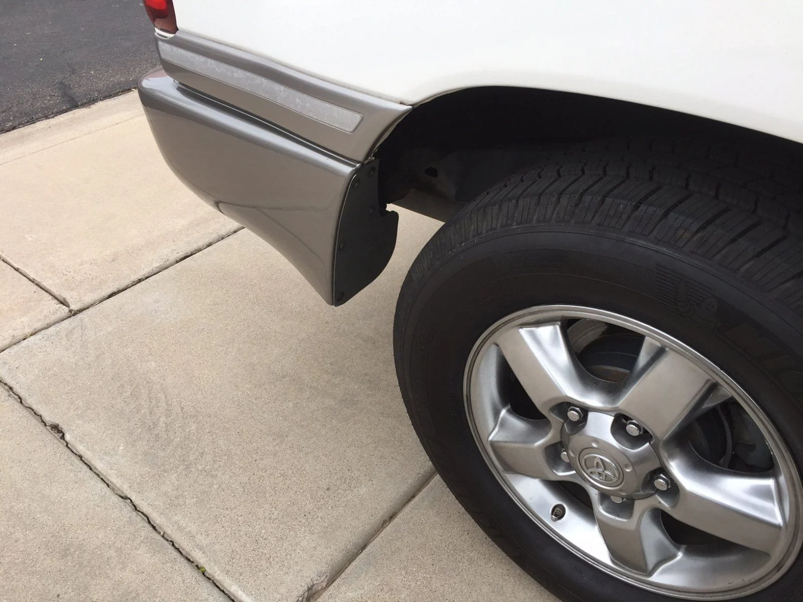

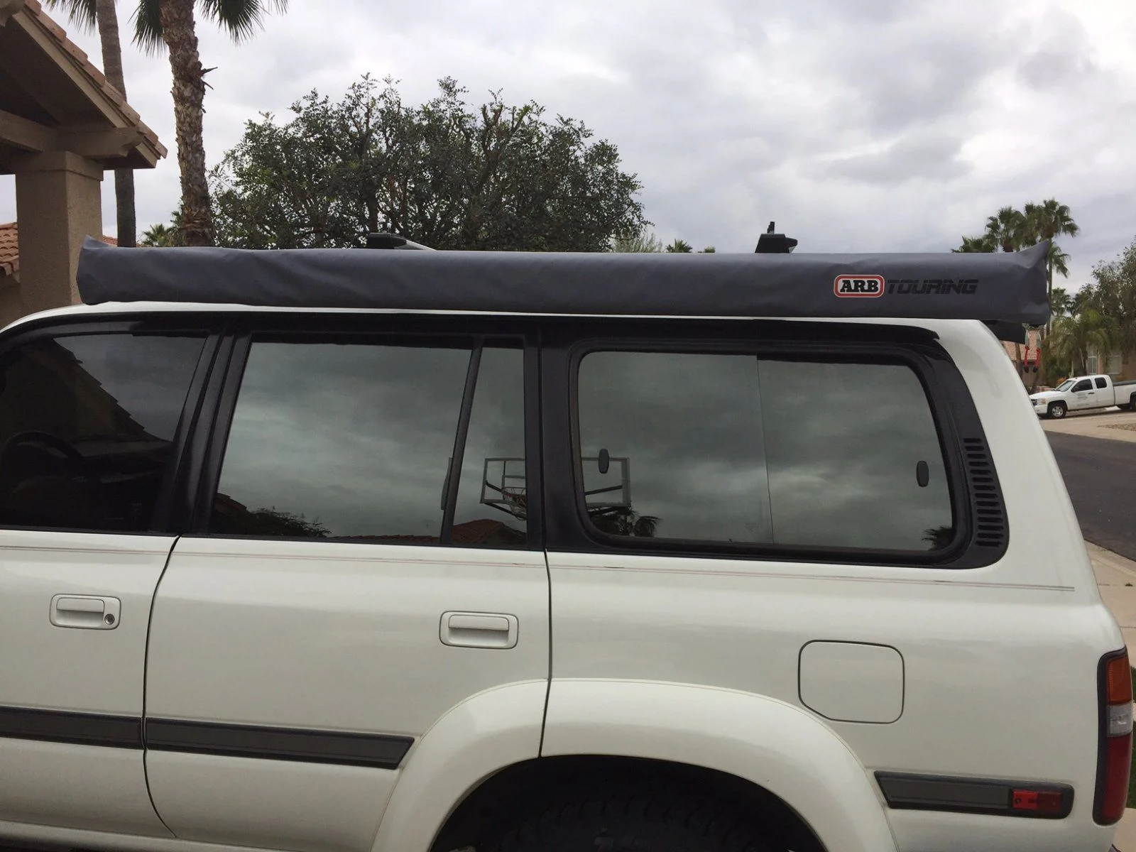

Added my awning for the upcoming ROTM and added the LandCruiserPhil 100 series mud flap replacement. Great product maybe a 1/4 :banana: job

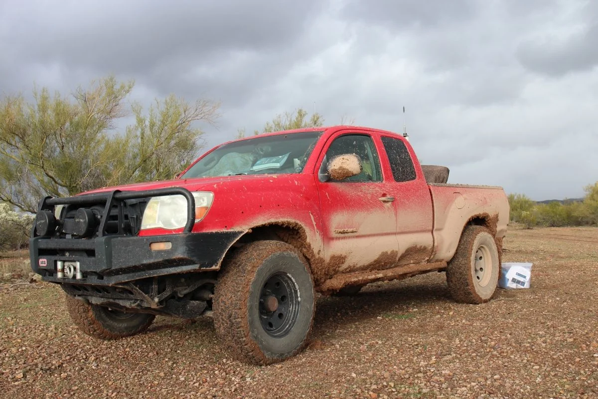

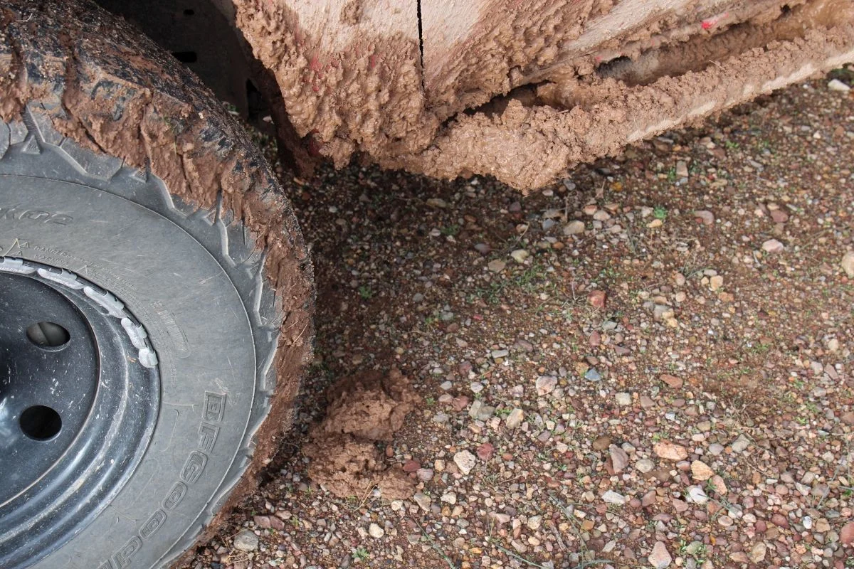

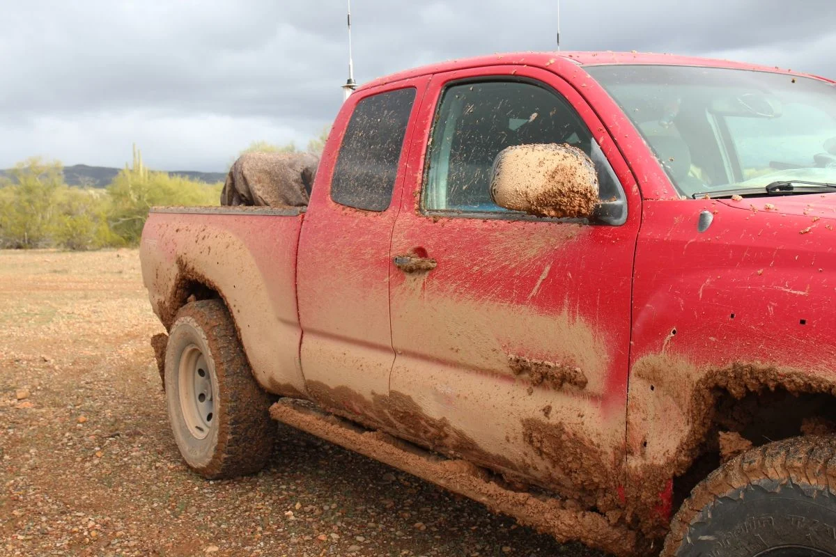

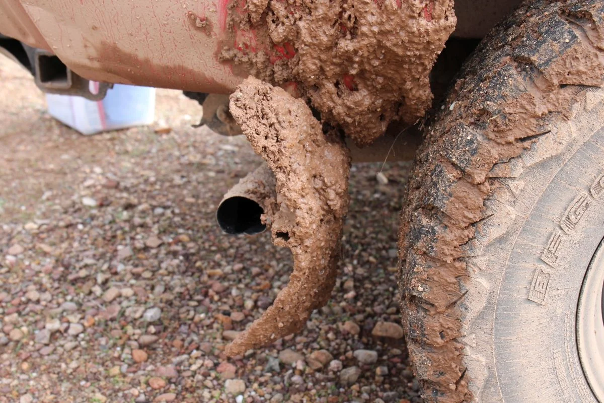

I hate mud! Getting the visable mud is easy it's the hours I've spent laying on my back cleaning it out of all the nooks and crannies in the frame and body on my FJ40 I hate. Now it's the salt they use on any highway that gets snow. At least Costco's carwash does a good under side wash. Unlike salt most carwashes frown on running a vehicle thru that's caked with mud.

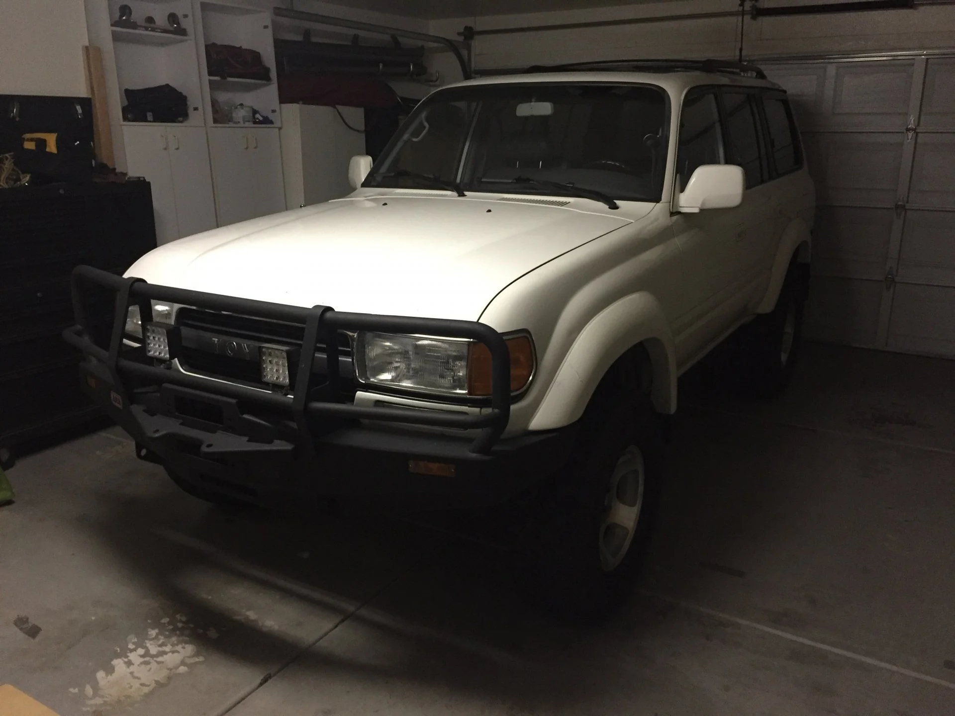

What do you do when you get a "new to you" 80 series with higher miles that develops the white smoke puffs? You take it to Eric at CBT and have Tom do the head gasket! Very thorough, top notch as always. Thanks Eric and Tom!!!
BTW, special thanks to @mrhustle23 for a great, well pedigreed rig that gets to stay in the club/valley.

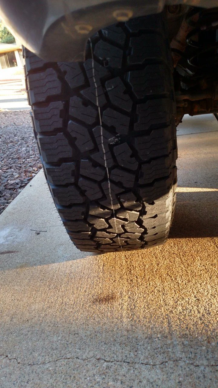

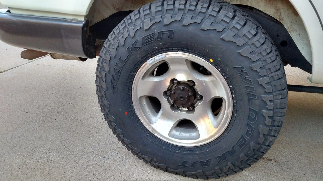

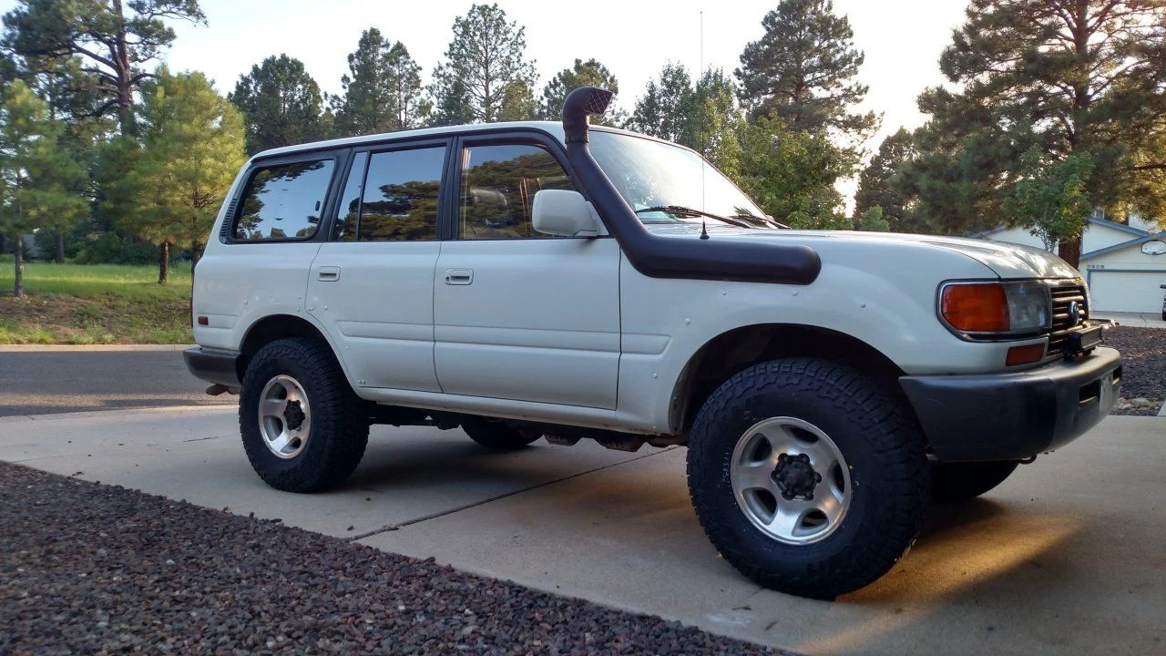

My 97 is going through rehab currently. Kind of a 12 step program back to respectable-Cruiserhood. Several orders through CBT have been placed. Today's chapter, new tires. These are the new Falken Wildpeak AT3W, in the 285/75/16 flavor. They are quite heavy and burly. Probably heavier than a 35" BFG AT KO1. Definitely slower than the 245/75/16 Big O AT's they replaced. But, these will look and perform oh so much better. Quiet on pavement so far. Discount Tire hooks it up again!

Did you have any chance to wheel those Falken AT3W tires? Any issue with dry traction on trail like Broken Arrow?

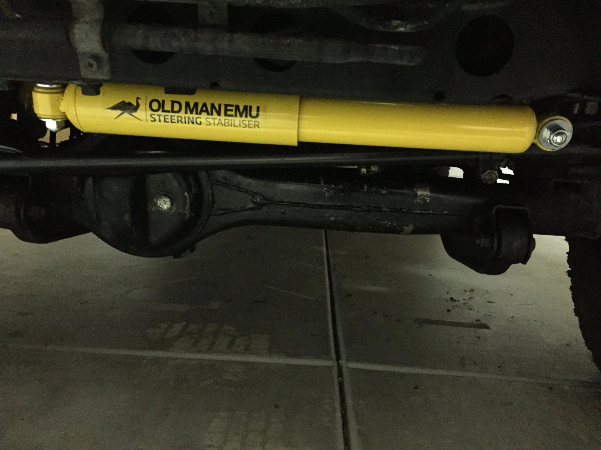

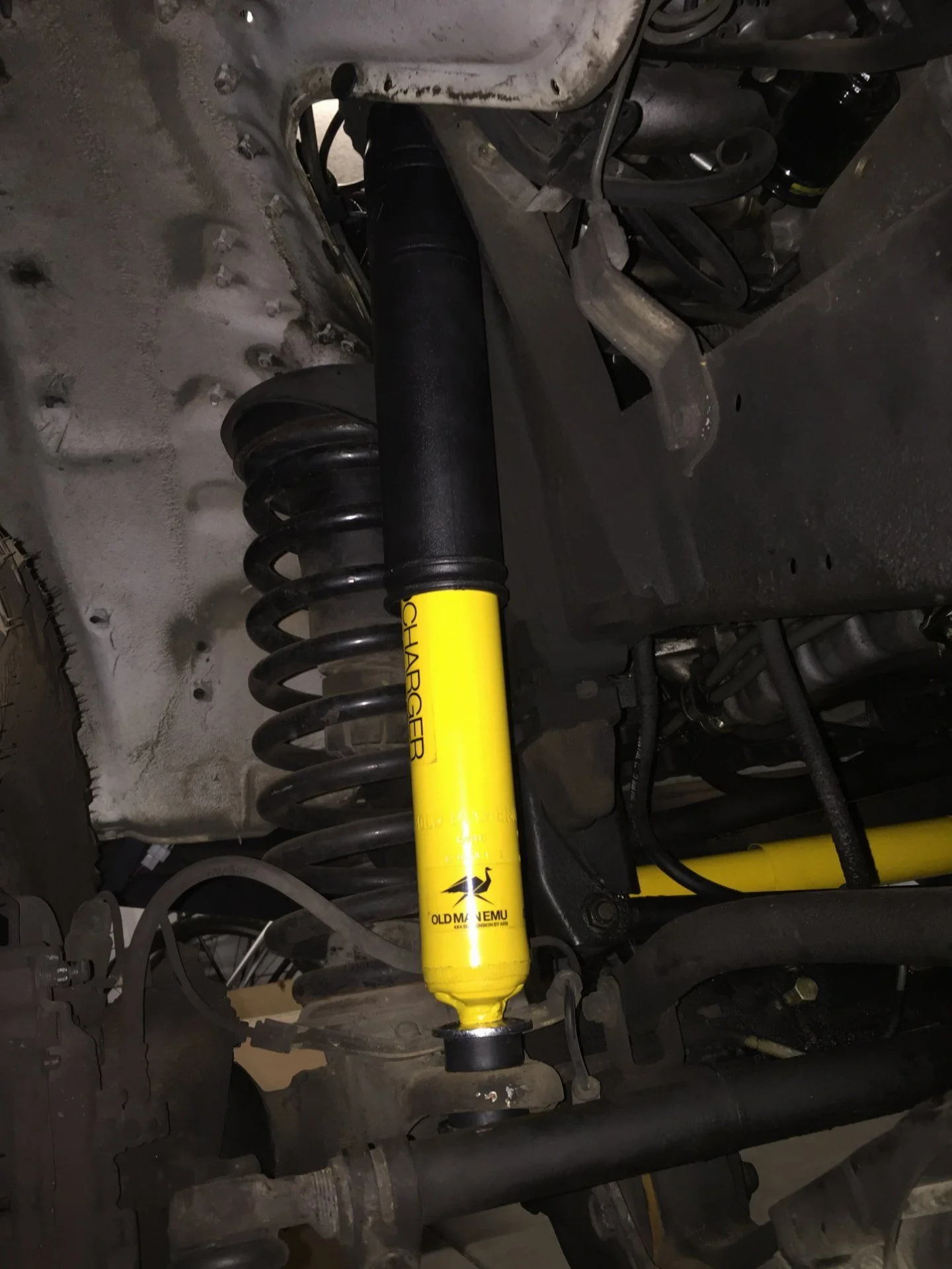

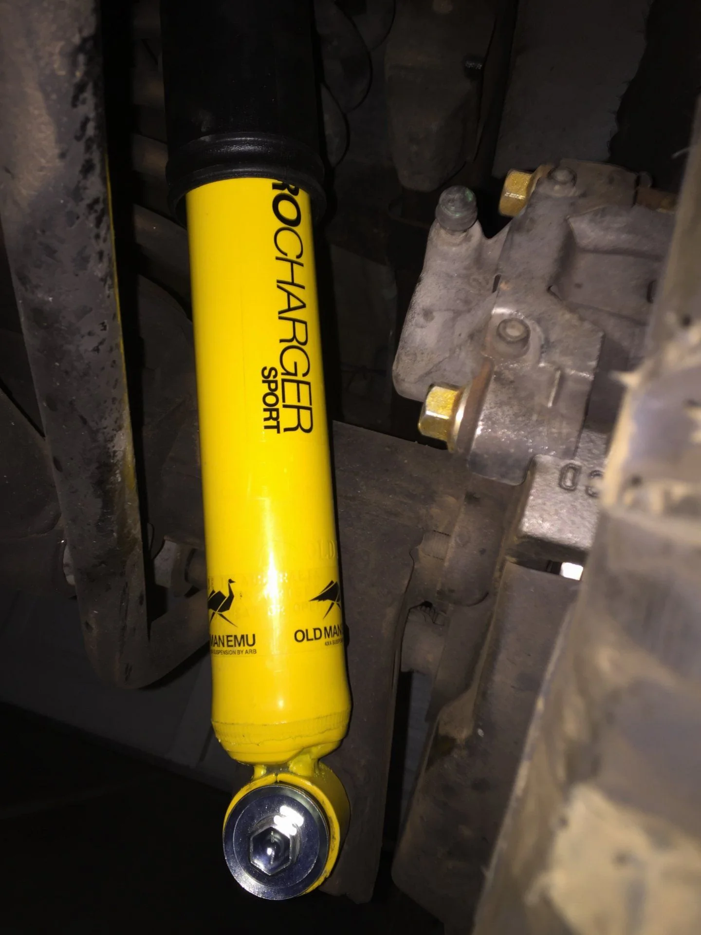

Gave the 80 some much needed care tonight.
Replaced some very (old) old man emu shocks with the newer sport style. Also installed a new steering stabilizer.
The 80 should handle so much better now. Lol
On pavement, snow, ice, and dirt roads they have been great, but no real time in the rocks or real "wheeling" yet.
