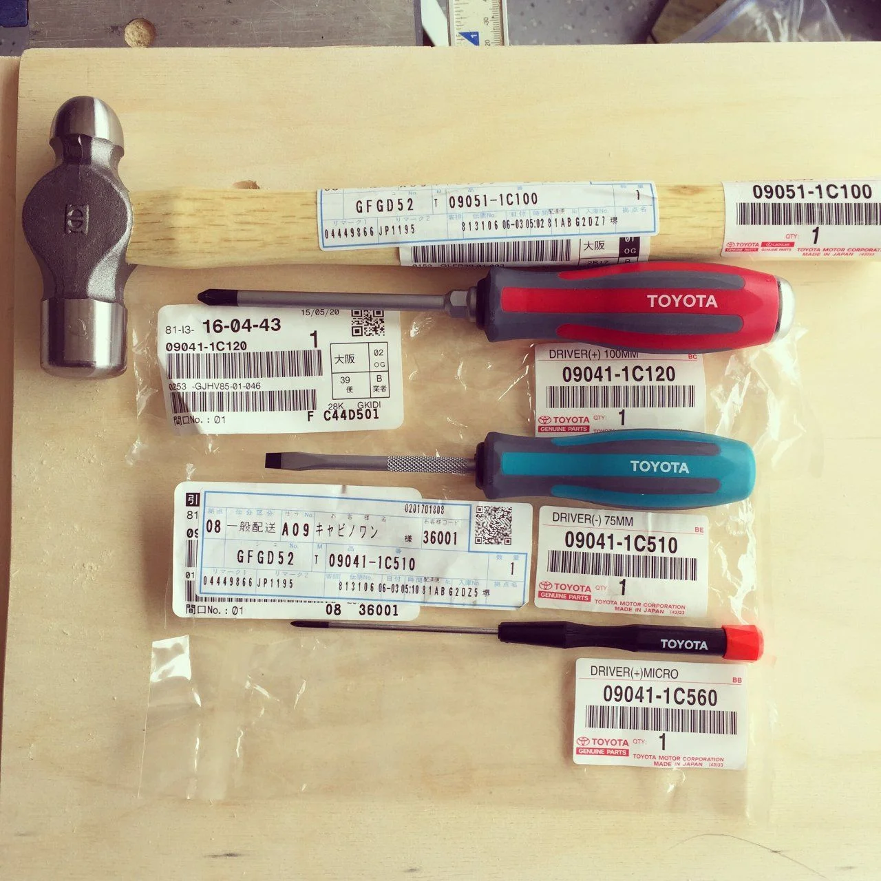

Just came in the mail today

Can't afford Snap-on; and besides, if I came home with a snap-on hammer I'd never use it. You are not a real TEQ head if you allow Phillips screwdrivers to touch your JIS heads.

The JIS Phillips is excellent on Japan screws but suck on US Philip Screws.
I look forward to your report on the difference in the the TEQ and US hammer
