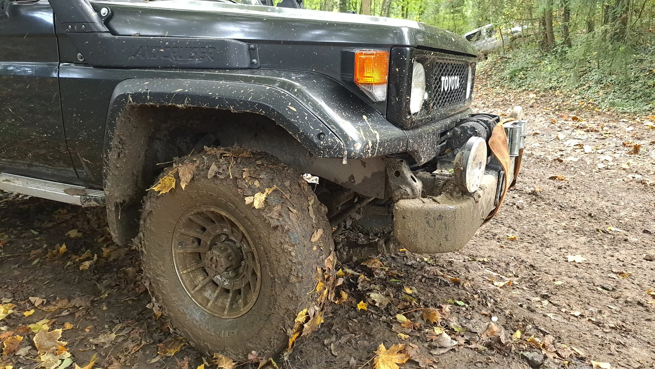

OMG I have destroyed several LC's at Cherimont in the 90's . Once it starts raining it gets so slippery there . Good to see that it is still open to Offroad events
Open again. I heard it was closed for some time. Yes, it is a wild terrain. Actually not suitable for almost stock vehicles like mine.
The others have rear lockers, mine hasn't. Also my wheels are too small for the deep ruts. It took 5min for me to get high centered on the diffs.
Most tracks are like hollow ways, so there is no option to pick a line (which I actually consider the fun in offroading), but high risk to lean to the walls and suffer body damage. Luckily it hadn't rained too much, so the puddles were mostly no problem. But when it rains, those revines apparently quickly turn into swimmingpools. It was fun, but probably a one time event. (Btw: access fee is 65€).

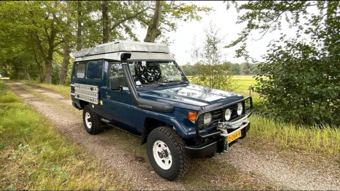

I actually did the worst thing ever to my 70 series troopy camper, I listed it for sale 😢
For Sale - Netherlands: 1996 / Toyota Land Cruiser / HZJ75 Troopy / 187,000 miles / LHD / roof top conversion - https://forum.ih8mud.com/threads/netherlands-1996-toyota-land-cruiser-hzj75-troopy-187-000-miles-lhd-roof-top-conversion.1348158/

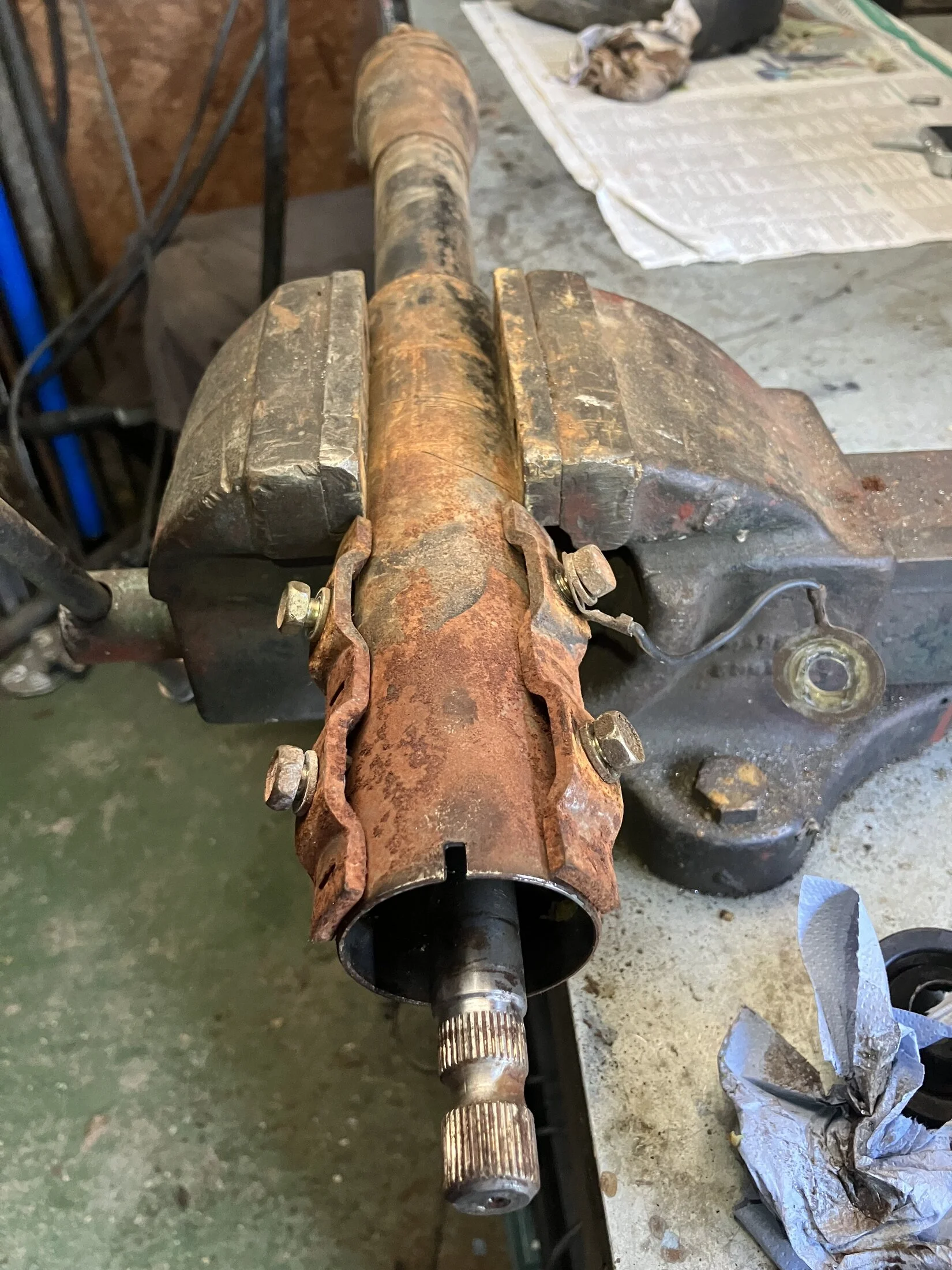

Steering wheel remove….so the spider joint is worn, so a 16x 40 new joint seems to be the direct replacement.
Anyone driven out the shaft on these from the tube housing? I don’t want to welt it too hard, but maybe that’s what is required .
^ Interested in the answer as well. On a quest to eliminate steering play/dead space after an upcoming suspension and axle overhaul.

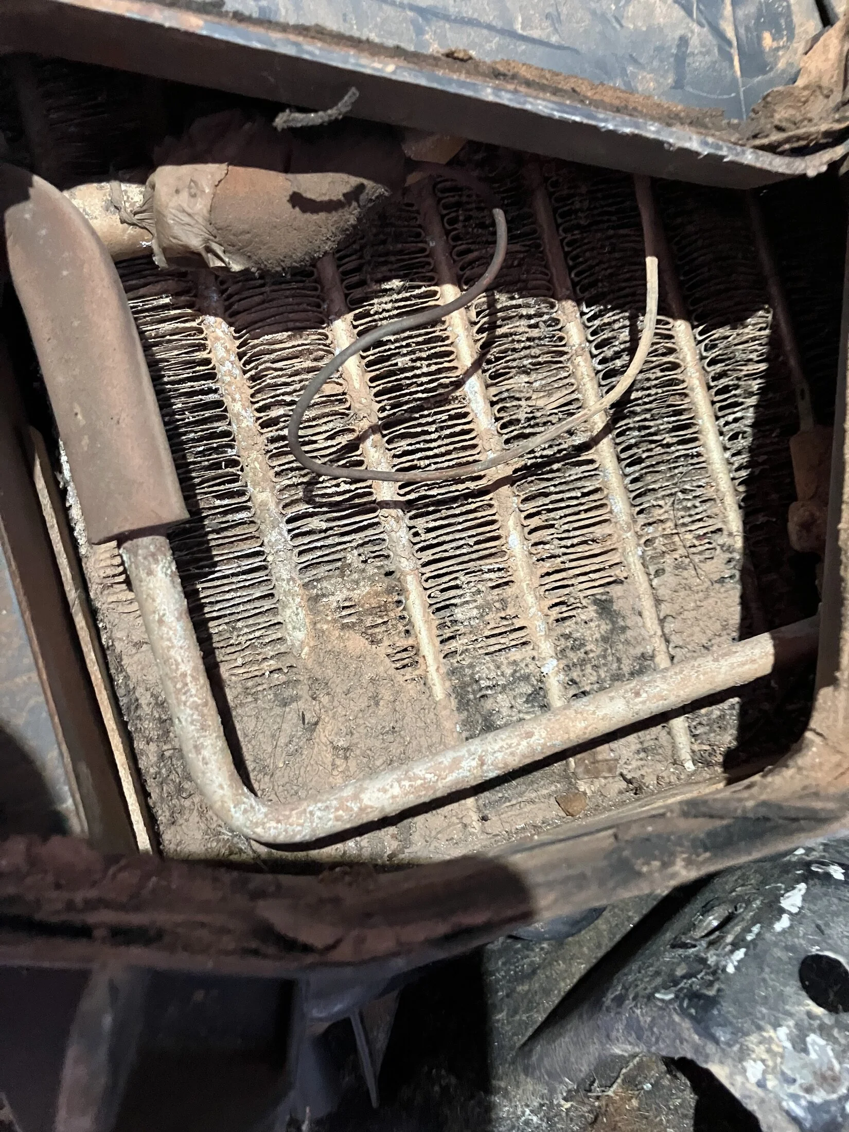

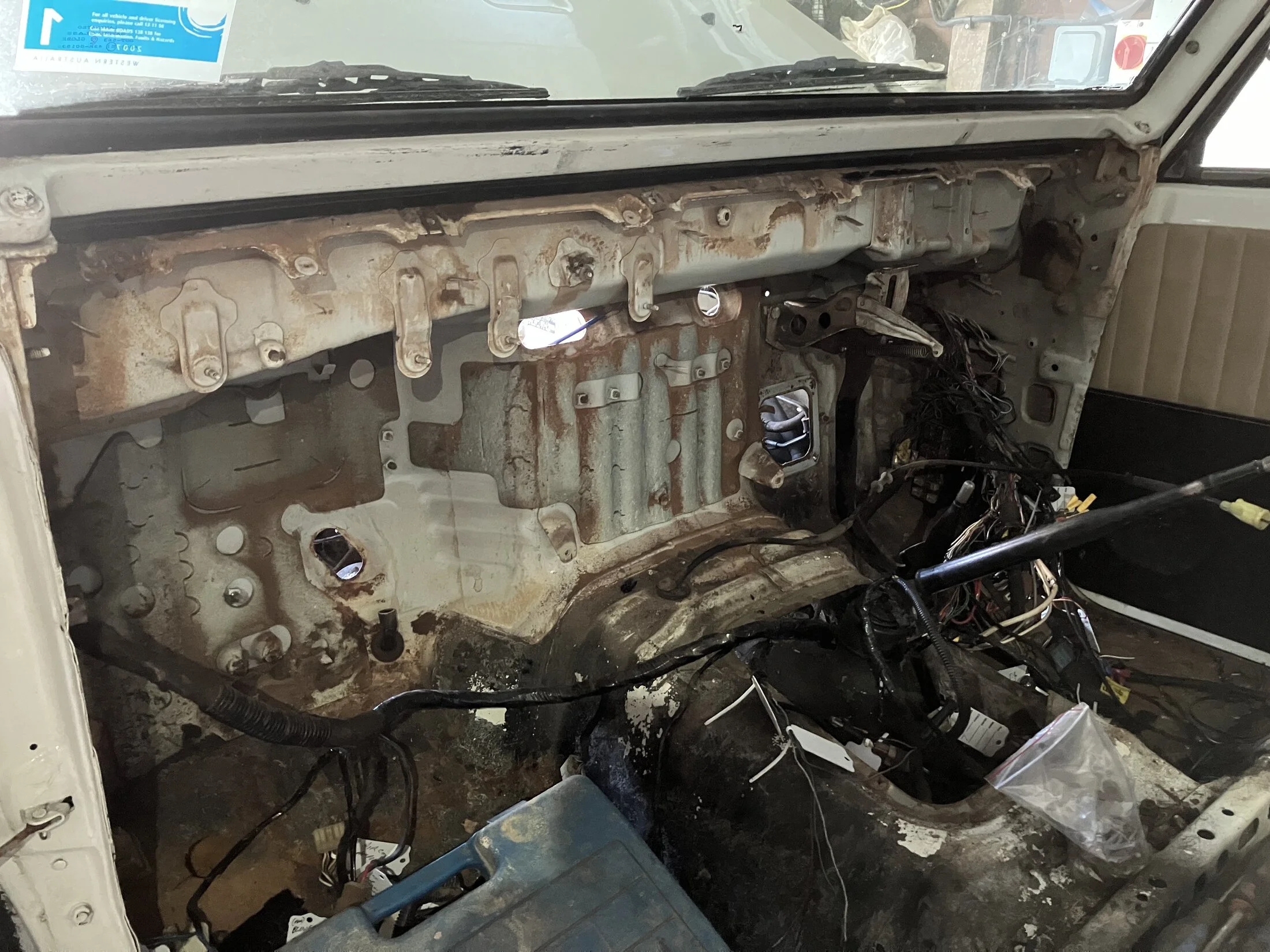

Dash out, and the wiring is horrendous 😵😵.
Removing the air con , absolutely caked with 300,000 of Western Australian mud dust. Seized up air con flaps etc.
Tell me, this model ( hzj75 4.2d 1990) does it have toggle switches for diff lock, approximately where your knees would be if sitting in the drivers seat, only there are two identical ( should have taken photos), and I haven’t a clue what they are for….ideally a dash lay out of switches if any one has.
Thanks.
Thanks.
The factory difflock switch is a rotary electrical switch, like an 80 series.

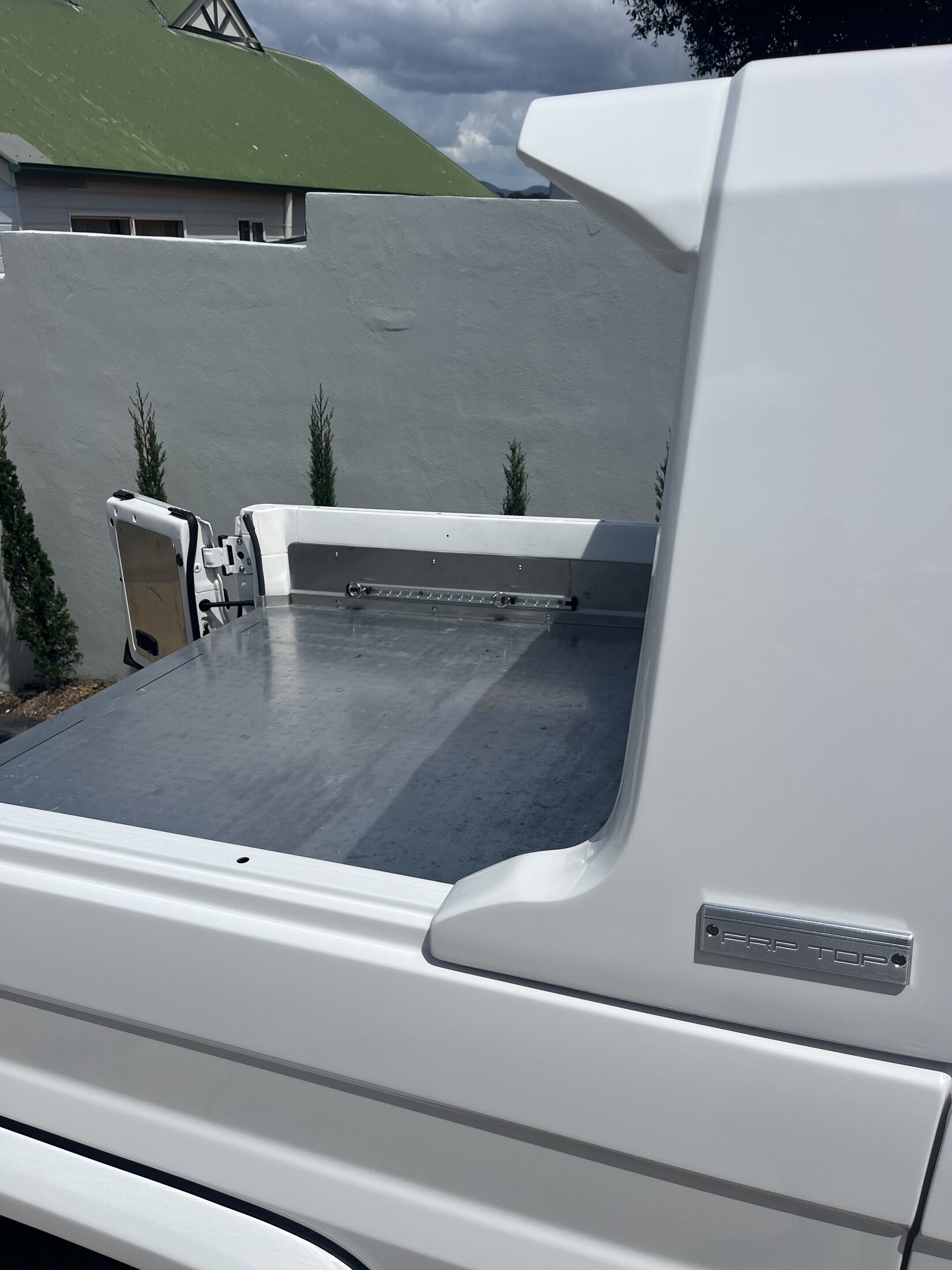

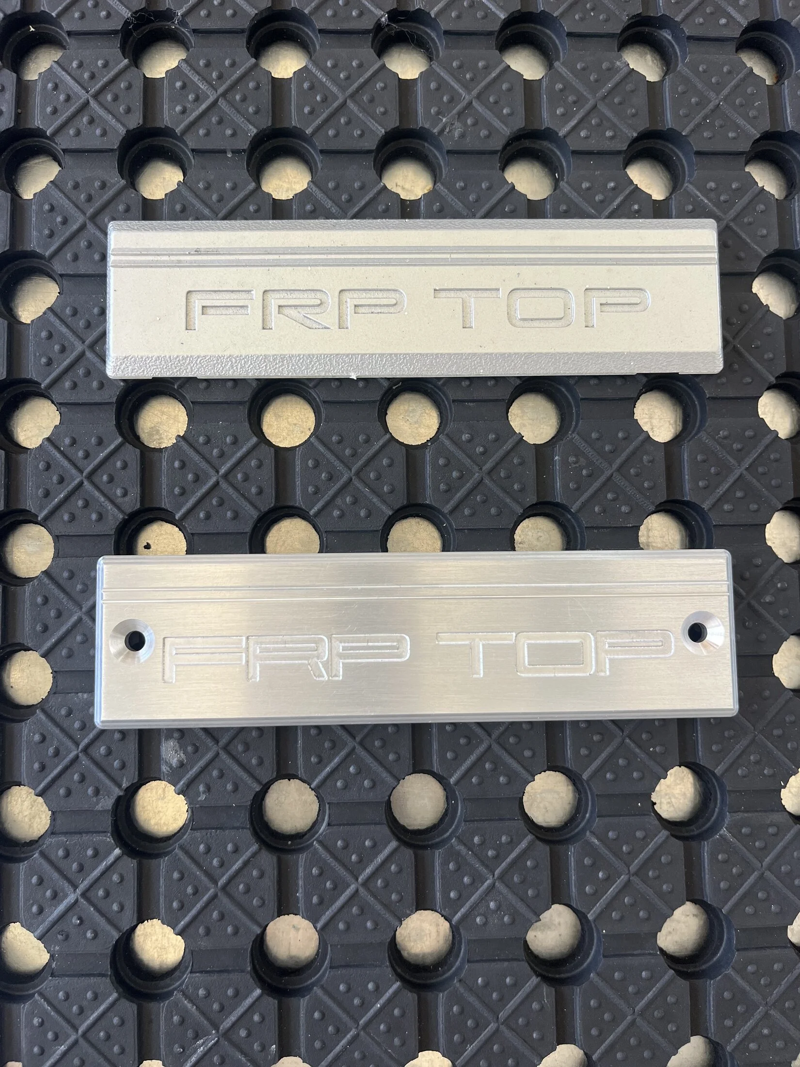

Working on making the FRP badge more practical for quick removal. Every factory badge I have (6) all have broken pins or seized retaining clips.
I had these made out of solid aloominum.
Still a work in progress as I may paint the font and top 2 horizontal lines in either black or the factory blue/grey that a lot of the FRP tops have the “Landcruiser “ logo coloured. Then polish the face to match the chrome handles and leave the sides of the badge brushed.
I’ve clear 2pac’d the badge for now so it won’t go too grey till I have 10minutes to finish them off.
I have nutserts in the FRP top where the retaining clips were. I’m still deciding on what countersunk head fastener to use. I’ll hopefully find a slotted raised/countersunk head metal thread. Takes no time to undo the badges and reveal the top fixings and no risk of damaging the badge or the paint work behind the badge.

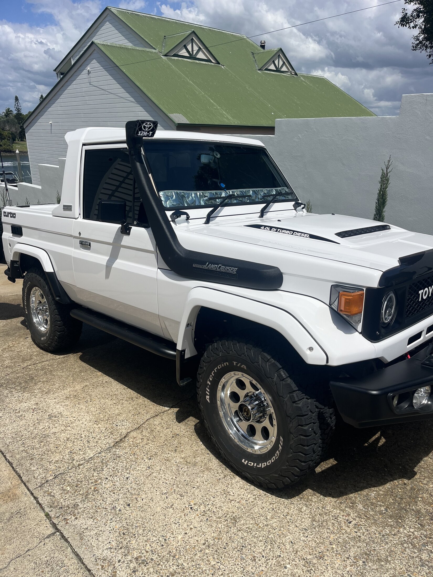

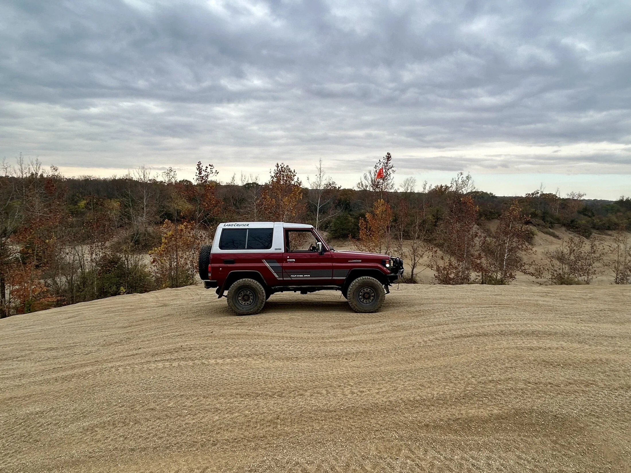

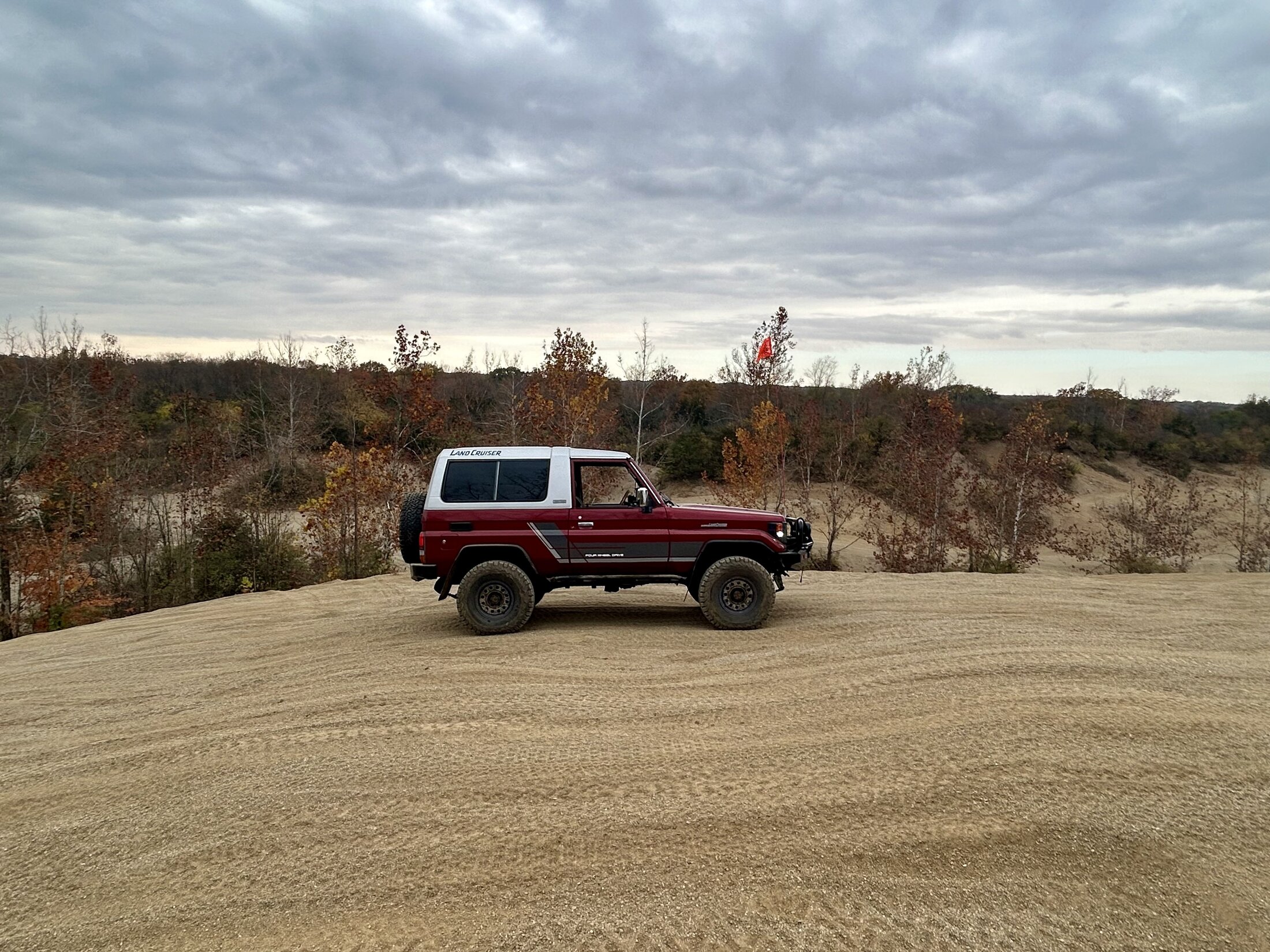

This remains my all-time favorite interpretation of a mid wheelbase 7x.
I need to find a spare FRP top for mine.
Wow. Thanks, that means a lot coming from you 👍🏼. Hope you noticed I stuck those pesky rear door seals down till I get around to capping them 😉
I did indeed. It's about damn time. :doh:
