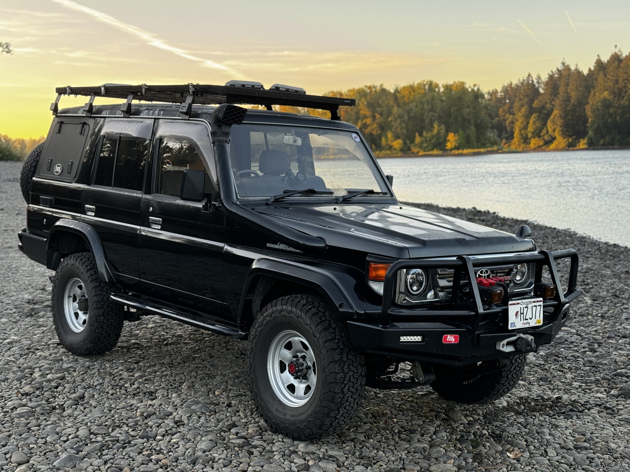

TorFab installed the Sumo 10% underdrive and 3.1:1 low gears last week for me. Love the feels so far. Need to pull my little trailer over the pass still. Did test 4lo this morning at my other favorite bar.
Dude your rig is looking very sorted! Wow!
That picture makes me reconsider the 16x7 steelies that you have.

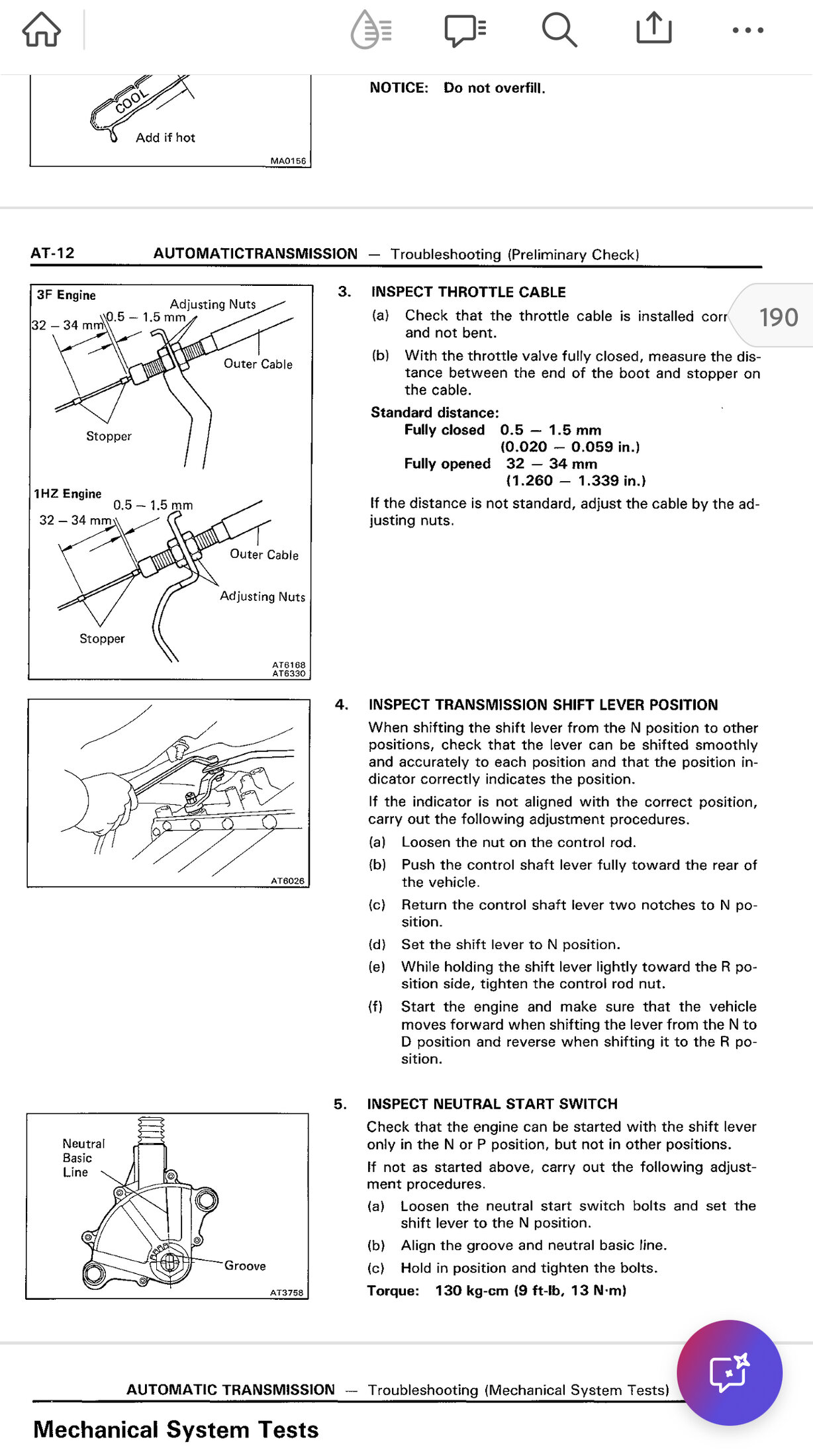

I finally replaced my rear mount last night. I went for a drive today and my indicator on my shift lever no longer aligns with the different gear labels. I’m assuming there’s a cable that needs to be adjusted?
