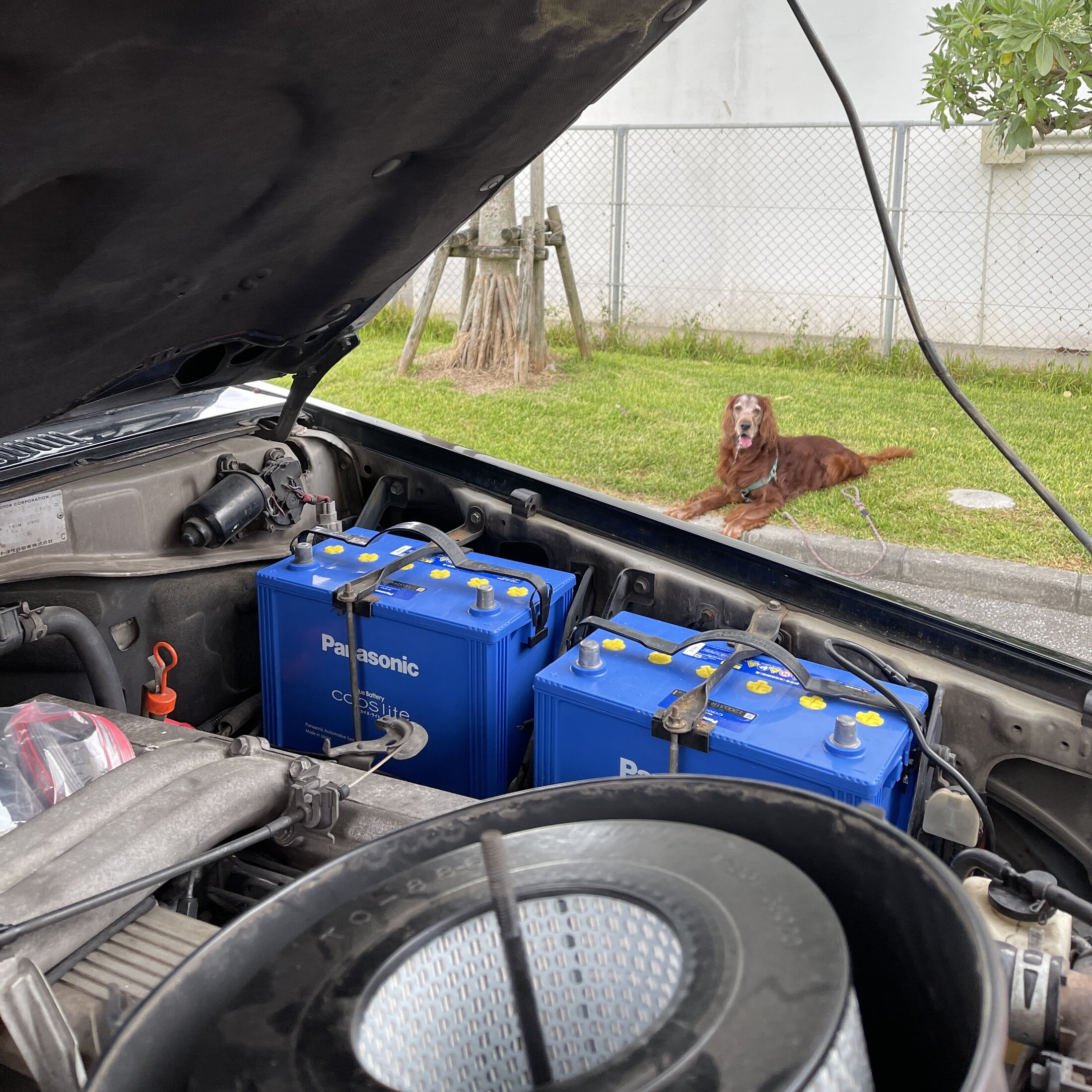

My best friend (pictured) and I upgraded the batteries, rewired the cables, improved the terminals and lugs, replaced the alternator with a new OEM one, and replaced the alternator belts and the a/c belt. Successful day!

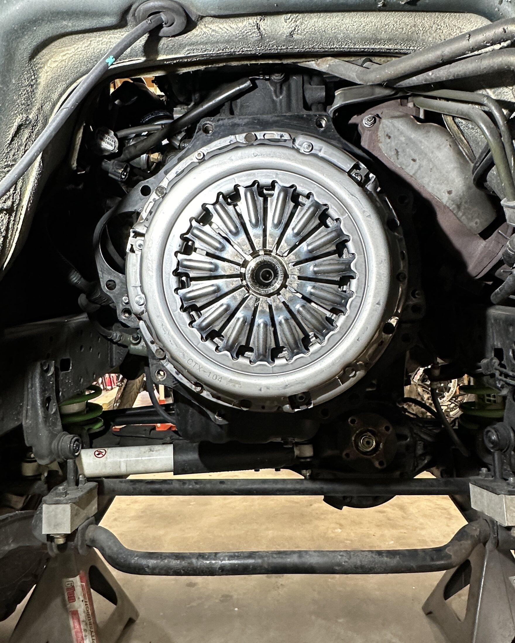

Removed the transmission to replace the clutch on my ‘94 KZJ78.
While I had it out I decided to tackle my weeping front and rear output seals to find that the rear shaft had a bit of vertical movement. Rebuild kit in bound for that. But in the mean time, both companion flanges have scarring from the seals. The front (3330960051) looks to be NLA.
Could a rear flange (3330960060) be utilized with swapping the dust cover?
They measure out the same with the my calipers.
