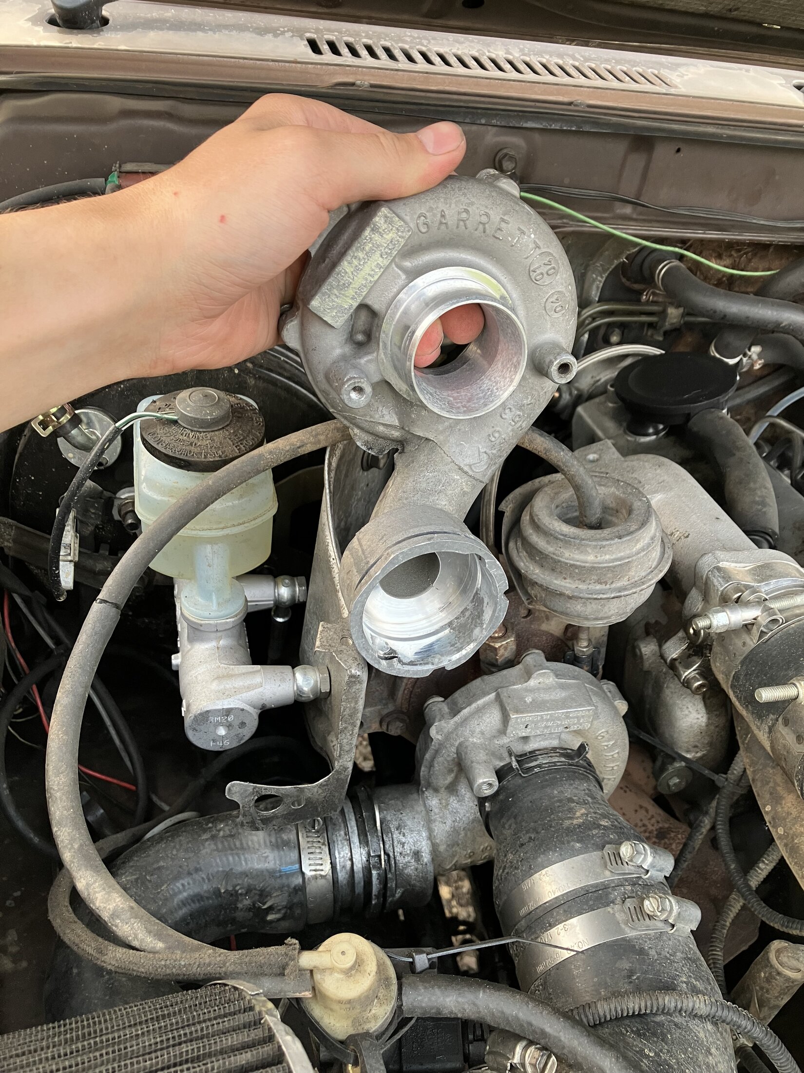

Got a new turbo compressor housing that should be a direct swap on my turbo. The 90° outlet will simplify charge air pipe routing and free up space to build an airbox.
