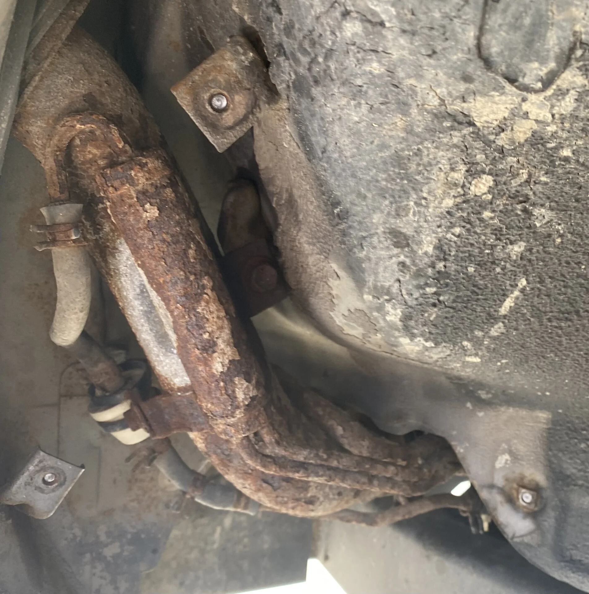

…thankfully I’ve already replaced ALL the rest of the fuel lines, and can get most of the parts
…any idea how to get the broken M6 thread bolt bits out? Just drill’em?
After this no excuse for an air leak short of a bullet hole!
I just drill them out and retap the threads. If you are careful, patient and somewhat lucky you can reuse the captive nut, otherwise you have to get creative on securement options once you remediate the filler hose and connections.
I would recommend if you drop the tank, take the time to replace the pickup as well. I would also do the fuel sender/float, but that can be accessed when the tank is installed.
...I think I'll be dropping the tank to deal to this...

The filler neck is not connected to the fuel lines at all. It may leak, but if you experience air in your lines, it must get in elsewhere.
Dropping the fuel tank is neither required nor actually helpful to replace the filler neck.
It might be a good idea, though,: If the filler neck looks like this, the fuel pickup assembly, located on top of the tank, might look similar.
Those are notorious for rusting and those CAN be a leak in your fuel line.
Removing the tank might need some persuasion. Don't be suprised if it wouldn't move at all after having the brackets removed. It tends to glue itself to the floor.

I did this around a year ago and found that the ff rubber tube was NOLA. I bought a long piece of fuel appropriate hose on Amazon of the right diameter and strategically cut it to echo the OEM bends. It has worked fine since!
If you do drop the tank to do the pickup (that's where mine was getting air from) a pair of ratchet straps is helpful to get it back in place since all your buddies will be "busy" the day you go to put it back. 😉
