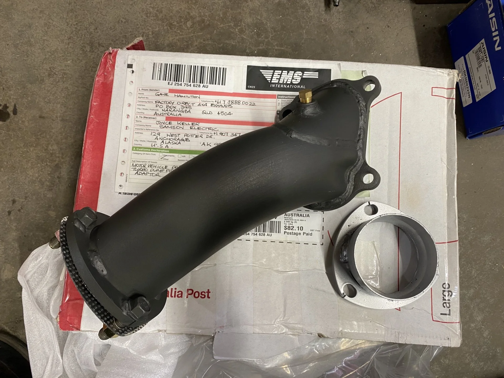

exhaust supplied by Tonka?
I kinda hate that thing... bought the cruiser with it on it. I gotta get somebody to weld me up some exhaust that goes all the way to the back.
i mean, it looks pretty cool, it really does, but, yeah. not practical at all.
Haha thanks. It flows well at least. Its one of the many things on my list to fix/rework

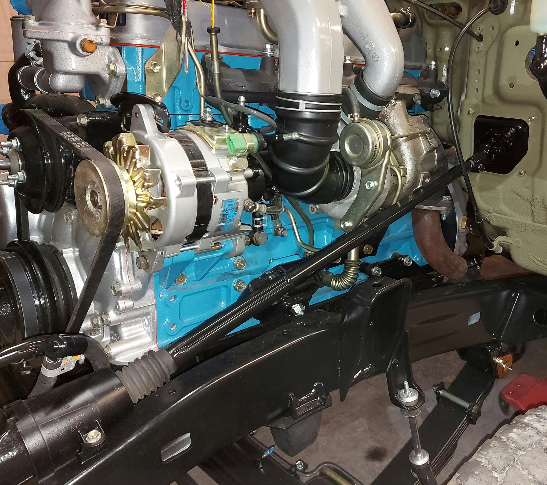

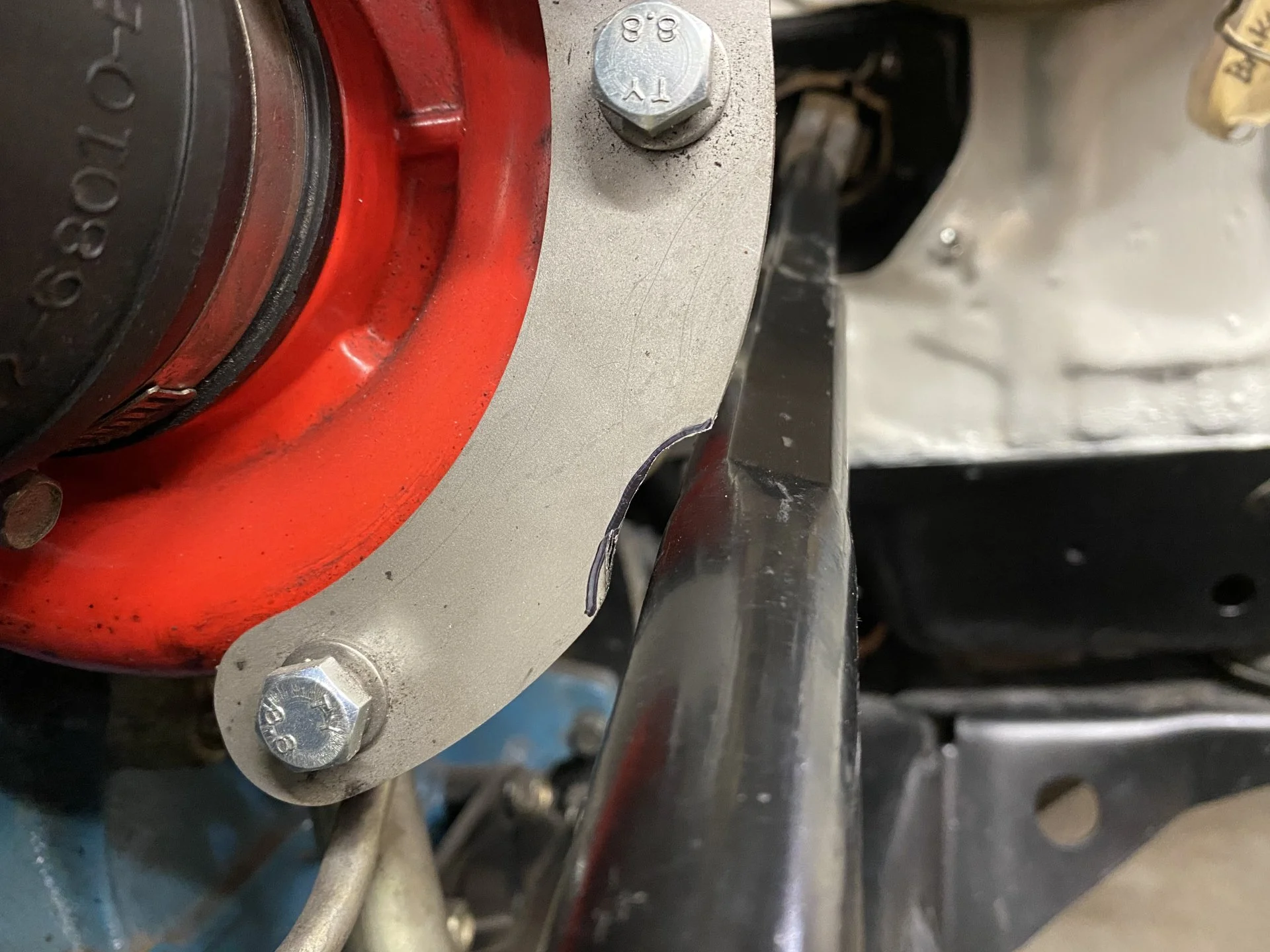

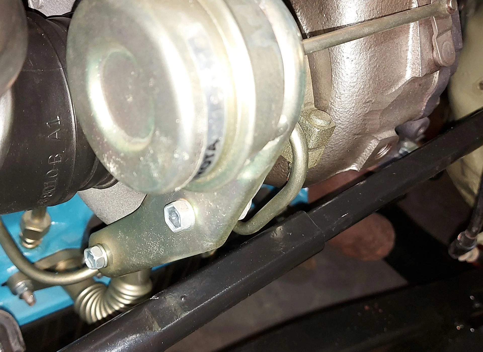

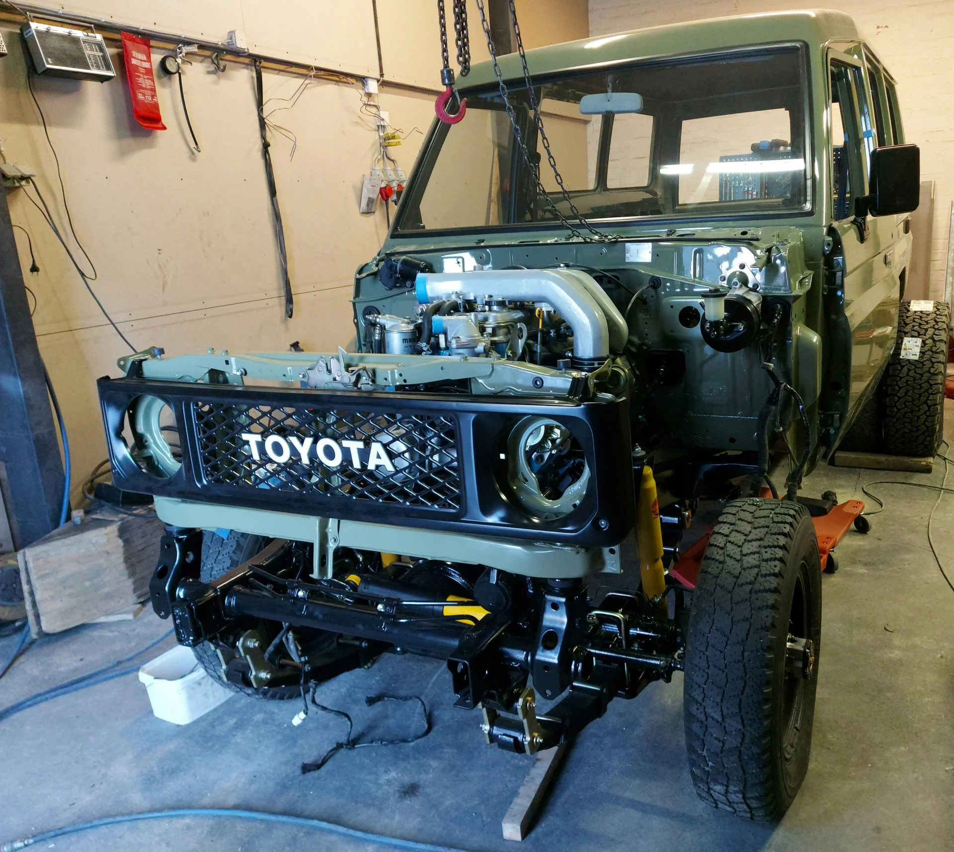

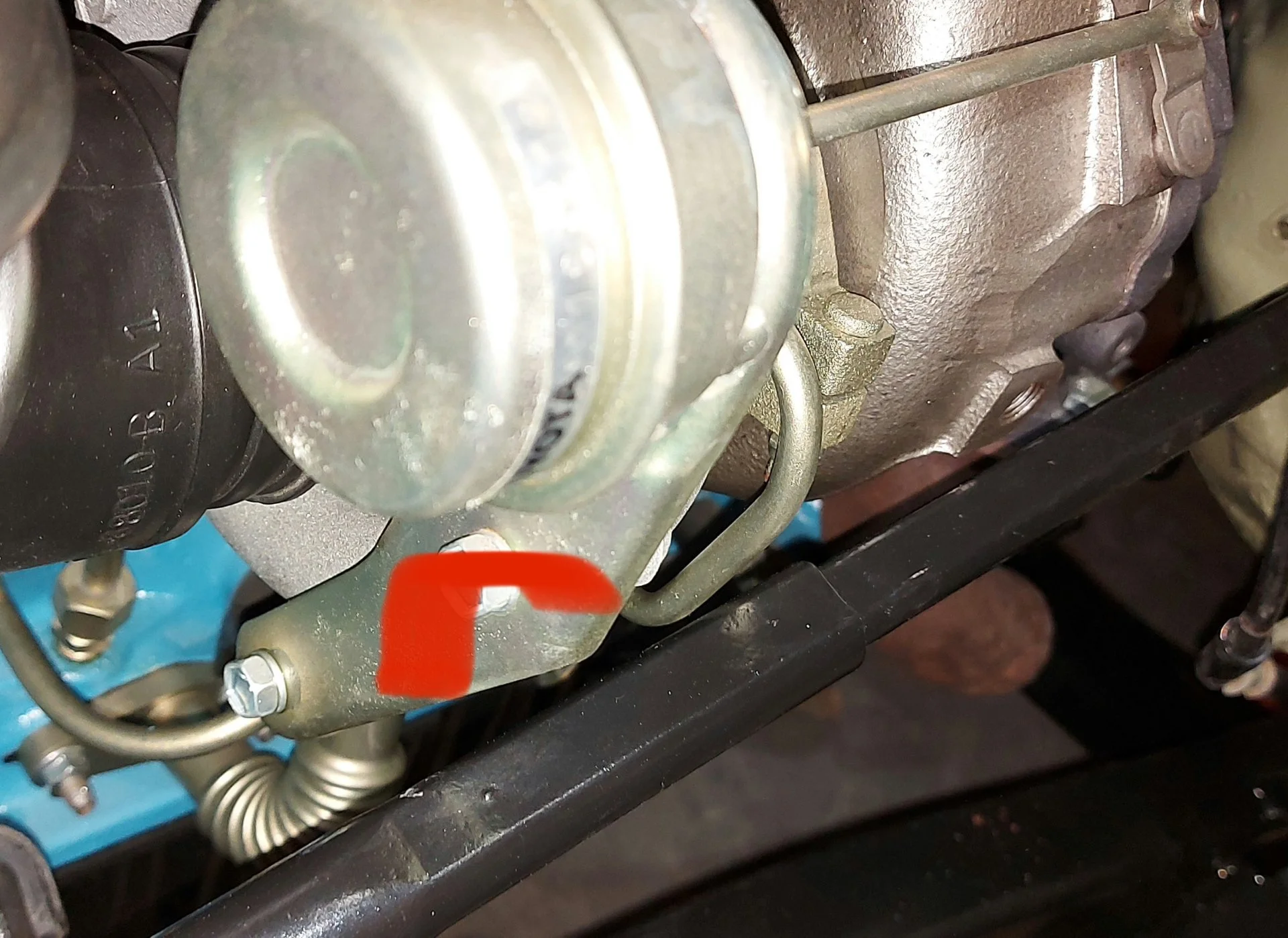

The 12H-T is in it's place finally. 5 mm gap between turbo and steering shaft is enough, I hope..
I had to clearance a little bit on mine here were marked, so far haven’t noticed any contact.
In this case, the worst issue if any, is water cooling line clearance. If necessary, I will bend it a little. In my experience the 12H-T doesn’t swing much, especially with the new engine mounts.

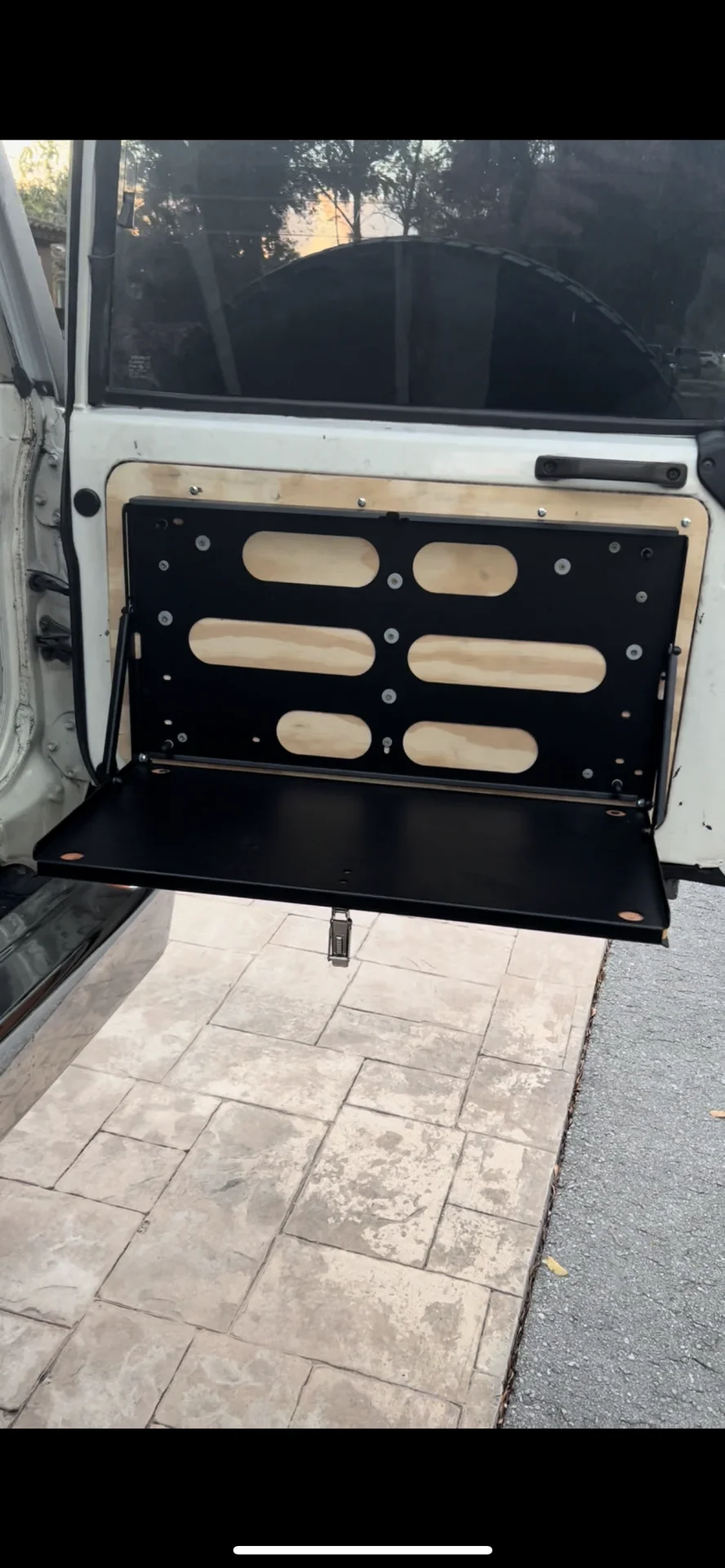

Apparently Quick Pitch is starting to make a version of these specifically for 70s with a recess for storage.
I’ve seen a couple Australian companies make some that bolt straight to the door but wanted something I could purchase here in the states, bolted it straight to a 1/4 plywood and it’s safe to say that table isn’t going anywhere
