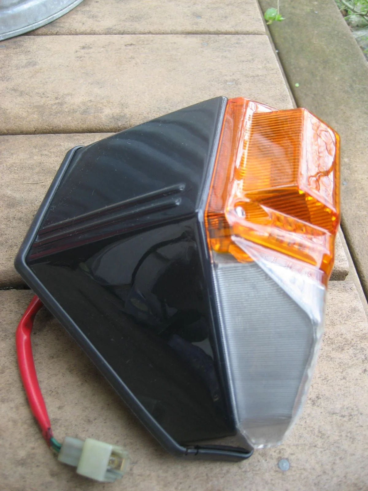

I treated the front indicator light housings with the Cerakote Trim wipes. That stuff made the black plastic shine. Hopefully it will last as advertised.

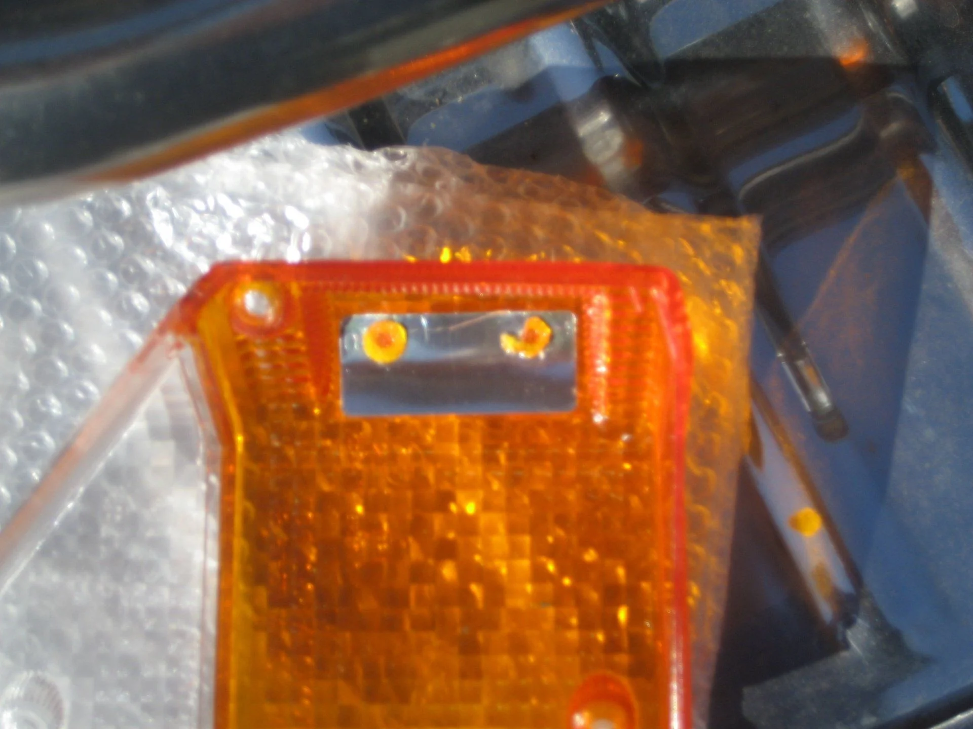

I used a heated steel rod to melt/mash the "shades" to the amber part of the lenses. The factory clearly had just the right temp for the melting action. After the melting I added a drop of gap filling cyanoacrylate glue. I put the led bulbs from Odd Iron in and reattached the pods to the truck.
Image of the shiny plastic reflection.

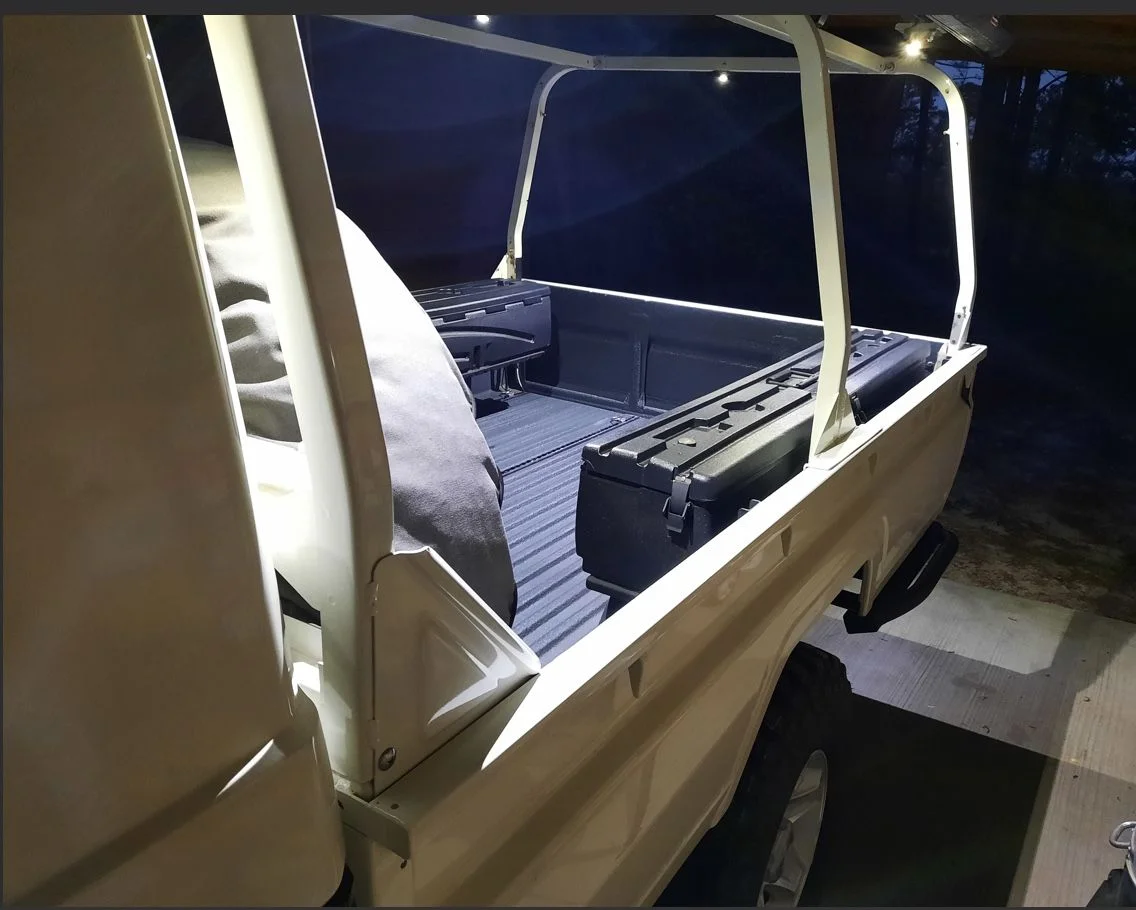

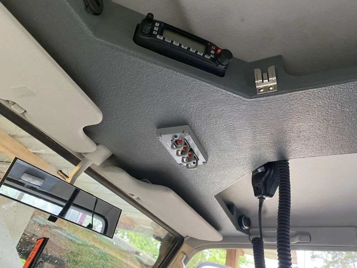

Had a control panel installed to manage the LED lights in the rear bed as well as the awning lights when it’s deployed.

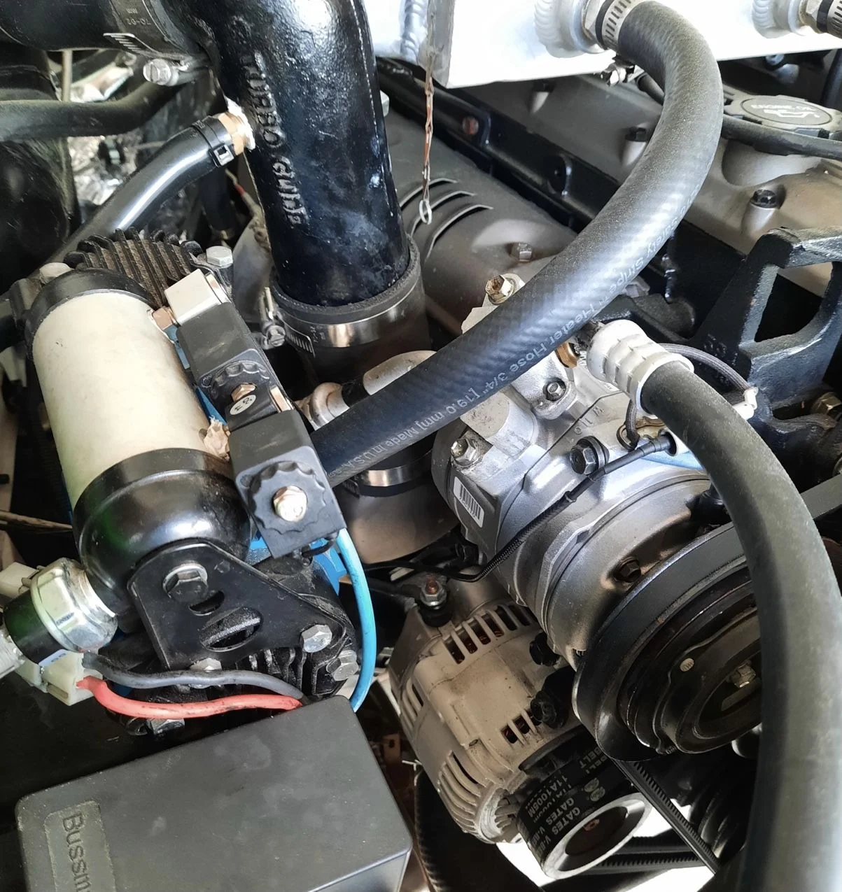

The original builder of my truck had installed the rear locker incorrectly which caused oil blowback into the ARB compressor. The compressor and engine bay looked like the second grounding of the Exxon Valdez. After the rear locker was repaired it was time for a new compressor so now the ARB compressor, the a/c compressor and the alternator are all new. 😊

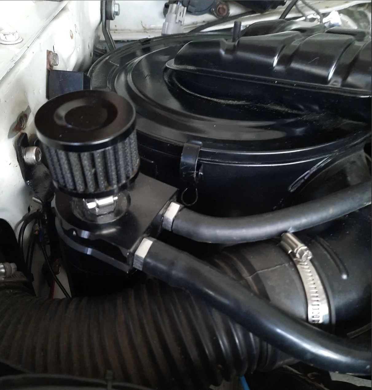

Spare room is starting to get scarce so the catch can had to be moved. (Photos courtesy of Odd Iron Off Road). 😊
Man, get those janky Gates belts outta there and get the correct 90916-02452 belt set.
To be clear my aftermarket alternator (Terrain Tamer) needs an OEM Toyota belt? 😁
