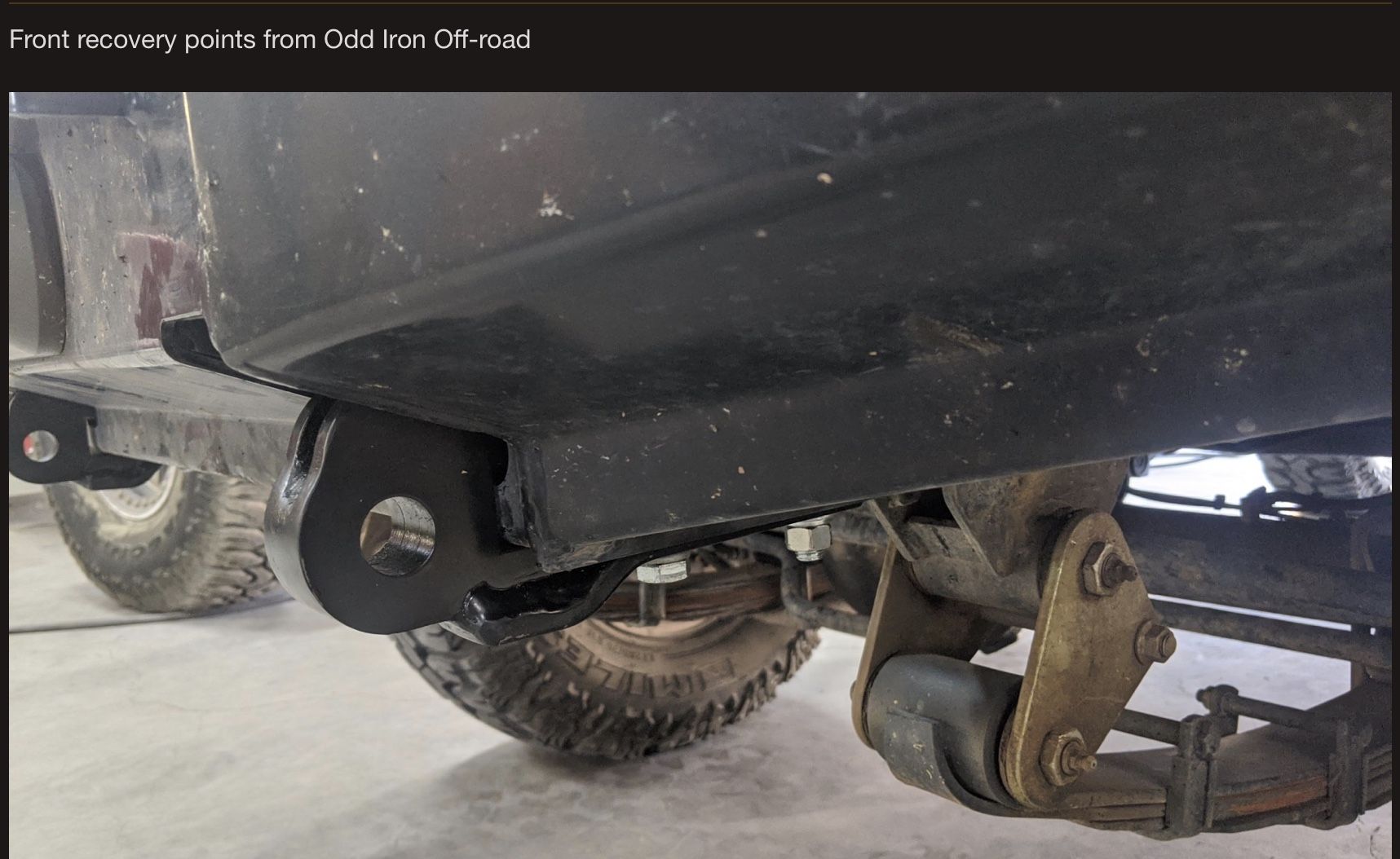

Removed my front porch bumper today and prepped the frame nubs for the ARB install... or so I thought. My frame is ~1mm or less too wide for the bumper to fit. Kept scratching off paint when I would try, which was infuriating as I would sand, repaint, wait, and scratch it again. I was able to get both sides on, but not without scratching the paint (rubberized undercoating- thick and maybe not the best choice)
Searched old mud posts... mainly from 80 series owners who are able to use HD ratcheting tie downs on their frames and/or stretch the bumper to make the mounts work.
On a 70 series, the frame nubs aren't as long and there are circular reinforcing bars going crosswise on both the bumper and chassis, so I'm not sure I would be able to have a wide strap and the bumper on the frame at the same time.
I was going to use a sander to plane a few hairs off the outside of the RH frame wall. There's more material behind there than on the LH side for some reason. Also going to take all paint off and POR 15 the nubs so as to have a hard coating after.
Thoughts?

My ARB was pretty difficult to get on- it wanted to be perfectly lined up with the frame, and still required some good love taps with 5 lb sledge and wood block. I'm sure it removed the thin factory paint. I coated the frame and inside of the bumper receiving tubes with fluid film prior to fitting. I can easily see you scraping off any thick undercoating used on your frame with the installation.

If it's not to much to grind it down then a large angle grinder can probably make quick work of it. A thin protective coating of primer/paint with a coat of ez-slide sprayed over it when it's dry will probably help your bumper slide on easily. EZ slide is available on amazon or at tractor supply EZ-Slide Graphite Based Coating, 12 oz. Aerosol at Tractor Supply Co.
If you're really concerned about rust inside your assembled bumper then let it rust a bit then spray with rust converter followed by a thin penetrating oil based spray on rust protective undercoating that will seap into cracks and not just lay on the surface.
