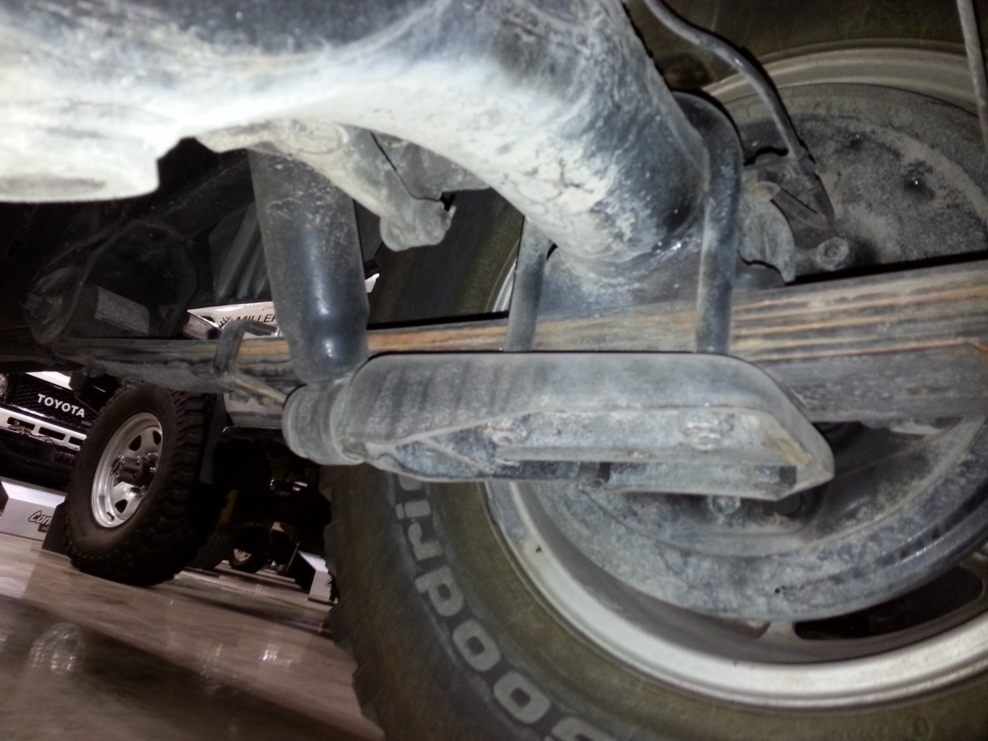

The right side mounts in front of the axle housing. This shot is not the best but you can see how far forward it is shifted.

Toyota heavily reinforced it as i would assume. I don't think i could just extend the pin. I would have to build a longer plate...
but maybe not. Like I said about building a different plate, I'd have to machine 50 at a time. I was kinda hoping to retire sometime next year.
What is that offset from the u-bolt? 2"? 2 1/2"?.
