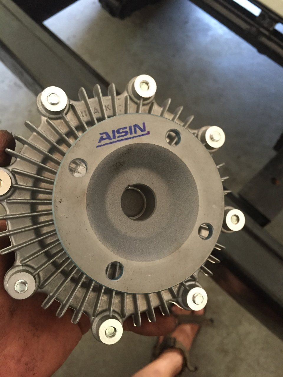

Then new fan clutch for my truck and my client's truck.
These are the Aisin FCT-001. They are the correct fit for the fan, but the base is too small for the 8mm studs on the water pump. They will be drilled out tomorrow.![]()

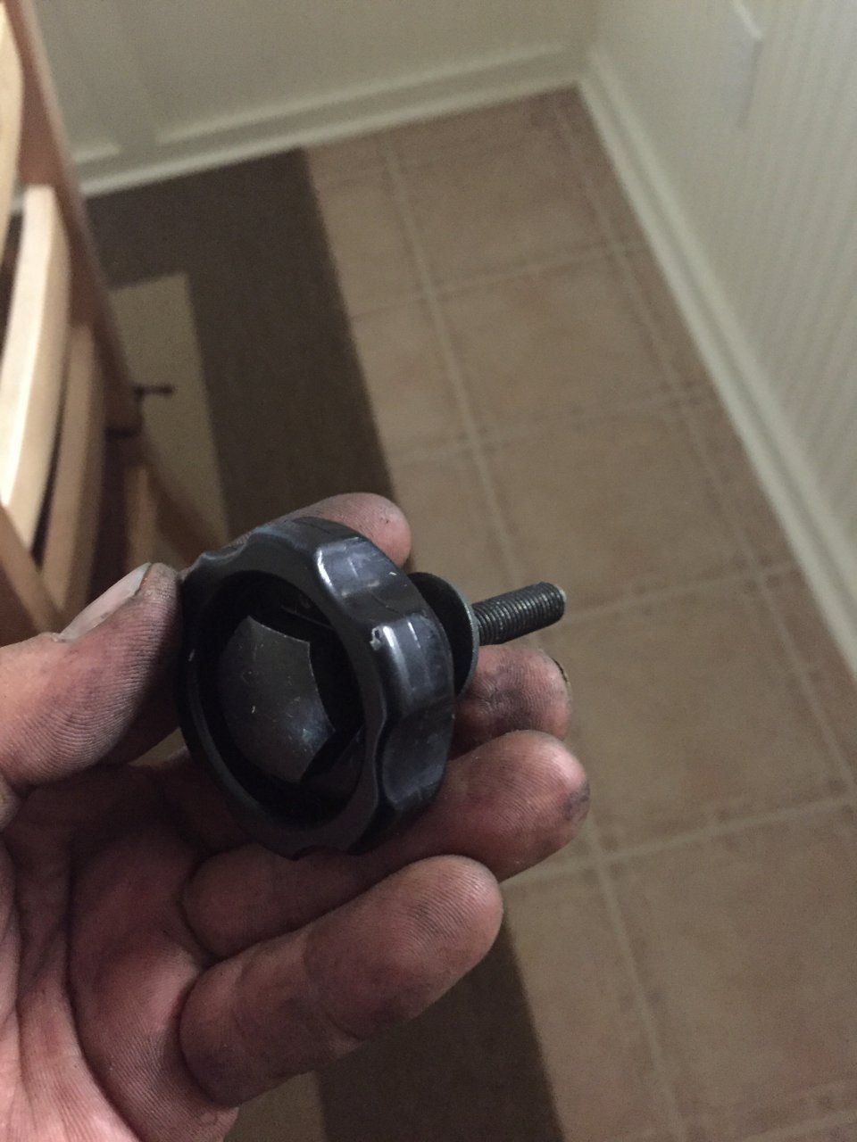

Would these mirrors work on a LHD BJ70? I'd love to replace the small mirrors that I have on my 1985 model.While I was at it I installed new OEM mirrors as well.
These are from a later 7x series but they are a direct fit. Most of the old 1980's mirrors rattle and shake and I didn't want any of that.
Part numbers:
Difference between the two is that the later ones are not "breakaway" style. They are purely manual adjusting.
The gasket is slightly different and you can see the difference here:
But in all honesty it is a great upgrade over the old OEM iterations which are no longer available here or in Japan.
