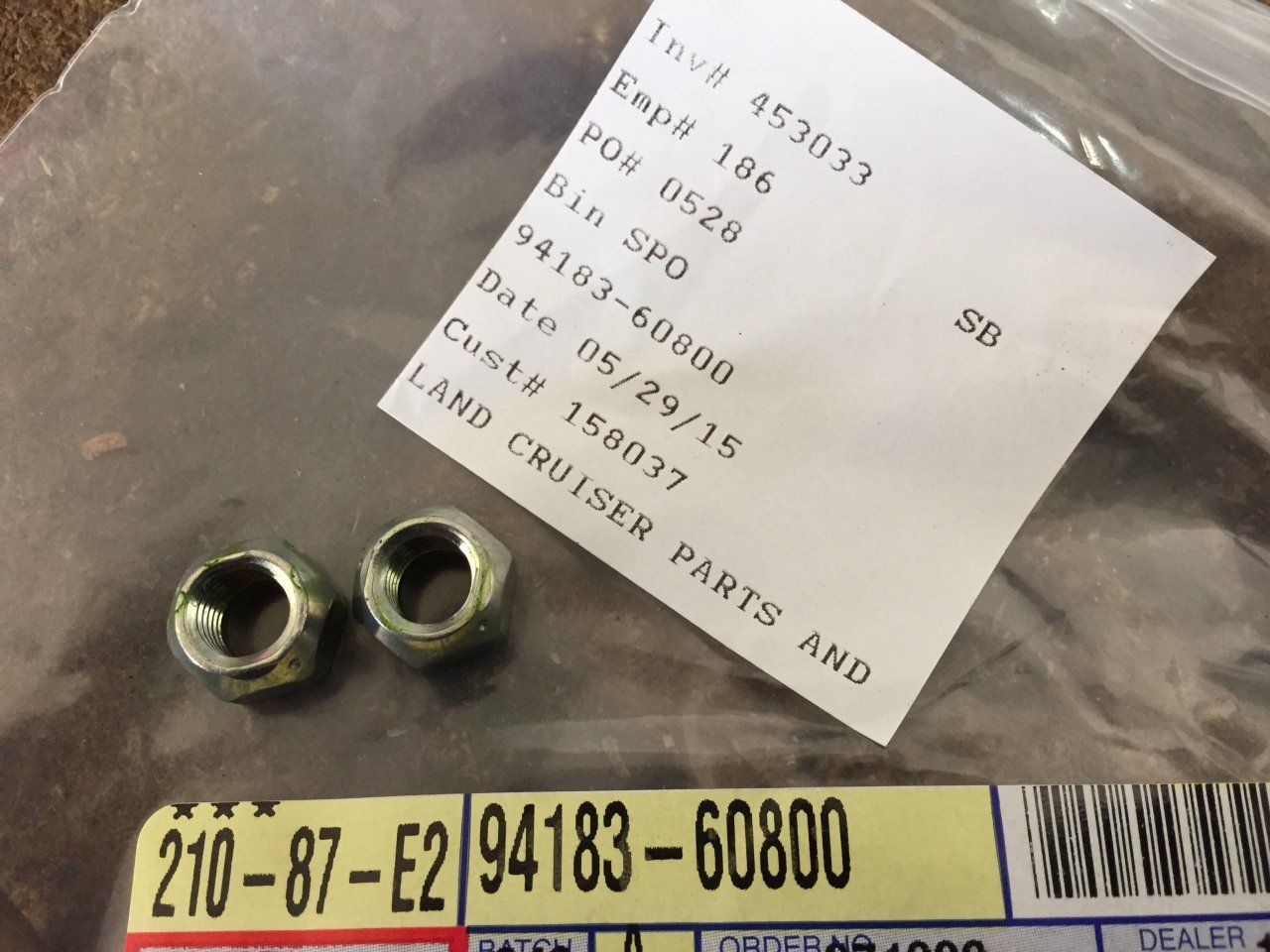

New correct OEM lug nuts today.
Available in the US:

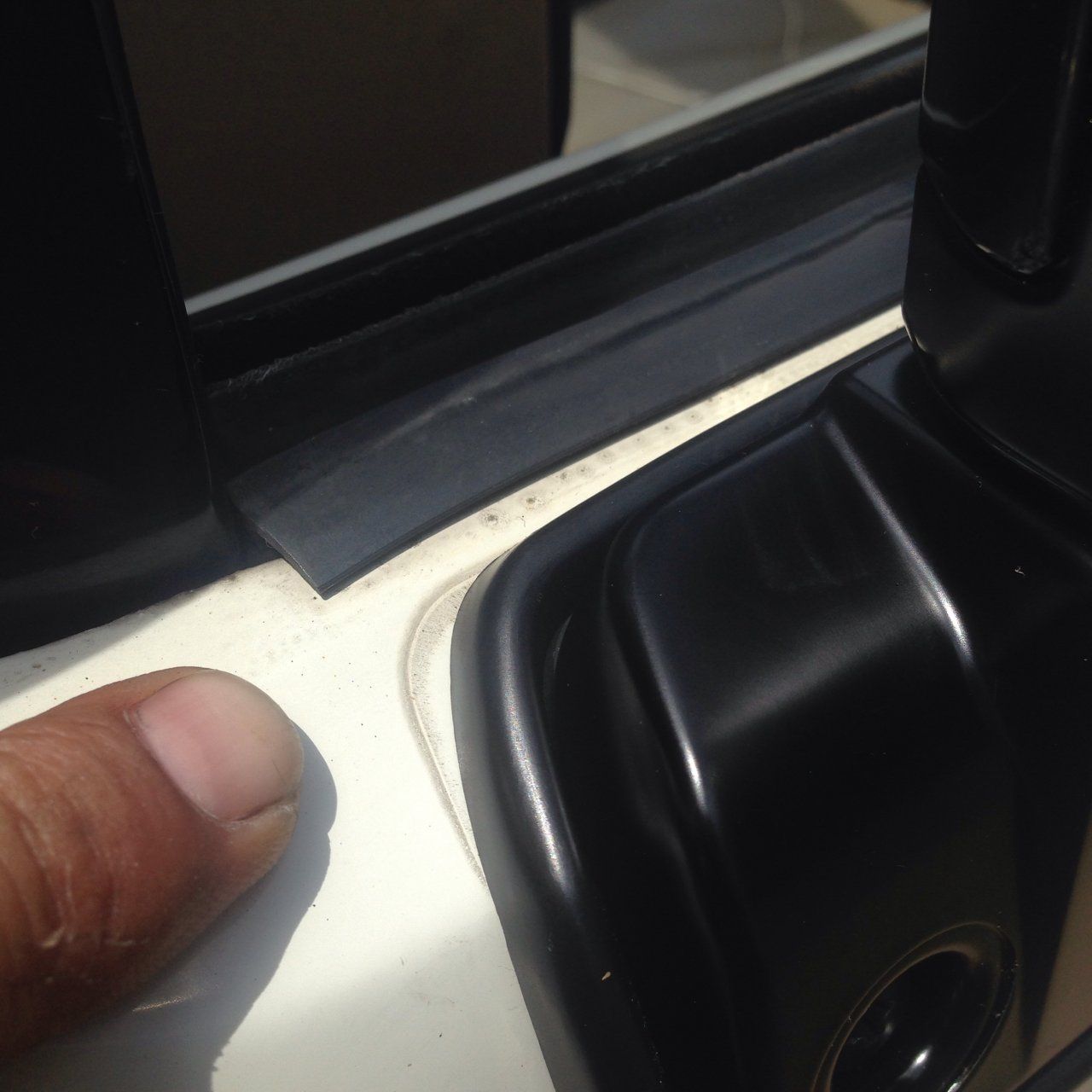

Difference between the two is that the later ones are not "breakaway" style. They are purely manual adjusting.
The gasket is slightly different and you can see the difference here:

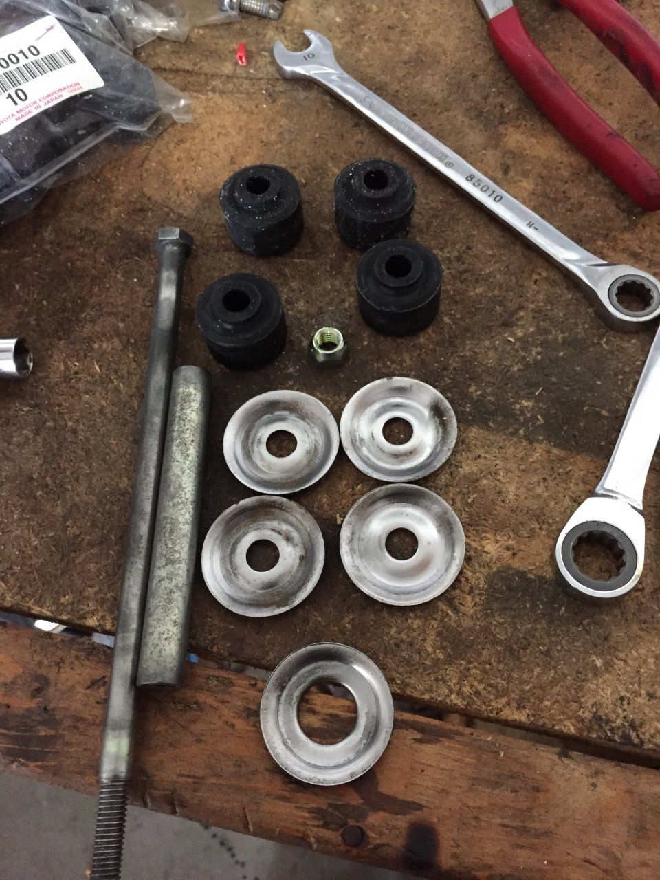

New front sway bar bushings. Very worth the effort.

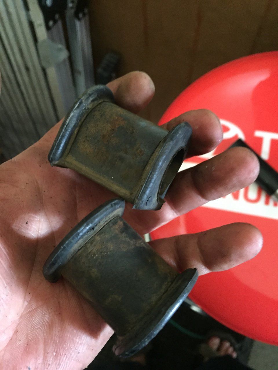

Out with the old crap. Bushings were torn, hard and not doing what they need to do: cushion and support.

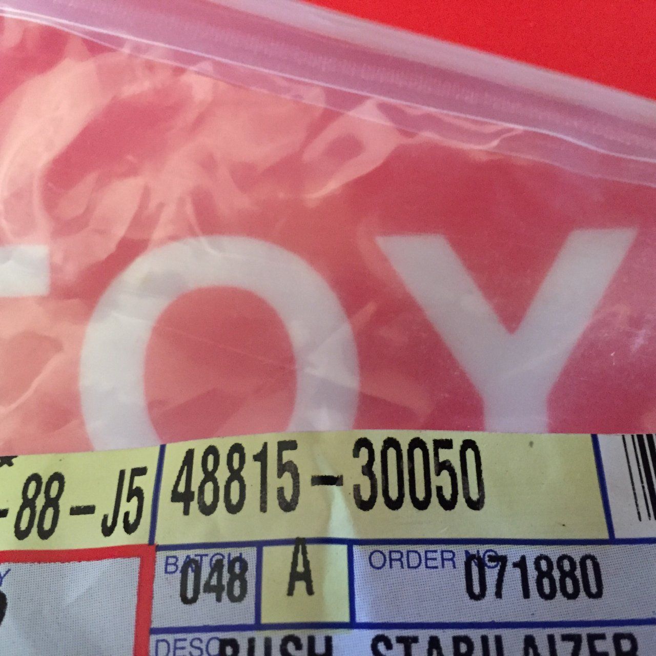

In with the new stuff. I reused the main bolt, retainers and the sleeve. Bushings and top lock nut were procured new. Available in U.S. market. Basically 60/62 stuff.
D-style bushings:
Shaft bushings:
Lock nut:
Al of the parts nice and clean.
Awesome Beno! Those cushions/bushings are on my List also.
Will I need longer bolts since PO added a 2" lift?
