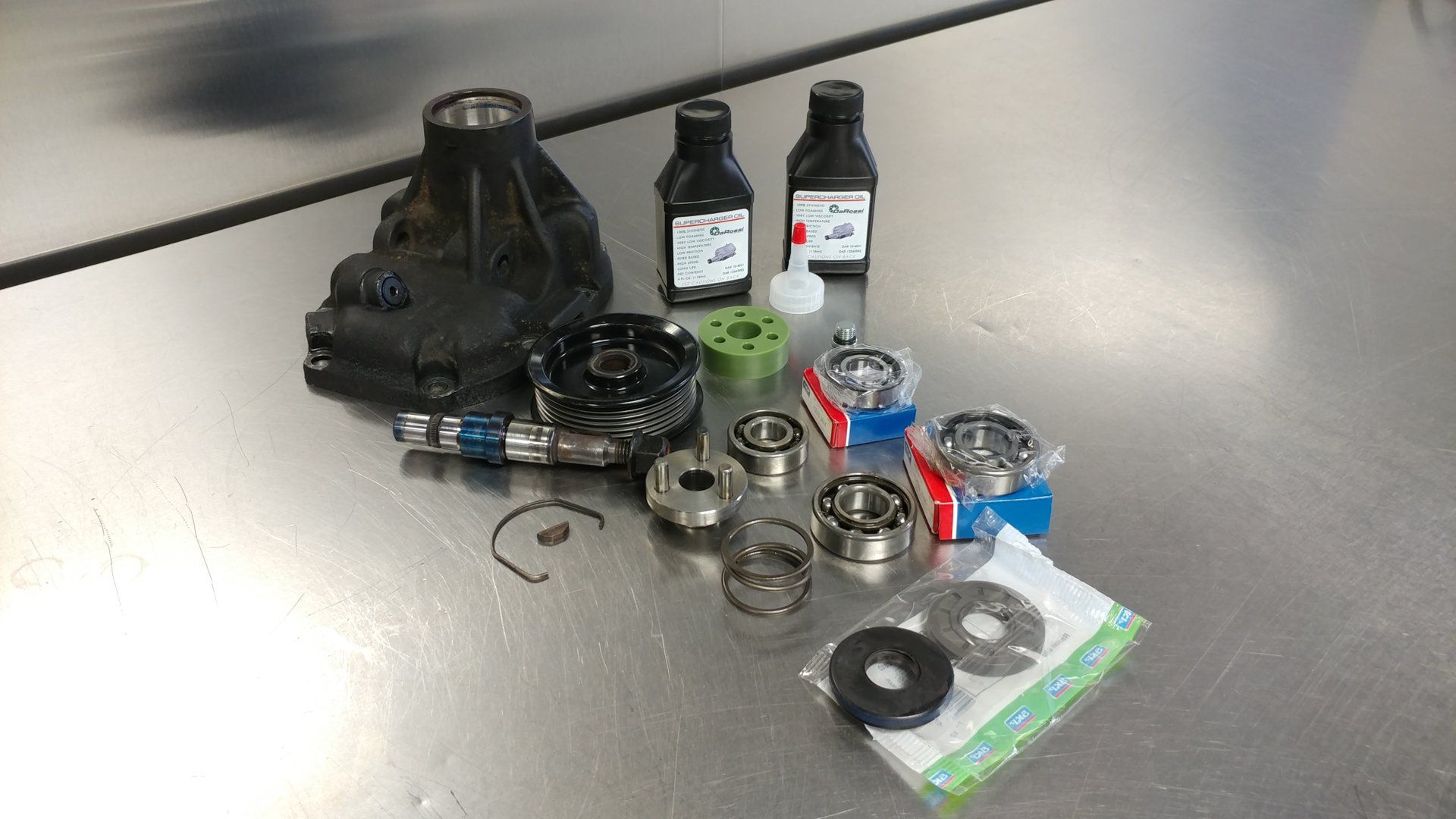

Supercharger snout rebuild and a fan clutch upgrade happening......in hindsight, I should have moved the motor back about 3-4" so it wasn't necessary to disassemble it this far to service things. It's like I was trying to build a German car or something.
In all actuality, I kind of added the supercharger last minute.....we were far too committed at this point to move things around so we just went with it. The more you know.

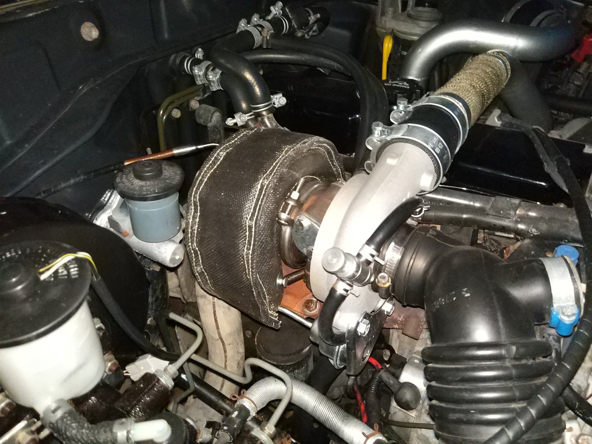

Installed an ebay turbo blanket on my CT-20. It fits and works really well; I can easily hold my hand on it after a hard drive. Now I feel much better with my clutch cylinder being so close lol, although I never had any issues either with just the factory turbo heat shield.
If that one ends up burning up and deteriorating. I have a couple good t3/t4 sizes that I was playing with when I had my rx-7.
Good to know, thanks! Although I've done some research and it seems like they mostly fail on petrol engines since they run much hotter. Well, I just hope it'll hold up :D

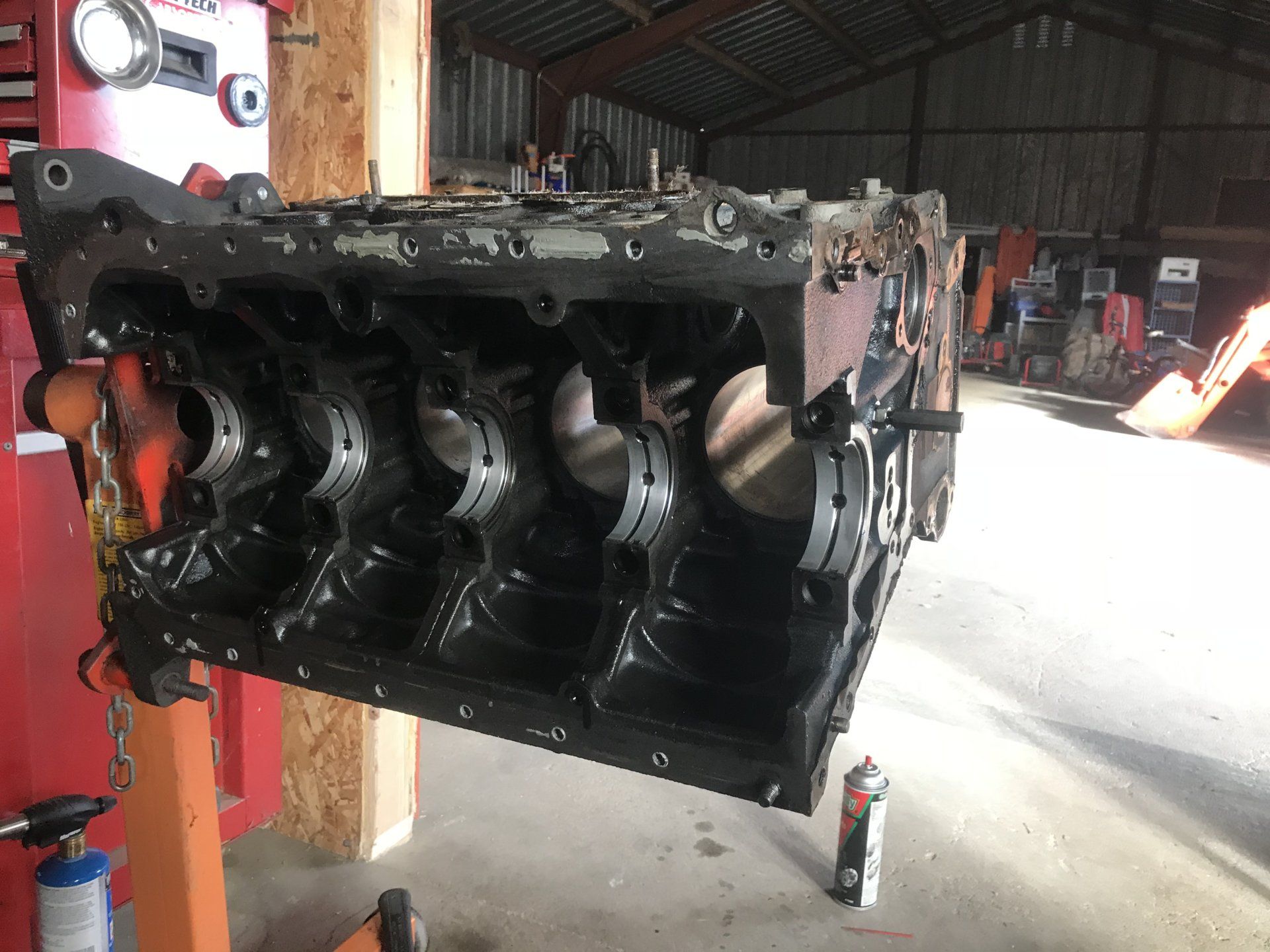

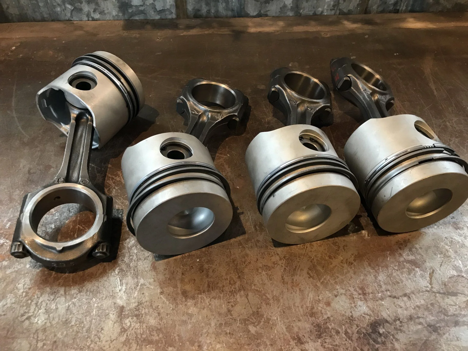

Block off to the machine shop for the following: csleeves pushed out and new ones in, block cleaned, crank will be polished, cam off to be reground if needed, new cam bearings, flywheel machined, everything measured to make sure in spec.
Just looking at crank and cam the guy said they looked pretty good. Just minor polish on crank. Pretty impressive for 485km. Would have went further if not for the blown hose that caused the headgasket to go.
I was thinking about this the other day because I went and dig up my ptp blankets because I was gonna throw it on my turbo. But then it didn’t make sense to do so. I used the blankets on my rx-7 to keep my turbo hot and more responsive. I’m not sure if the benefits of the blanket outweigh the possible negatives like cracking your manifold due to high heat and always having a high EGT along with having to wait a couple more minutes to allow the turbo to cool down since the heat is being retained.
If you do have a pre turbo EGT probe would you mind sharing what your temps are before and after the blanket.
But then again my turbo knowledge is limited and I only know what I learned from my mechanic and tuner for my rx-7.
